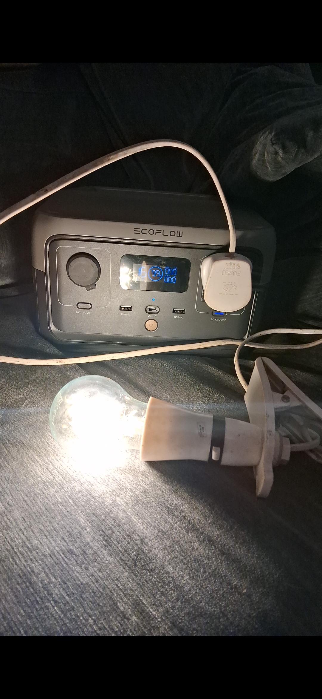

If budget eventually enables you to look at the smaller ecoflow / jackery units I've a river 2 (now superseded by the river 3... it's 256wh capacity 300w inverter 2xusb a one usbc and a 12v outlet and weighs bugger all 3.5kg according to Google
It'll run our tv for 5hrs
A standard Led lamp this one is 3.5w for 16 hrs
Solar charge from a 100w panel (additional mc4 to xt60 cable needed )
Can mains charge from flat in about 1 hour
Or car charge takes about 2.5 hours from memory
Got this for £166 last summer in the Argos sale
