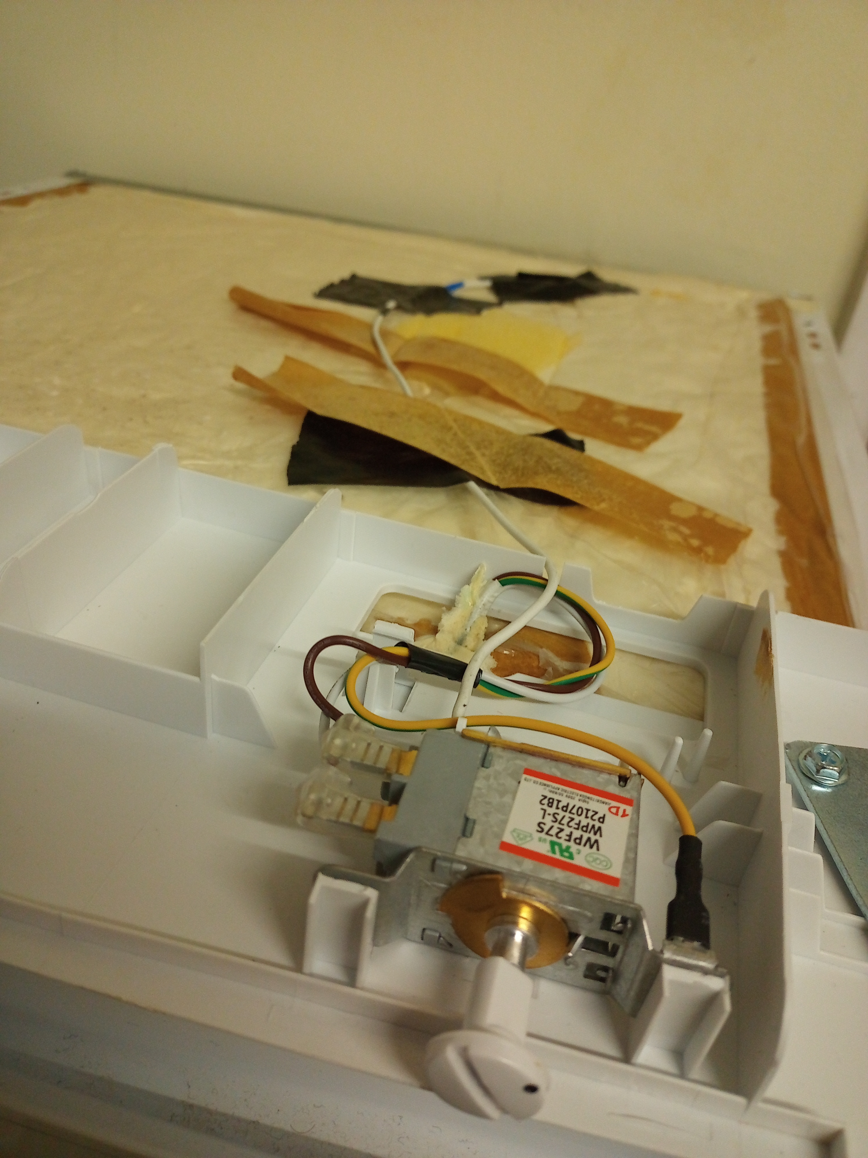

jennyjj01 wrote: ↑Fri Mar 11, 2022 4:34 pmINSPIRED! And bless you for fixing it and avoiding all that environmentally damaging waste.Yorkshire Andy wrote: ↑Thu Mar 10, 2022 10:54 pm Well next drama the flipping deep freeze is on the blink .. Looks like it's the thermostat on the blink. . . £40 lighter Vs £300 ish for a new freezer + loss of food it's full!
and a new one here tomorrow by post...
It's currently running fine having linked it out....
Always pays to have some random terminal connectors and wire in the shed.. it's currently running on a plug in timer half hour on an hour off seems to be working but not overly energy efficient
Glad I was like my little lad is and constantly followed my dad round watching asking why a lot as it didn't take long to diagnose it will be simple enough job to swap it 3 wires and the capillary tube remember my dad doing the fridge stat when I was little
Well the thermostat landed in about 12 hours from ordering to delivery DPD man turned up before 9am! Was about 10 to 9 last night when I hit order just before the next day cut off.... 8 quid next day delivery can't grumble for the service they do candy / hoover parts so £38 all in cheaper than a new freezer
https://www.4candy.co.uk/
Brief description of the task ...
Unplug from mains
Remove 2x screw caps
Remove 2x screws
Lift off the top of the freezer
Open freezer remove top draw. Pull and push the old thermocouple out through the insulation (mark the hole with a marker pen)
Unclip 3 wires mentally note where they go
Unclip Thermostat and get new one ready .. carefully bend the capillary tube being careful not to kink it
Push new capillary tube into insulation into freezer cavity locating it into the little tube it sits in..
Clip in new thermostat
Retrieve old thermostat from the bin and pull off the adjustment knob and fit to new stat
Push on wires
I resealed rte the capillary tube hole with a drop of pu gorilla glue
Tape capillary tube in place I am used duct tape
Refit lid
Plug in and switch on ..
Set thermostat

Excellent firm - one of my previous clients. Good solid West Midlands organisation, still run by the family.Yorkshire Andy wrote: ↑Fri Mar 11, 2022 8:15 pm
They have a website with a wider range
https://www.espares.co.uk/
All comes from Small Heath ( Peaky Blinders area)

By the way - bloody impressive skills - count me impressed.Yorkshire Andy wrote: ↑Fri Mar 11, 2022 8:15 pmjennyjj01 wrote: ↑Fri Mar 11, 2022 4:34 pmINSPIRED! And bless you for fixing it and avoiding all that environmentally damaging waste.Yorkshire Andy wrote: ↑Thu Mar 10, 2022 10:54 pm Well next drama the flipping deep freeze is on the blink .. Looks like it's the thermostat on the blink. . . £40 lighter Vs £300 ish for a new freezer + loss of food it's full!
Unplug from mains
Remove 2x screws
Push on wires
Refit lid
Set thermostat
