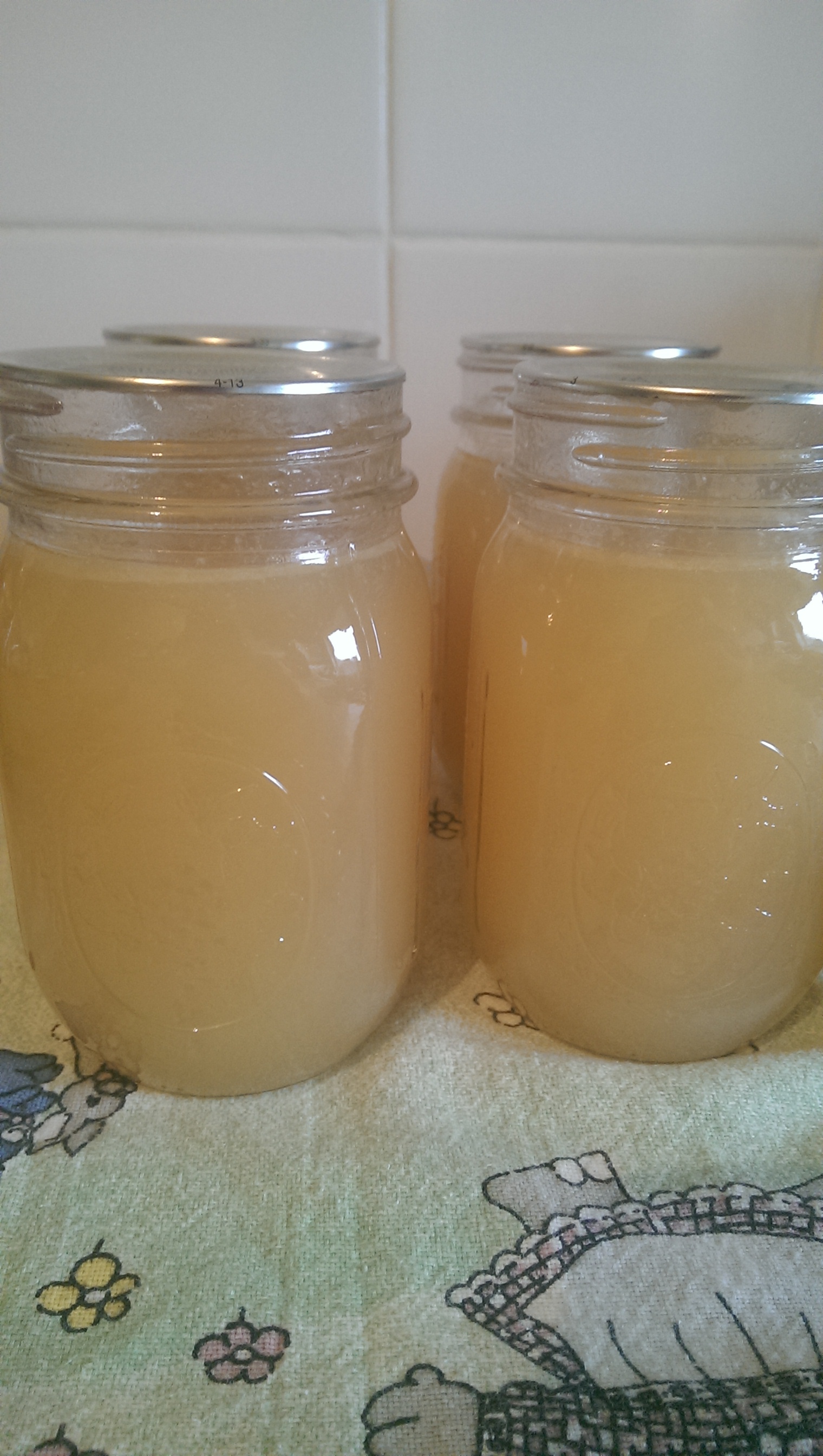

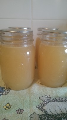

Just thought I would try to show you my latest canning exploits! These are jars of chicken stock made from our Sunday roast chicken. This is how I did it all.
Added chicken carcass, skin and all into my largest stock pot, added in 2 carrots, one onion, 2 bay leaves, 2 sticks of celery, 10 or so peppercorns and boiled the lot for 2 hours (lid on to so as not to lose it all in steam).
Drained through a metal sieve into a huge jug, washed out the stock pot and the sieve, placed sieve back over the stock pot this time with a muslin cloth over it to strain out all the little bits. leave this in the fridge overnight so that the fat can solidify on the surface and be removed.
Next day scrape off the fat to reveal the beautiful jelly substance underneath, bring this jelly to a boil on the cooker top.
Fill your canner with the correct amount of water (according to your canner instructions) and put this on the heat to prepare for the hot jars.
Wash canning jars, lids and rings in hot soapy water, but the jars onto a baking sheet in a hot oven to keep sterile, add the disc part of the lids into a saucepan and add just boiled water, keep this simmering for ten minutes or so (this warms up the wax sealing ring which makes it easier to adhere to the jar when canning and also keeps them sterile)
When stock is boiled and jars are hot hot hot, ladle the liquid into the jars leaving 1" head-space, wipe the rim and threads of the jar with white vinegar using paper towel to remove any residue or they may not seal, add the disc on top of the jar using a magnetized lid lifter and secure with the metal ring fingertip tight, using a jar lifter place into the canner.
When all jars/the canner is full, close canner and bring up to a boil, when you can see a steady stream of steam coming though the vent pipe, time for 10 minutes. when 10 minutes are up add on the weighted gauge (10 PSI for my altitude) and wait for this to start its jiggle. Once jiggling set your timer for 20 minutes and the countdown begins!
After 20 minutes are up, turn off the heat and leave well alone until the canner has come back down to zero pressure (you will know this from your own manual instructions) remove the weighted gauge, open the canner lid with the lid facing away from you as there will be lots of steam and this will burn your face if not careful. Remove the jars and set onto a tea towel and when all removed cover them over and leave till the next day so that they can seal up.
Remove the towel and check all jars for seal by pressing the top of the lid, if it moves up and down it hasn't sealed so can either be put into the fridge for use within the next few days or can be re-processed. If sealed, remove the rings and give the jars a good scrub under running hot water to remove the watermarks from the jar and lid. Dry and then using a permanent ink pen (I use a sharpie pen) write the contents on the lid and month, year and then they are ready to go into your food storage system.

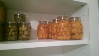

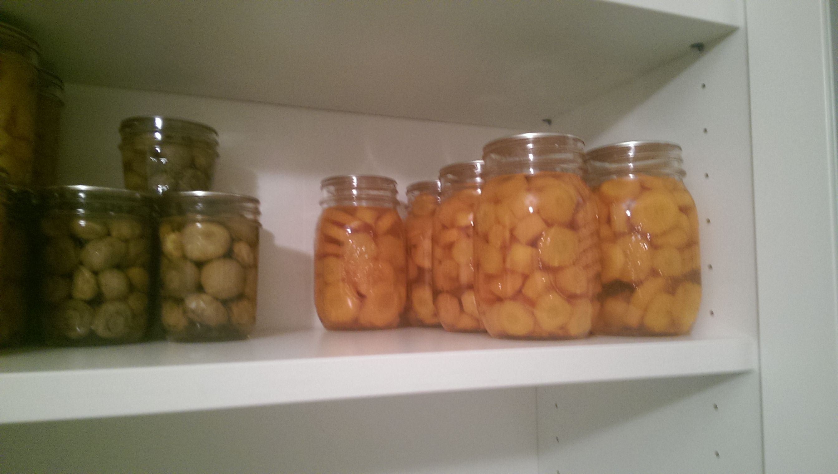

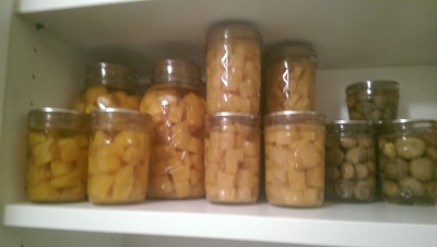

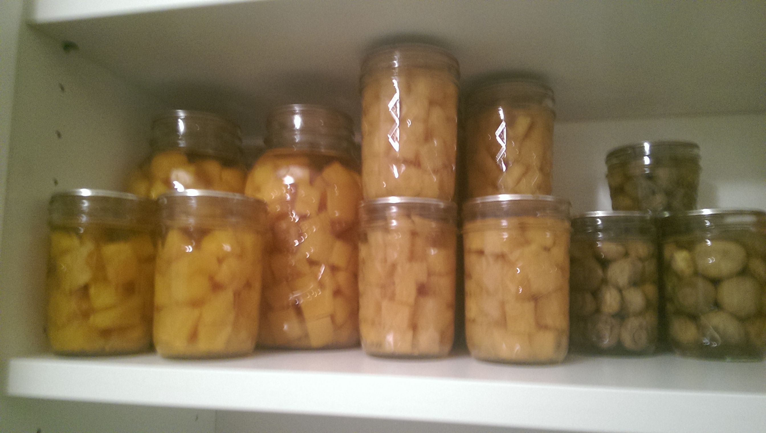

Butternut squash, swede, mushrooms, carrots, chicken stock. I don't have photo of the fruit but will add to my next posting.
