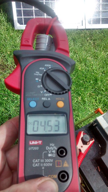

When you come to wiring make any cable runs as short at possible to minimise voltage drop to increase efficiency..
You will find on a decent bright day you will get about 2a 12v charging remember the panel puts out somewhere between 18v and 22v so by stepping down you get more amps... my 60w folding solar panel sticks out about 4.5a
When you get the unit set up you will need to program the controller. . This gives you all you need to know

Yorkshire Andy wrote: ↑Sun May 01, 2022 10:28 am You will find on a decent bright day you will get about 2a 12v charging remember the panel puts out somewhere between 18v and 22v so by stepping down you get more amps... my 60w folding solar panel sticks out about 4.5a
https://m.youtube.com/watch?v=EDl4cN1JREo
Doesn't that current increase only happen with MPPT type?
I don't regret buying PWM as it was cheap as chips. £9 compared to MPPT at > £20. As you say, there is a lot of misrepresenting going on.
I'm going to get my techy friend help with current measuring and assessing. If the charge current is higher than the panel current, I understand that would mean it's MPPT.
According to that video, PWM SEEMS to leave the panel disconnected a lot of the time.?

It's basic ohm's law.
V = IR, Voltage is constant, resistance is constant, therefore current (I) has to go down to satisfy ohm's law. Therefore, stepping up voltage results in a proportional step down in current.
You should be able to measure ampage easy enough with a basic multimeter

This is the Voltage trace from my pwm charger over the past week 60w of panels . ....
The discharge over night is the CCTV IP camera

Nice chart. What sort of data logger did that? Is there any equipment you don't have :D
Did the data logger prove useful in designing your solar gear or was it just one of the tools of your trade?
Will do. I think I get it. If it's mppt the panel voltage will not drop to the battery voltage and since power in = power out, the battery current will be higher than the panel current. If it's pwm, the panel voltage will pulse between 18v or so and battery voltage. Length of the pulse is unknown. I guess on your chart that the spikes on the charging peaks are those pulses. I'm guessing the off on pulses will be slow enough to see . Can hardly wait till my parcels come.
