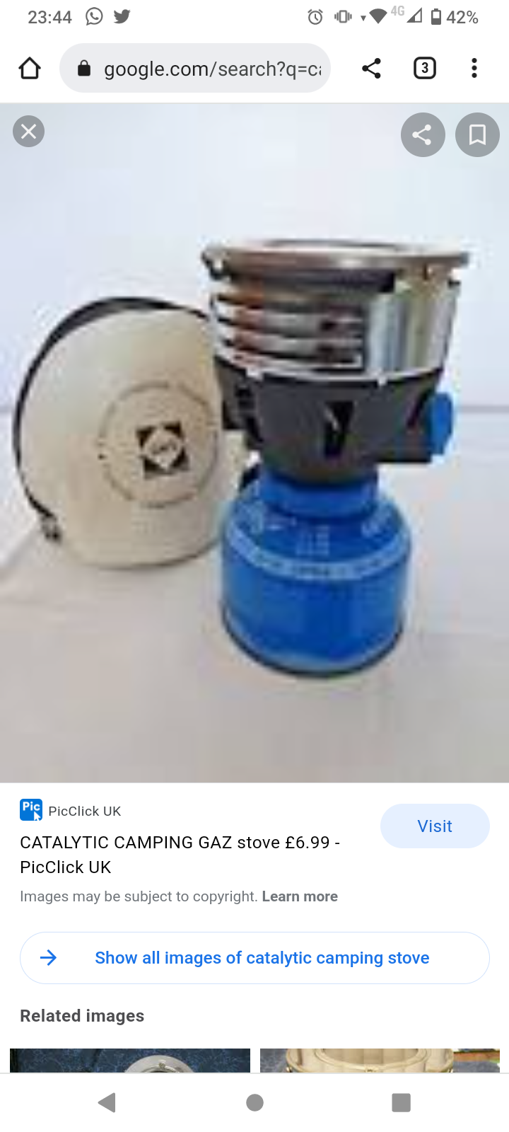

Camping gaz did do a catalytic camping stove years ago technically there was no flame it just got hot... But they discontinued it
