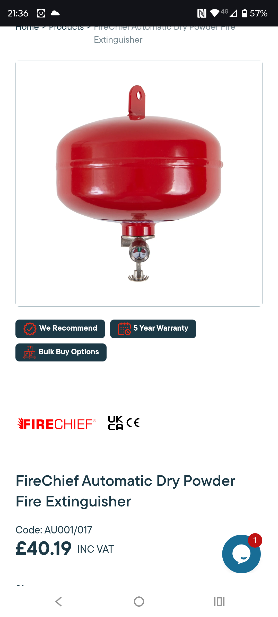

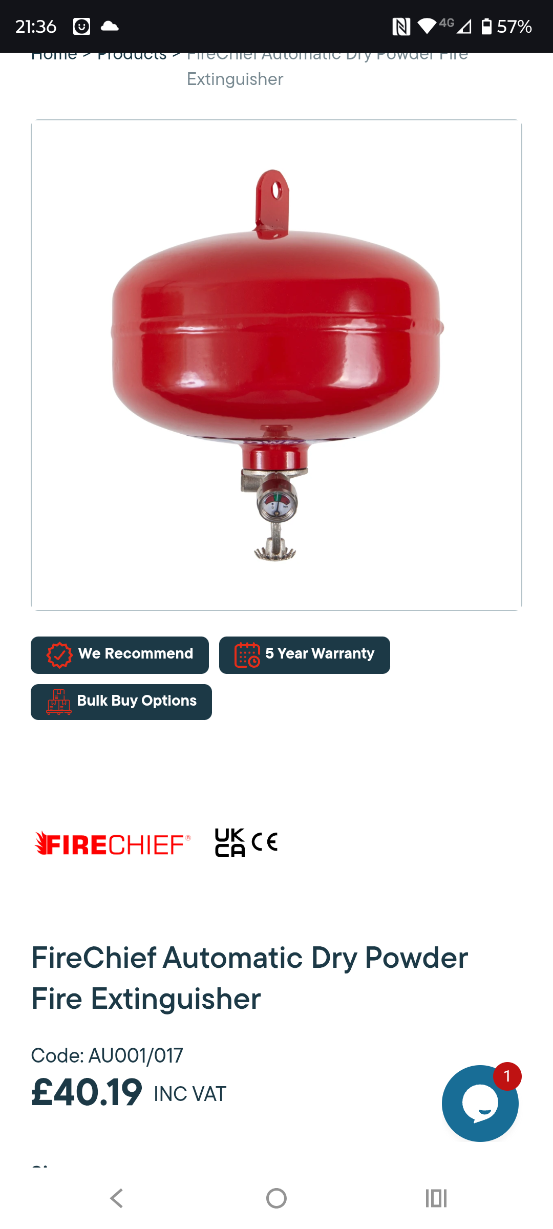

If you start storing any quantity worth making sure it's well away from the house well ventilated and ideally with a decent size fire extinguisher handy... Ive only got my shed so metal fuel cans I've added a 2kg fully automatic dry powder extinguisher on the roof

It's aldi saw them tonight I dont need any more extinguishers honestly :twisted:
Near by stick a 6kg powder minimum imo rapid knock down and very quick...
https://youtu.be/tlfhGmR9LvQ?si=mj6RRX-XzYlSEBye
If you are in a position to extinguish a big fuel spill you dont get a second chance
