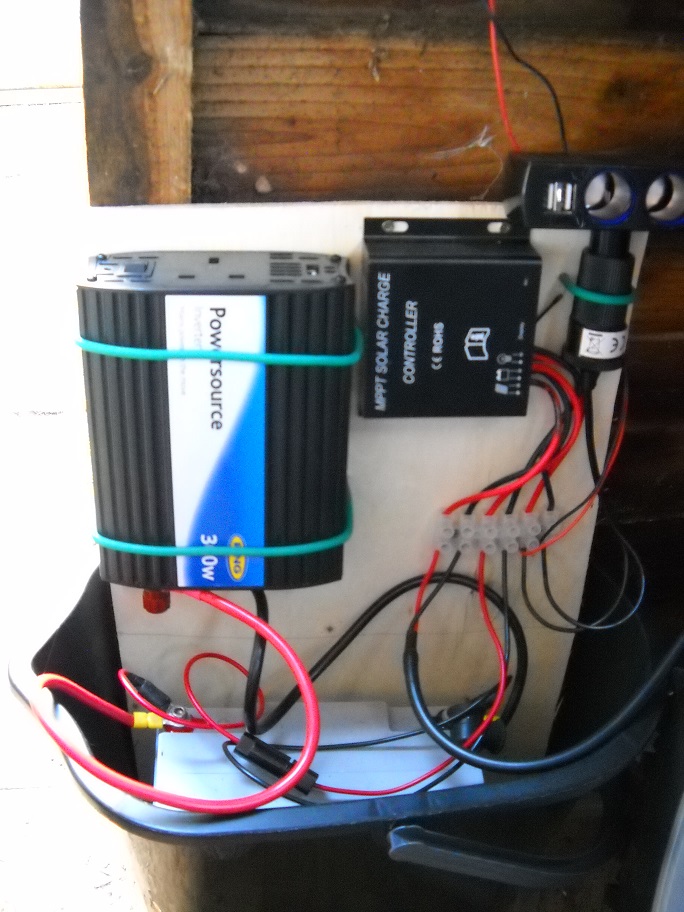

Brambles
Posts: 3093
Re: Portable Solar Generator.
Post by Brambles »
