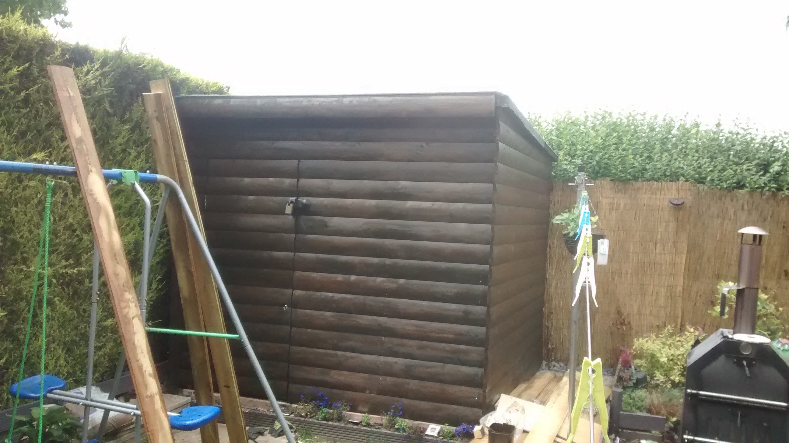

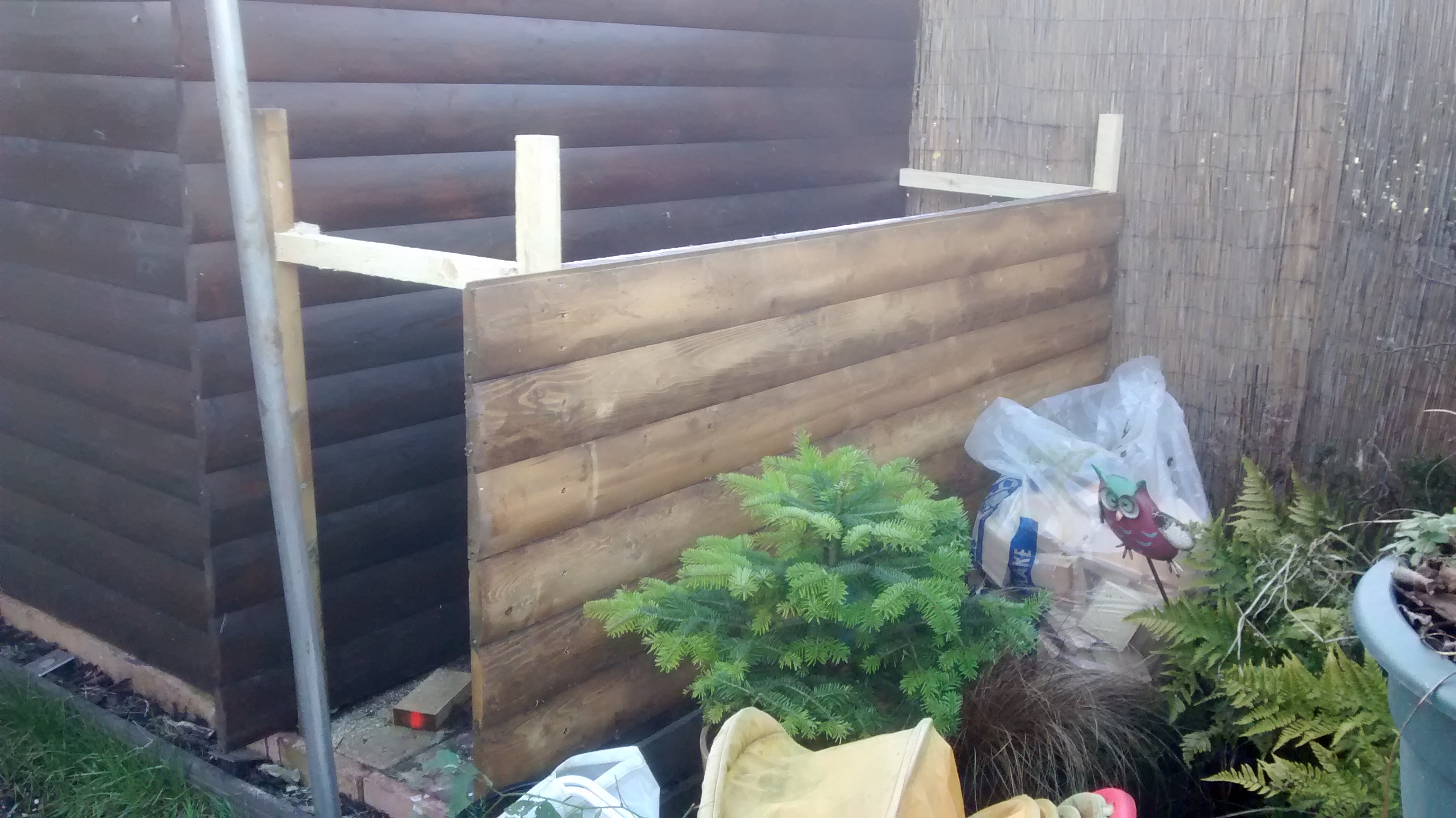

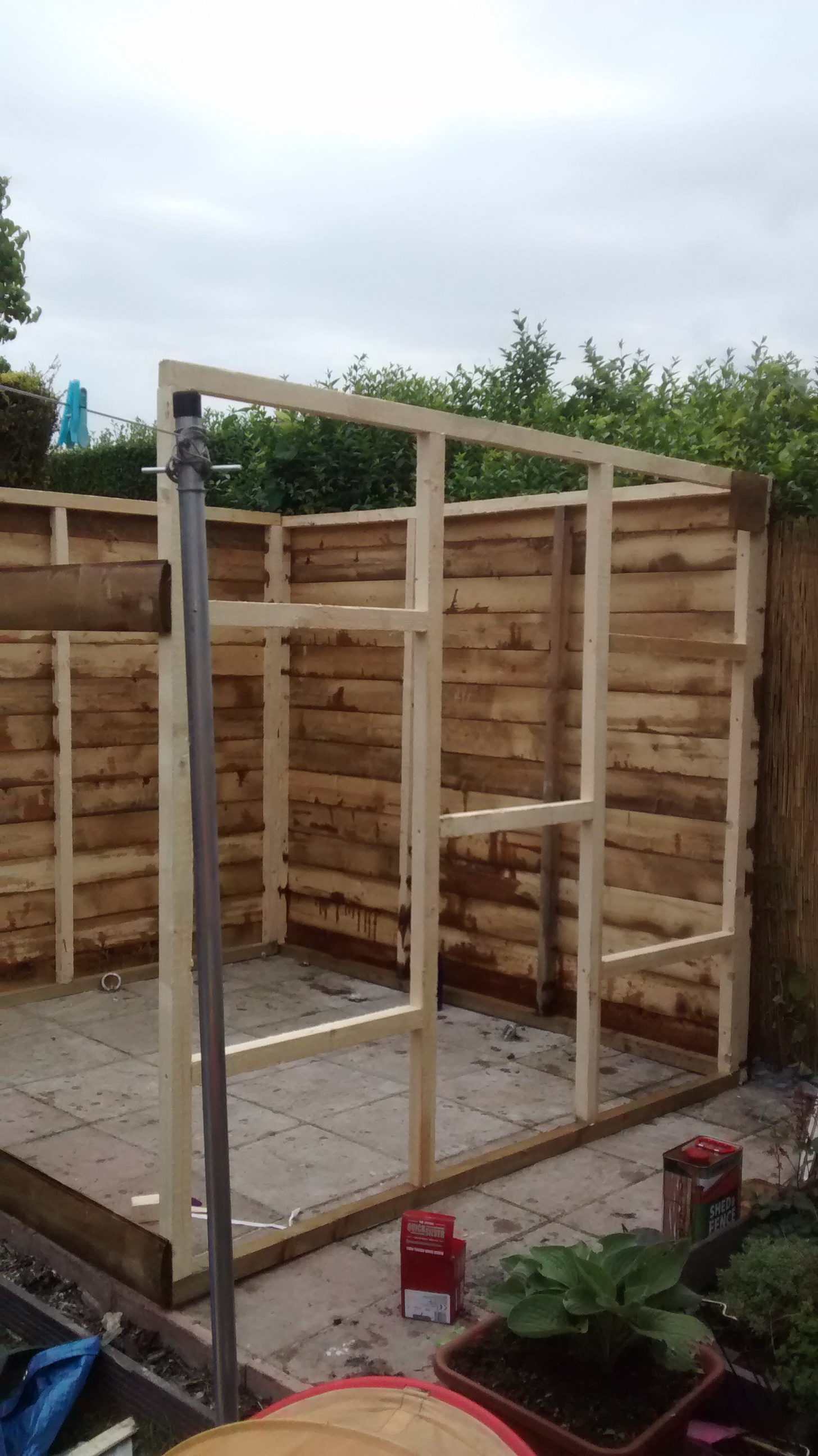

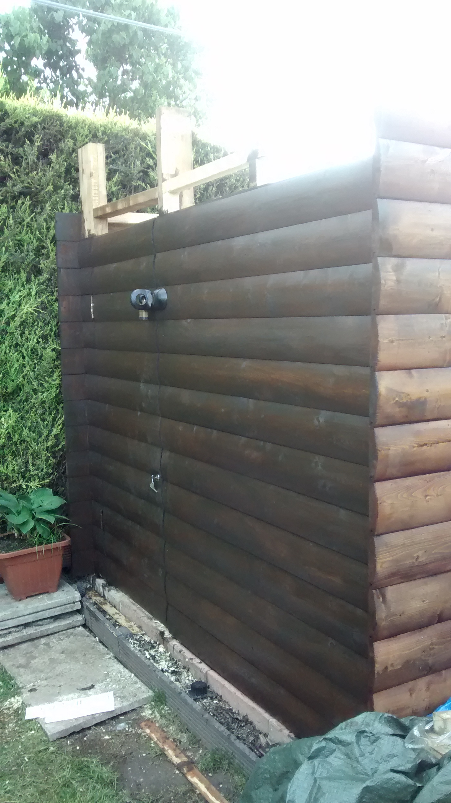

I built my own I laid a solid base of dry mix concrete over dpc viscrine (SPL) then bedded reclaimed flag stones on it. .
Watered well for 2 months the flags are solid as the moisture activated the cement.
I then used 2x2 tantalised batterns to make the base this was screwed to the slabs after first sticking the mastic framing tape they use on caravans to keep the frame off the floor by a few mm and provide a waterproof seal.
Then I built each wall out of 20mm log lap and erected the 4 walls (each plank was individually " painted" twice before assembly. First it was sprayed in a very hot dry summers day then brush coated a few days before assembly paying special attention to the tongue and grooves. )
http://www.diy.com/departments/ronseal- ... GwodNecBSQ
As I assembled each plank had a thin bead of contractors panel adhesive sealent squeezed into each groove to aid water proofing and strength also glued to the frame before been screwed with decking screws and nailed with galvanised oval nails top and bottom ....
Roof is 11mm tg on a 2x2 rafter set up covered with torch on felt
Guttering and decent door furniture finished the job
Probably £250 on wood..
And £100 on fixings and hinges. Less the locks
Felt was £35 a roll

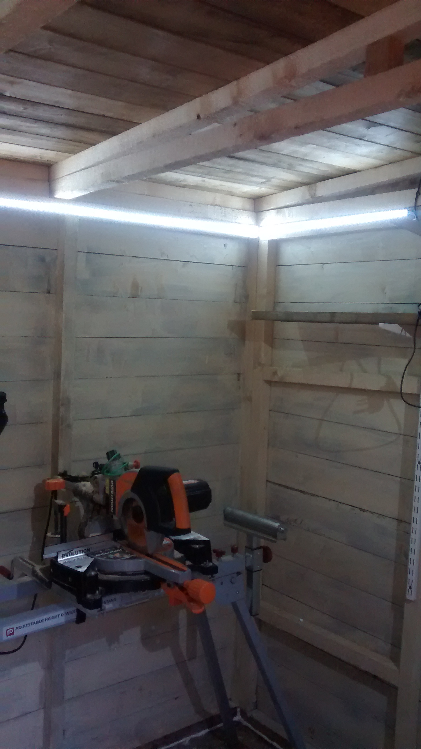

PS in the bottom PIC that's not daylight between the walls and roof its 12v led strip

Re: Sheds and Green houses
featherstick wrote:Do build a hard-standing. Andy's post is good but he has compromised his shed by having it directly on the slabs. Raindrops from the eaves will splash directly back onto the bottom panel, eventually rotting it. A pal of mine has a lovely big shed at the bottom of his garden which is rotting for this reason. Guttering can mitigate some of the issue, of course.
Ahh but you can't see the back and sides as they stand now
First thing to go on sheds usually is the floor hence my floor is the slabs
The cladding is about 10mm off the floor and the 2x2 tantalised ground frame will be reasonably simple to replace
The front is level with the edge of the hard standing. With a slight overhang to shelter my flood lamps so no splash up
The back and left side are on the edge and the ground round is chipped slate to allow sokeaway / splash defection / no mud splashing up with a 12" gap between the hedge / conifers which are restrained from the fence by reed screening keeping the worst of the driving rain off it
The back has the guttering,
The right now has my wood store lean too storage box which I'm on with now as I run out of time and weather last summer
Its not perfect but its way better than what I could have bought at a shed place for the money
