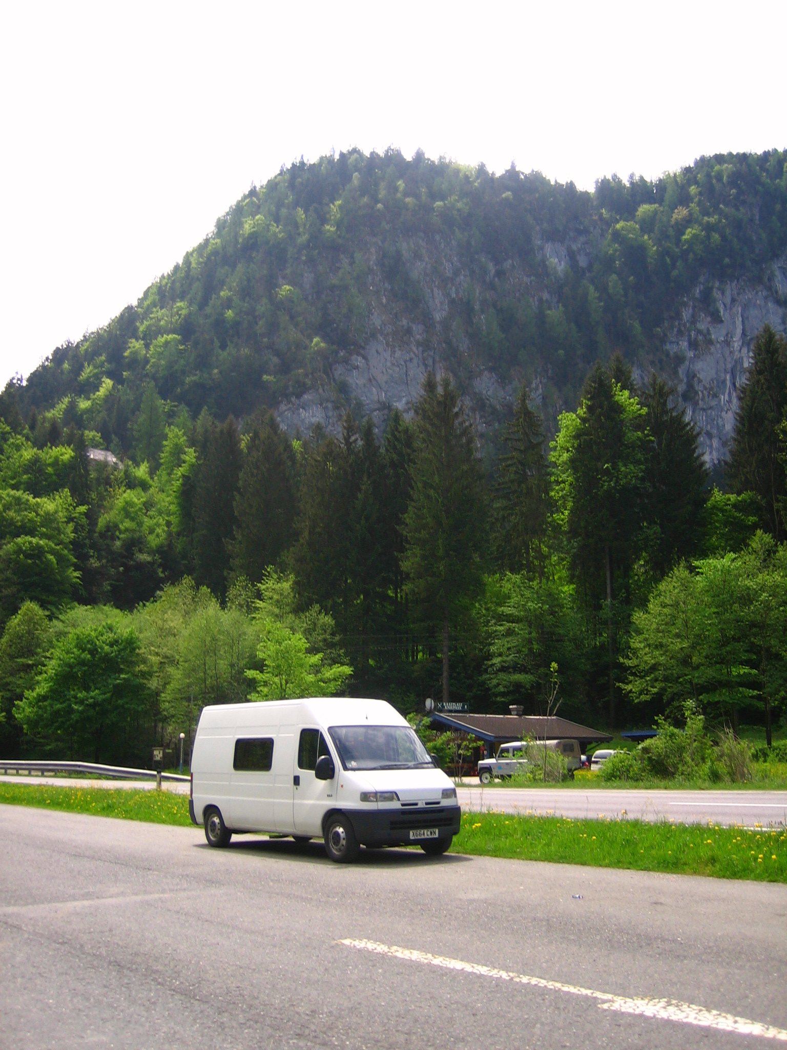

As a 'cheaper' way into motorhome-ing we bought a £4000 van (LWB Citroen Relay aka FIAT Ducato) & did a home conversion. Couple of windows, lined & insulated basic kitchen, basic seating/ beds, separate loo/shower spent shade over £1000.
We used it for two major trips 1st being two months (UK-France-Germany-Czechoslovakia-Austria-right around Italy-France-Belgium-Holland-France-UK) then 2nd 6 weeks (UK-France-Spain-Portugal&back). Absolutely brilliant.
We sold the van for just a little less than the converted cost so I doubt 'depreciation' was more than a few hundred pounds over the 3 years of ownership.
As other posters have said the fixed costs (MOT/Insurance/Tax etc) can mount up. To get any good value you have to make use of the thing.....

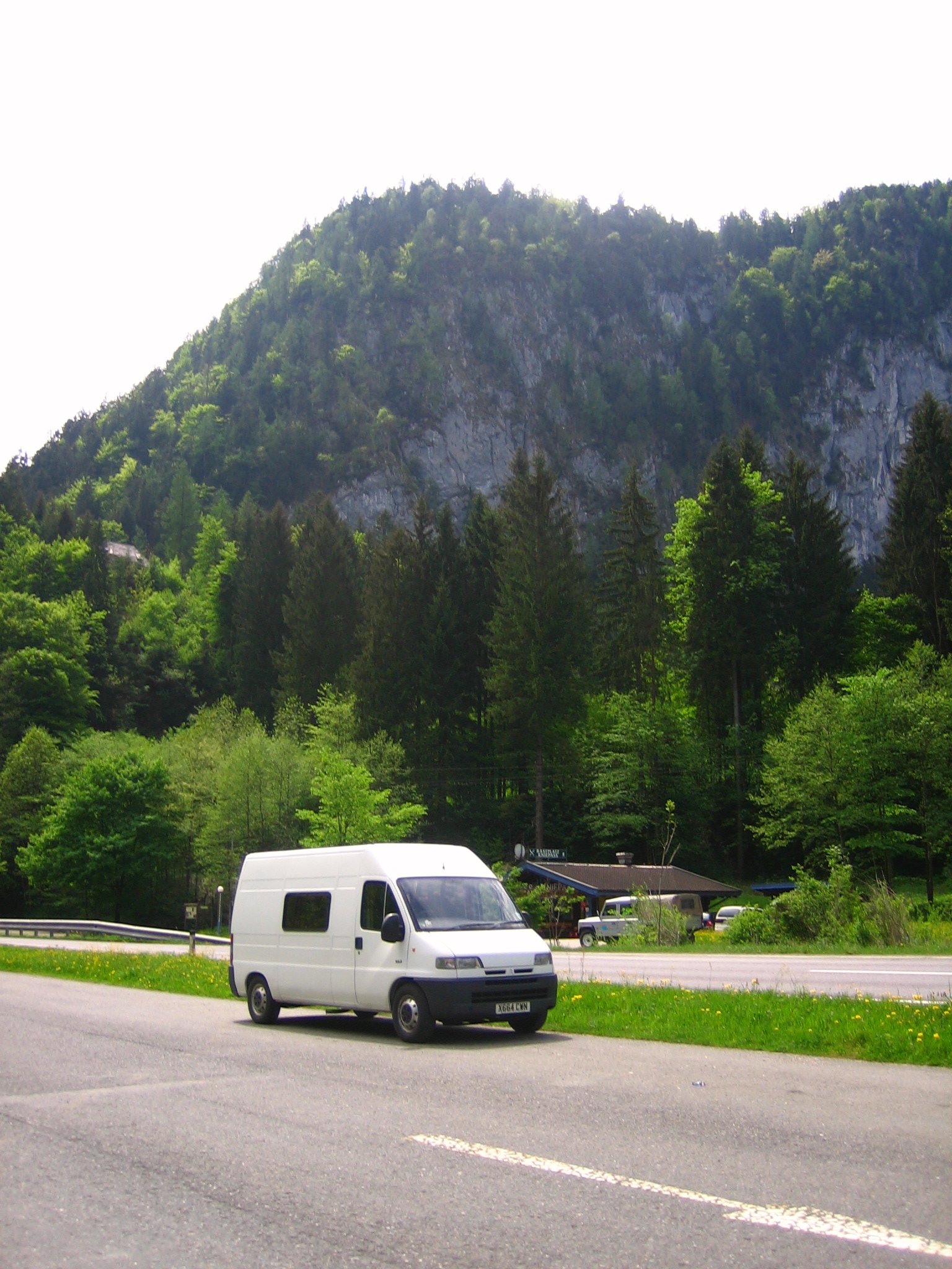

Hi PP,
To make a basic conversion is pretty easy. Def. a DIY possibility.
You can sub-out fitting the windows (an 'local' Autoglass car window fitter should have no problems fitting the windows, which you can buy over the 'net).
Most vans will already be lined with plywood - remove this & stuff the gap full of insulation (you could used rockwool but possibly a better alternative would be aluminium-ised camping mat). Replace the plywood, this can be tidied up with a combination of a nicer veneer or even (don't go overboard) using Pergo -type laminate flooring on floors and walls (at least to kitchen unit height)
You can buy pre-made campervan furniture (there was an episode of 'Wheeler Dealers' where ED China did a very basic conversion of a VW Transporter
http://www.dailymotion.com/video/x3id7eh but we made our own (MDF / Veneered chipboard)
The benefit (to us) was that when we did the conversion -2006- we could purchase a van (a year 2000 Citroen Relay extra LWB, Max height) for under £4 k. £1k for the conversion meant that we were ready to go for £5k. You can't buy a 6 year old, professionally converted, van for that sort of money - from a dealer you'd be paying probably £10-12k (min) so it made sense, for us at least.
The reason (apart from my natural meanness!) we wanted a home conversion is that for our budget we wanted a newer reliable van; at the time £5k would have meant a 15 year old (if professional conversion) Renault Traffic. 20 mpg & mirrors the size of matchboxes - hardly ideal for a 6000 mile trip, over the Alps around the Amalfi coast etc etc
