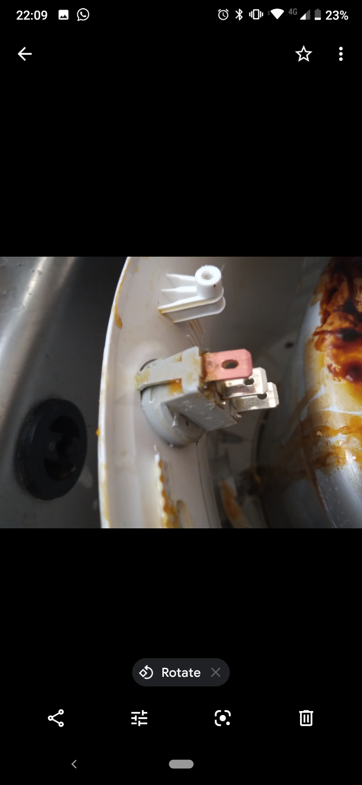

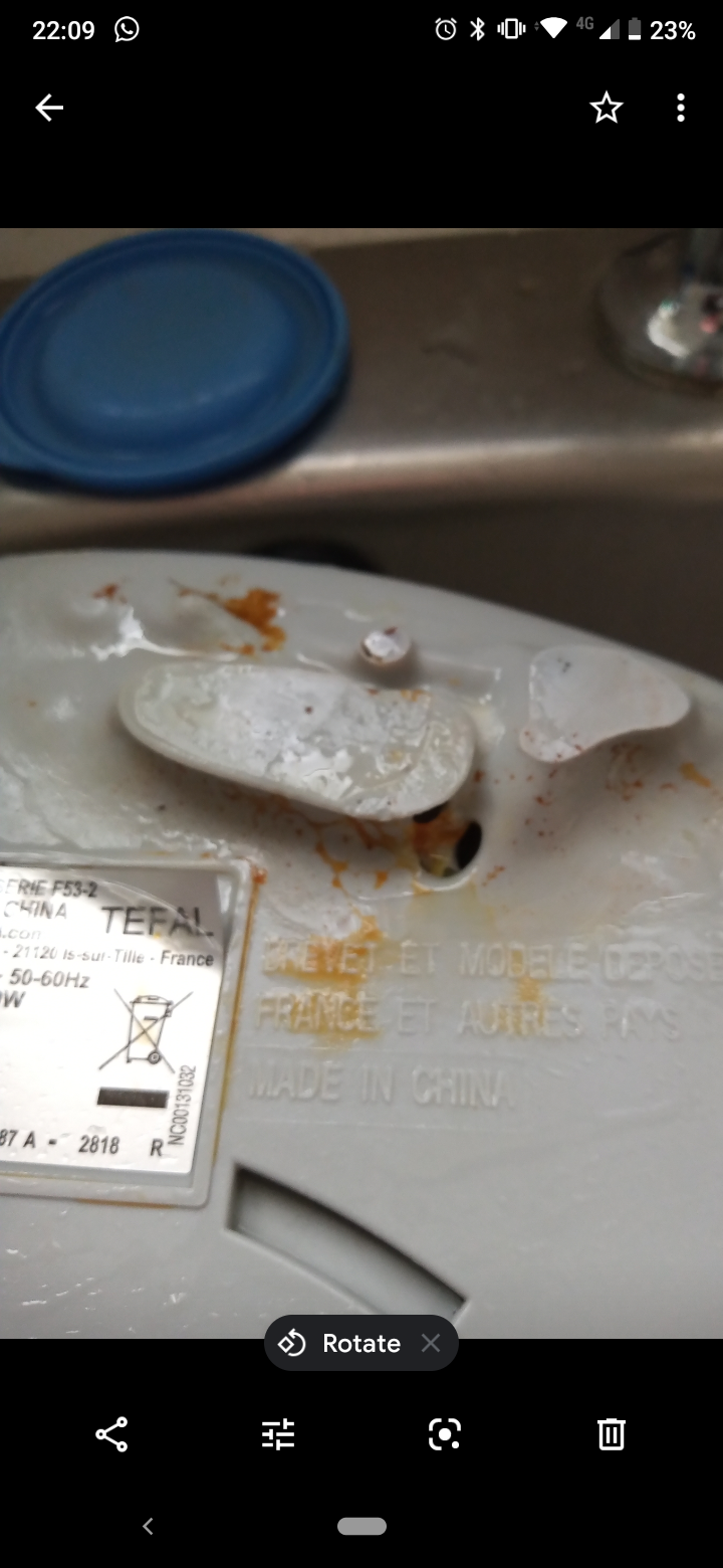

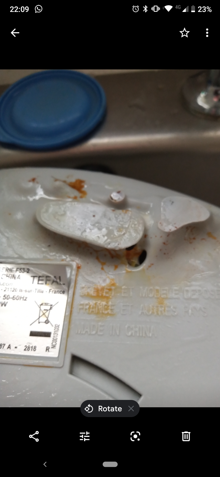

Check your domestic appliances regularly look for scorching on sockets and plugs
Check the body of appliances for deformation
This was our chip frier
Bad connection on the switch had caused the casing to melt and bubble :shock:
Never smelt it when in use either bad connection to the switch see how it's got hot and burnt the plating off one terminal
