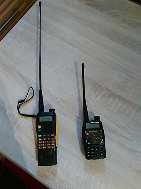

Hi guys, sorry to hyjack your post but I had a quick question and you guys seem to really know your stuff. I have a Baofeng GT3 MK2 and a UV-5RD. Do you need a licence for these?

ian2509 wrote: Mon Apr 15, 2019 1:25 pm Hi guys, sorry to hyjack your post but I had a quick question and you guys seem to really know your stuff. I have a Baofeng GT3 MK2 and a UV-5RD. Do you need a licence for these?
I believe if these two radios are in factory or 're programmed to 446 pmr form you would need a licence to legally transmit on ham unless in a emergency only .
Pmr requires a output of no more than 0.5watts and both have removable antennas in any case which doesn't meet directive 2014/53/eu.
So if on 446 pmr would not meet licence specs in any case .
In ham form yes a licence is required to transmit ,not receive .
I am unable to make out the frequencey in the two radios displays ,my guess is their still on factory set frequencies so are very usable for monitoring between frequencies 144/146 where most the locals may chatter on .
As I believe already mentioned in posts above this it would seem many of these are used illegally anyway and many don't get noticed as they remain respectful and replicate ham radio lingo .
Good little radios ,can be improved on transmit receive by adding a strip of wire at right length to frequencey to ground .
They also have a fm radio but squelch needs to be engaged to use .
Don't be tempted to fit headphones plugs or extension mic .as pins go in after time
They are known to break a contact on the boards loosing transmit audio out.
Can be fixed with a quick simple solder blob which also serves as a prevention.
See YouTube no audio fix baofeng uv5.
Very usable radios , better than most make them out too.
