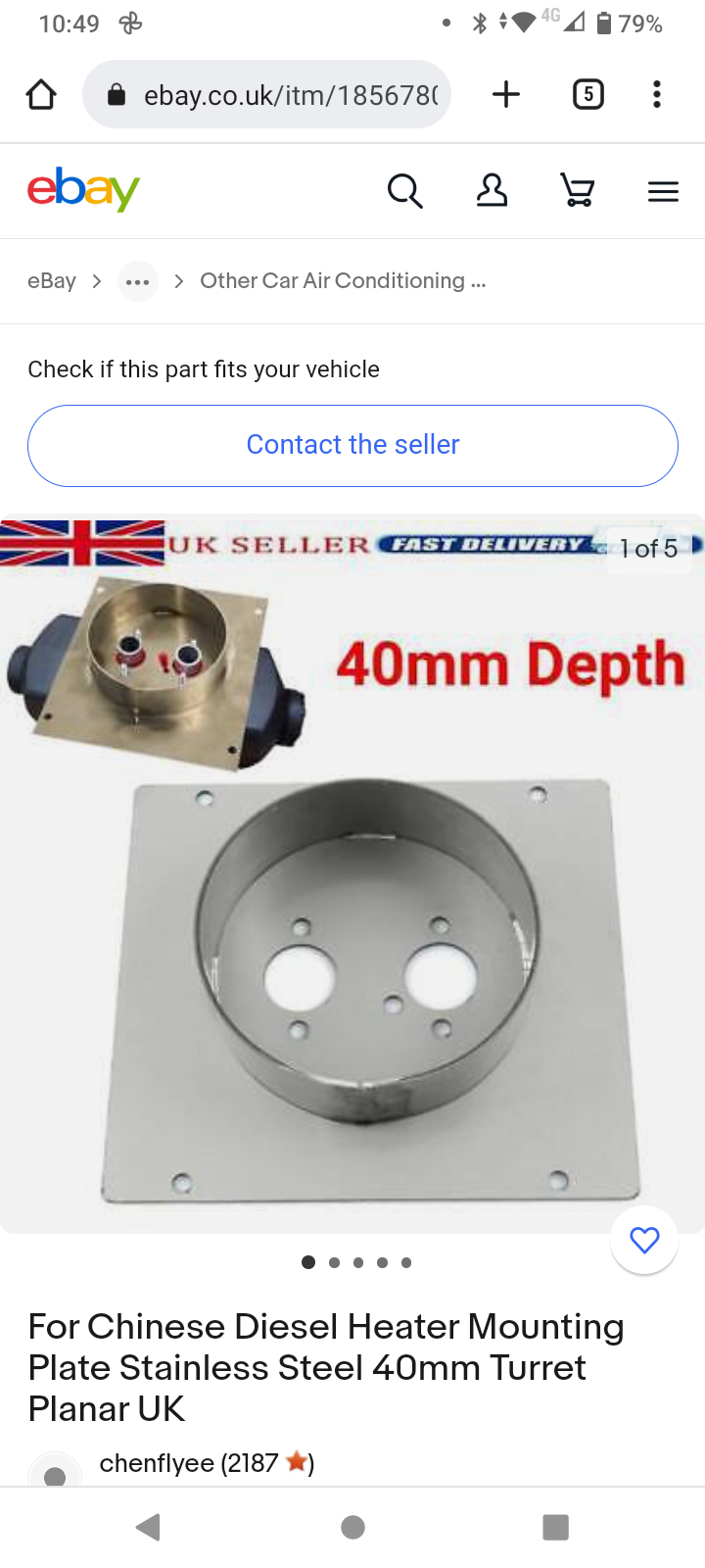

Following this with interest. Husband has bought a diesel heater for his new shed, due to be delivered early next year. He hadn't ever heard of them but his pal down the road has them in his shed and motorhome and is now getting one set up for his house. Only thing is he is unsure of is how to stop the exhaust heat setting fire to the shed where it passes through the shed wall to the outside. And YA or JM he is asking if the air filter should be outside as well?

What sort did he get lil? The free standing jobbie or the kit version?
You can strip the free standing one down easy enough I'd still replace the fuel line anyway
Both the combustion intake and exhaust should be outside they can cough and fart exhaust smoke out the air inlet if they dont start properly or flood ...
I'd mount using a turret plate this keeps the exhaust well clear of the shed
