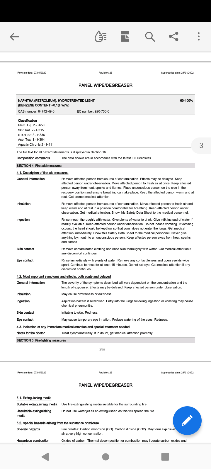

For Coleman I use this
https://www.amazon.co.uk/PWD005-Tetrosy ... 3420&psc=1
Posts: 4058
Re: Using old Diesel
I can see how that would work although it doesn't look to be any cheaper than the Aspen.

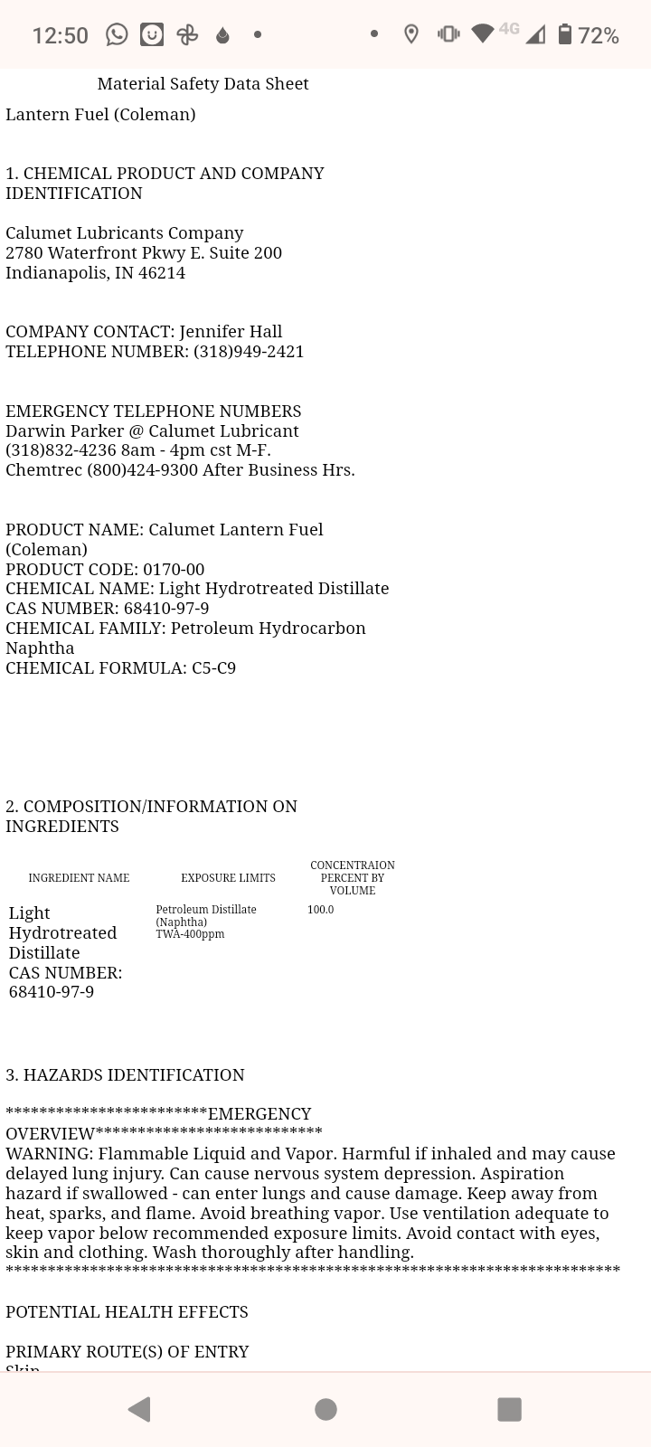

A thought did occur to me however. I could probably trawl through the net to find the answer but perhaps you'll know Andy. As I understand the maximum amount of petrol that can be stored legally is 30 L. As that stuff is degreaser or is sold as that , rather than as a fuel does that make for a loophole where I could store 100L or more? Just thinking of the legal angle here not the practicalities of how long 100L would take to put through a coleman or any safety aspects . My gut feeling is that there are probably regs that don't permit it but just wondered...
