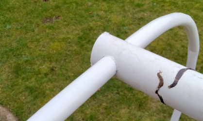

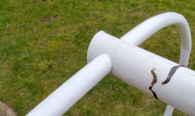

The cloche construction has commenced. I've opted for simple hoops of 3m x 20mm plastic conduit with an inspired but untested, money saving design feature*. Photo's to follow when the polythene arrives.

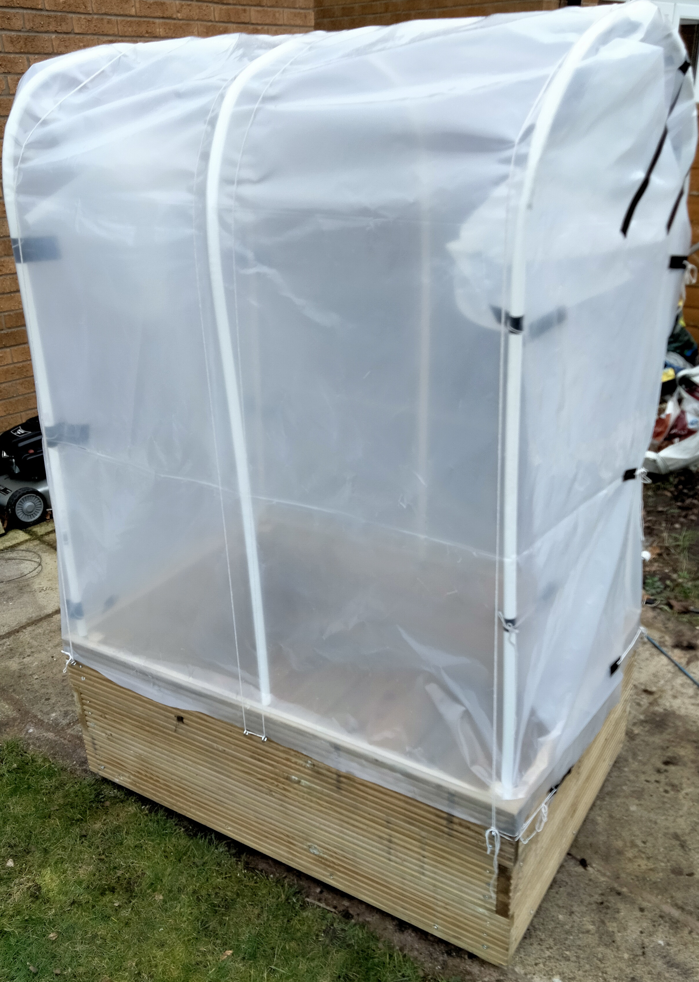

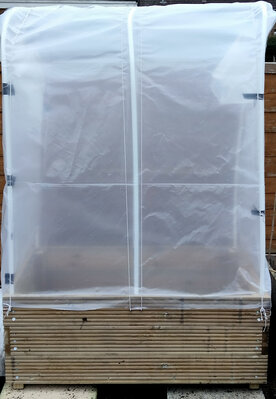

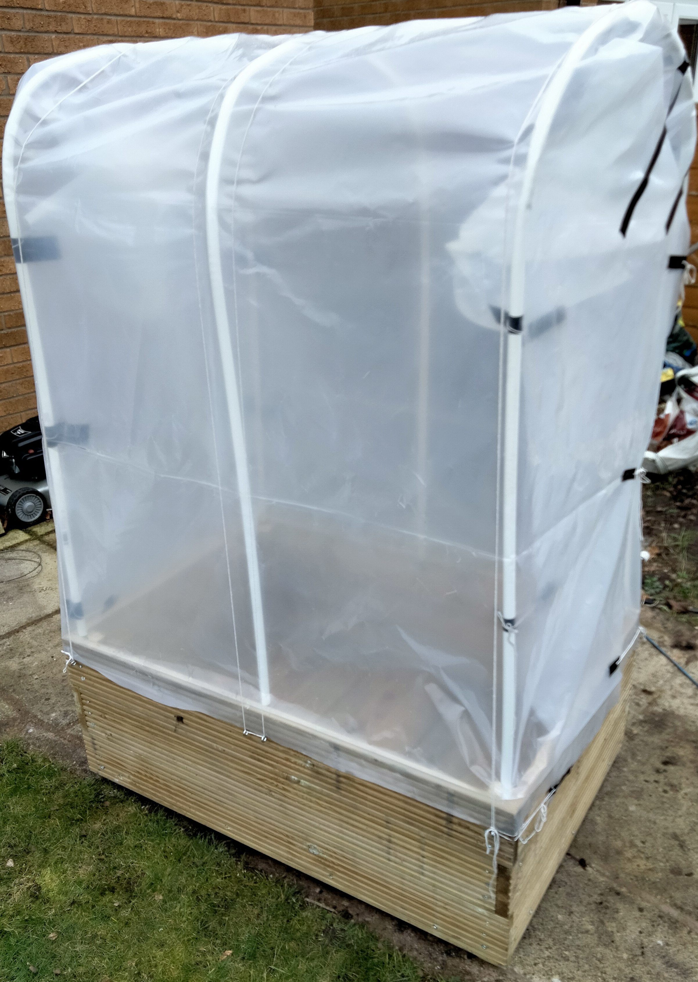

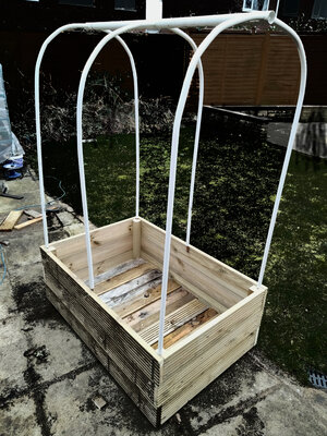

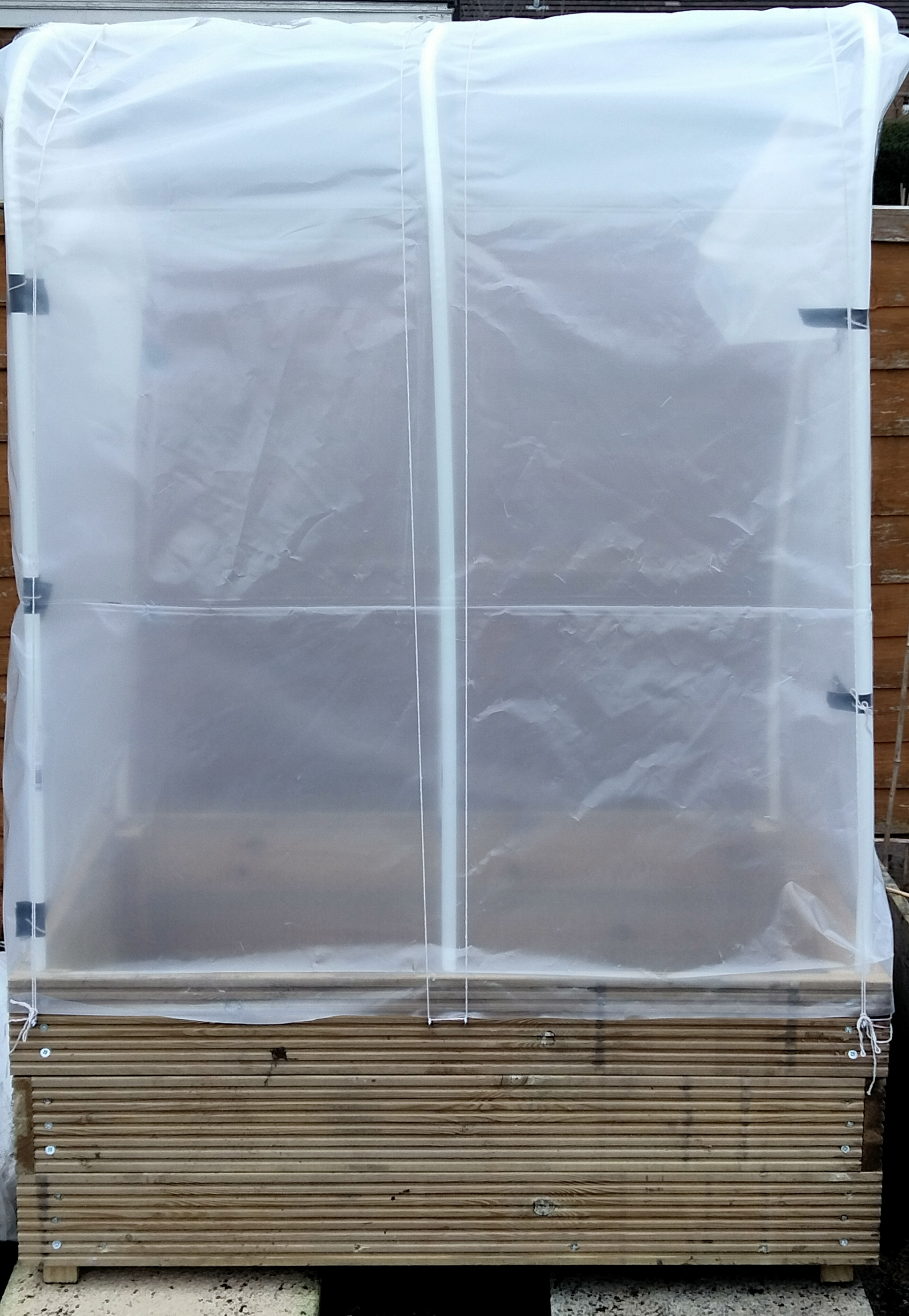

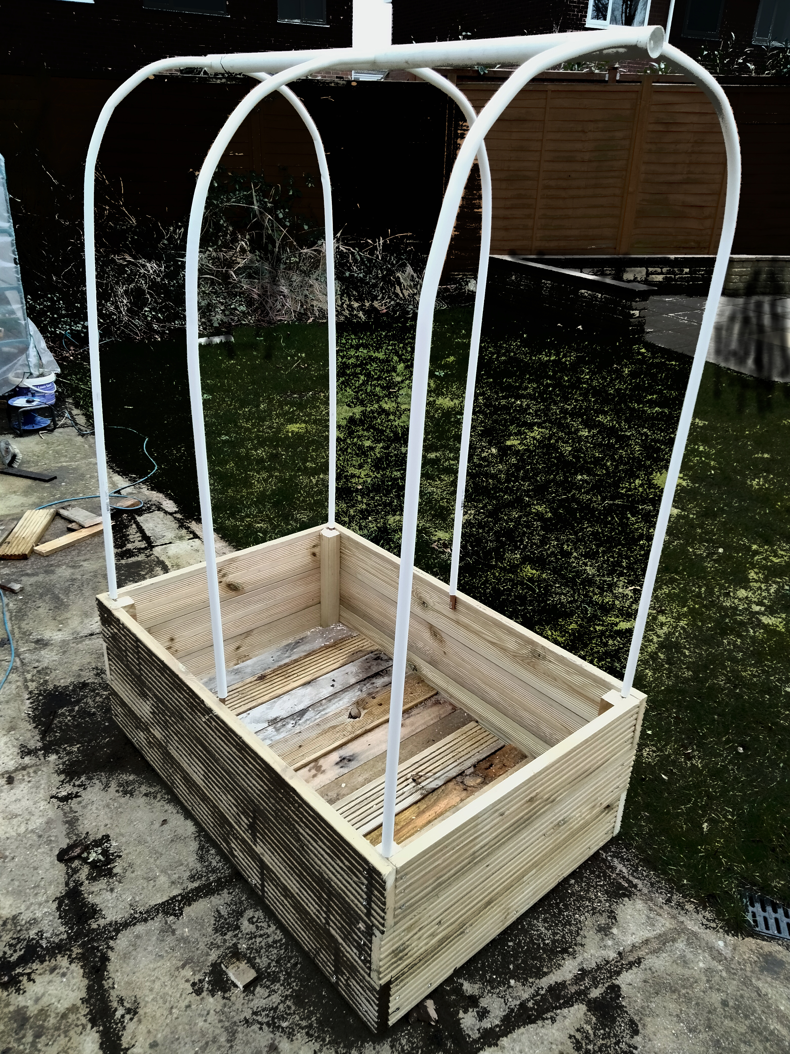

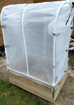

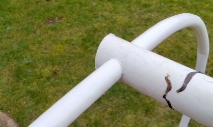

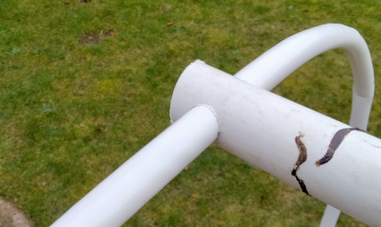

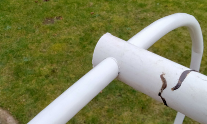

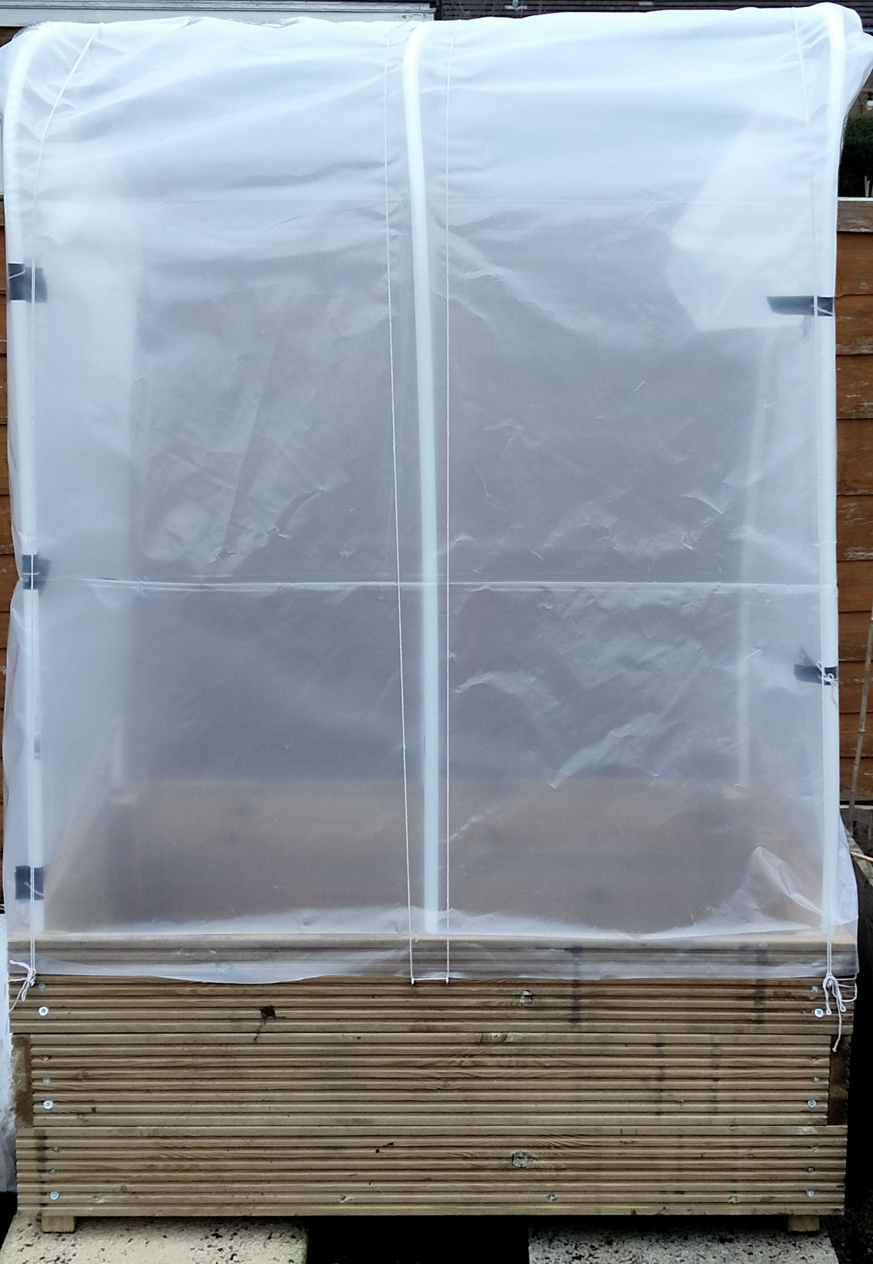

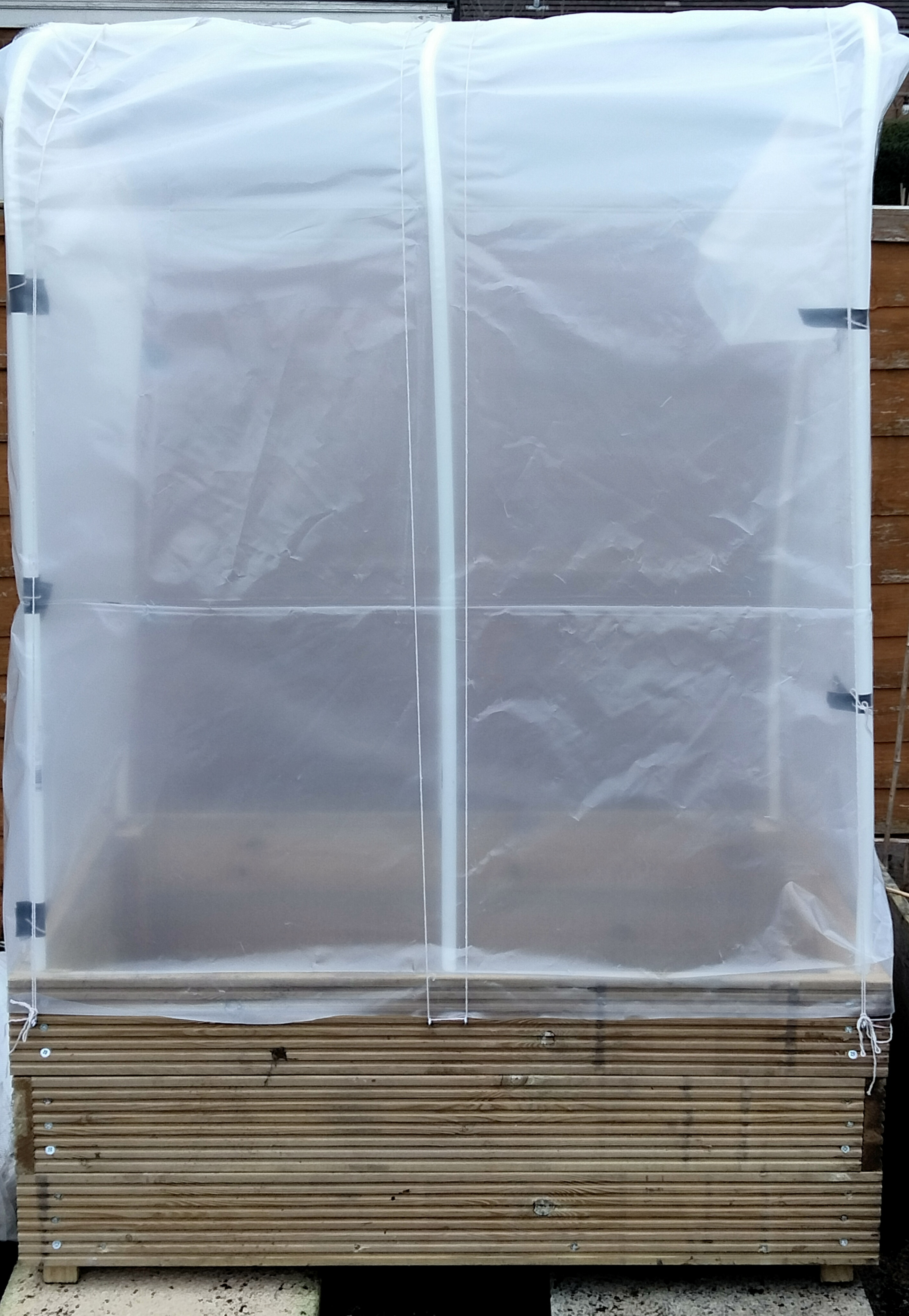

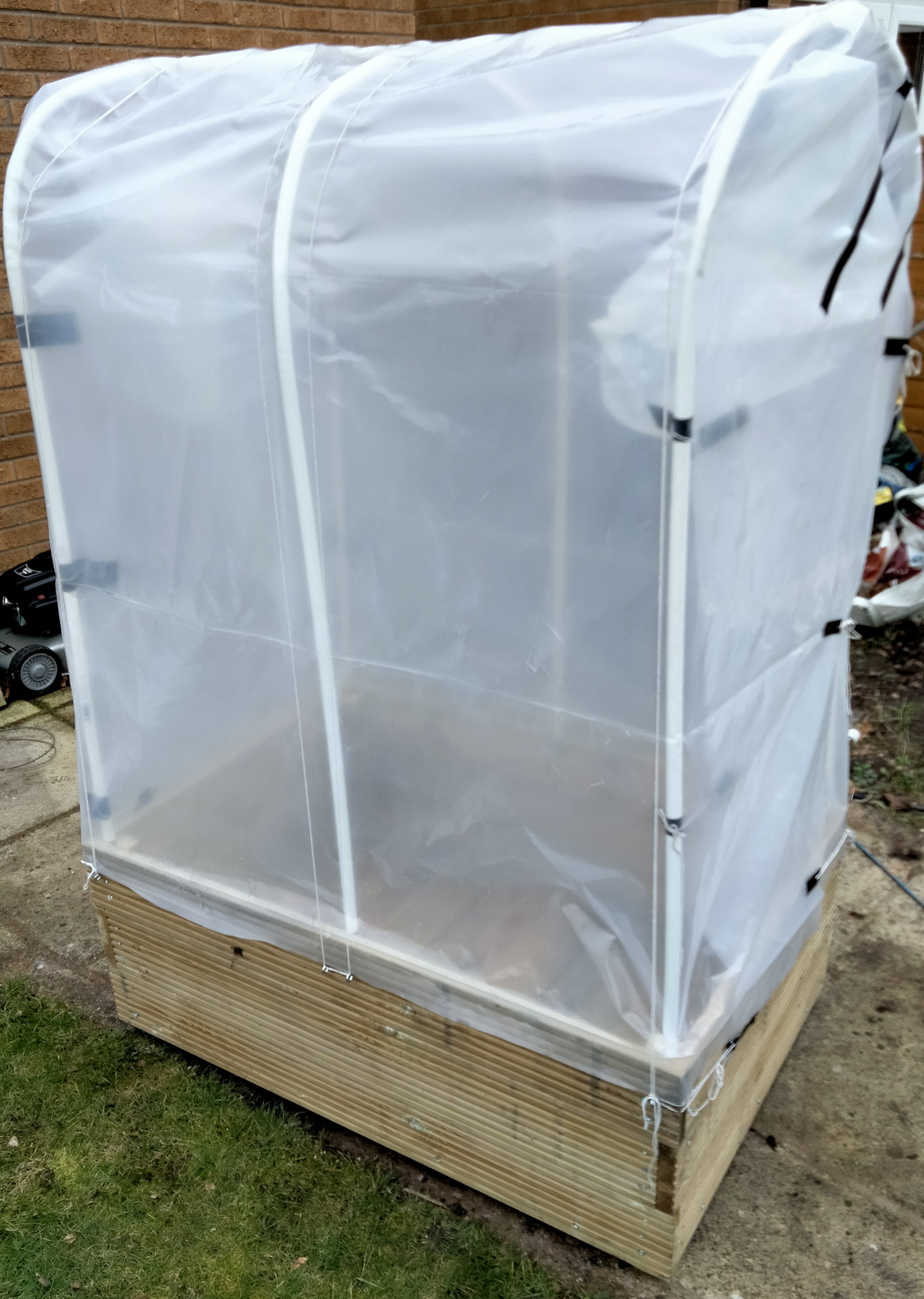

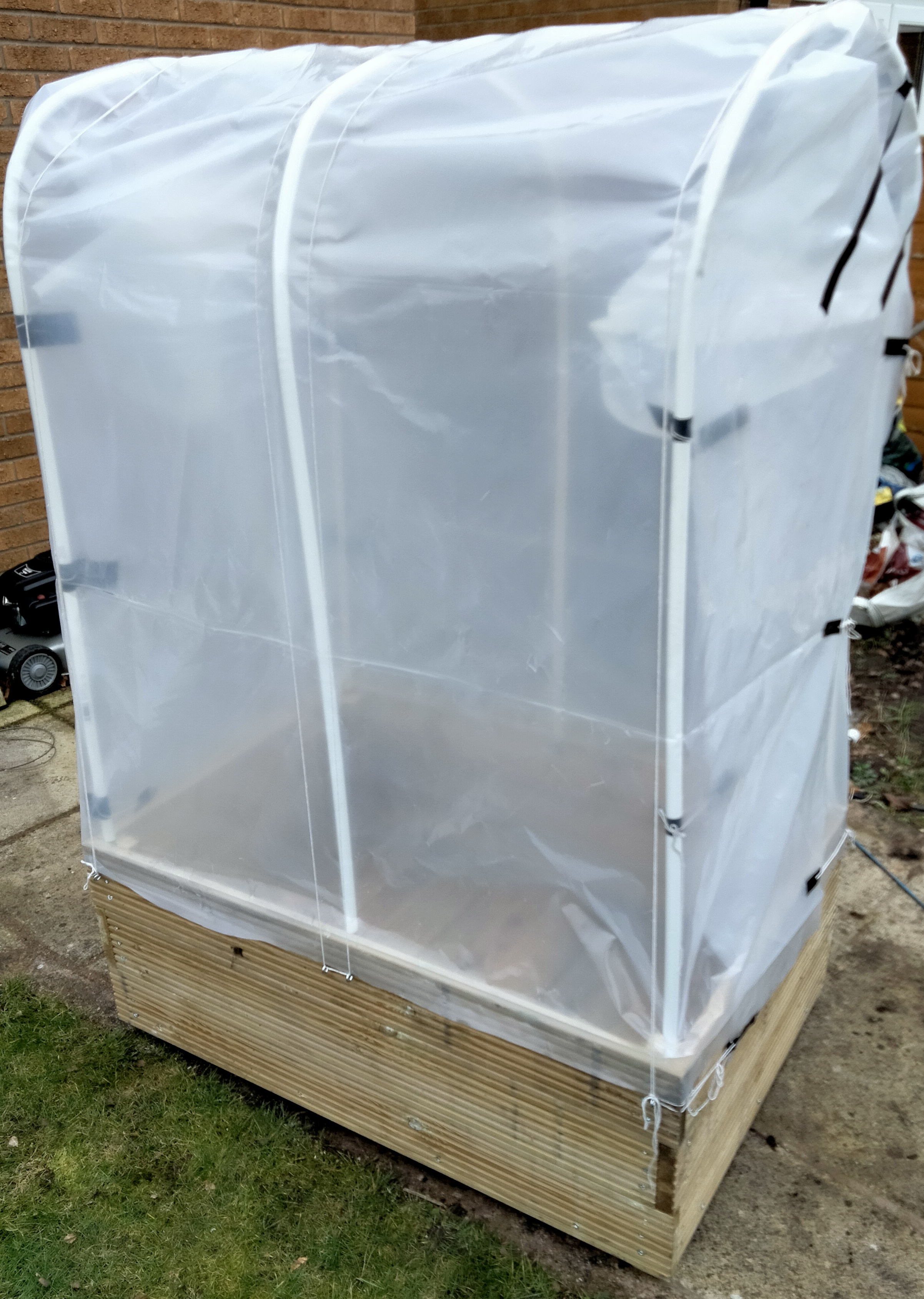

Yayyyy. New planter converted to a cloche/poly tunnel. I'm so chuffed. Just have to share Mr J's handywork.
Here are some pictures, including my inspired design feature.
Box comprised
5 lengths of 2400 x 150 decking
2 lengths of 2400 x40x40 sawn timber
Box of 70mm screws
8 x 40mm eye screws
Some pallet and decking offcuts for the base.
That lot was just over £100
Cover hoops
3 x 3m lengths of 20mm plastic conduit (Screwfix £2 per length)
1 x 1200 length of 40mm waste pipe.
Cover polythene
2500 x 4000 Really thick Clear polythene ( £20 of amazon for 5000 x 4000 piece)
Cover mounting posts
6 x 150mm pieces of 15mm copper pipe. Drilled into the corner posts and held by a screw. Centre ones just 2 screws each.
Ball of string to tie down the cover and some gorilla tape to make reinforced tie points. Short bits of string to tie off the ends.
Bending the hoops was a beggar. Eventually found easiest to do while heating over an electric convector heater. Warm till you feel it soften and then bend CAREFULLY and in sections.

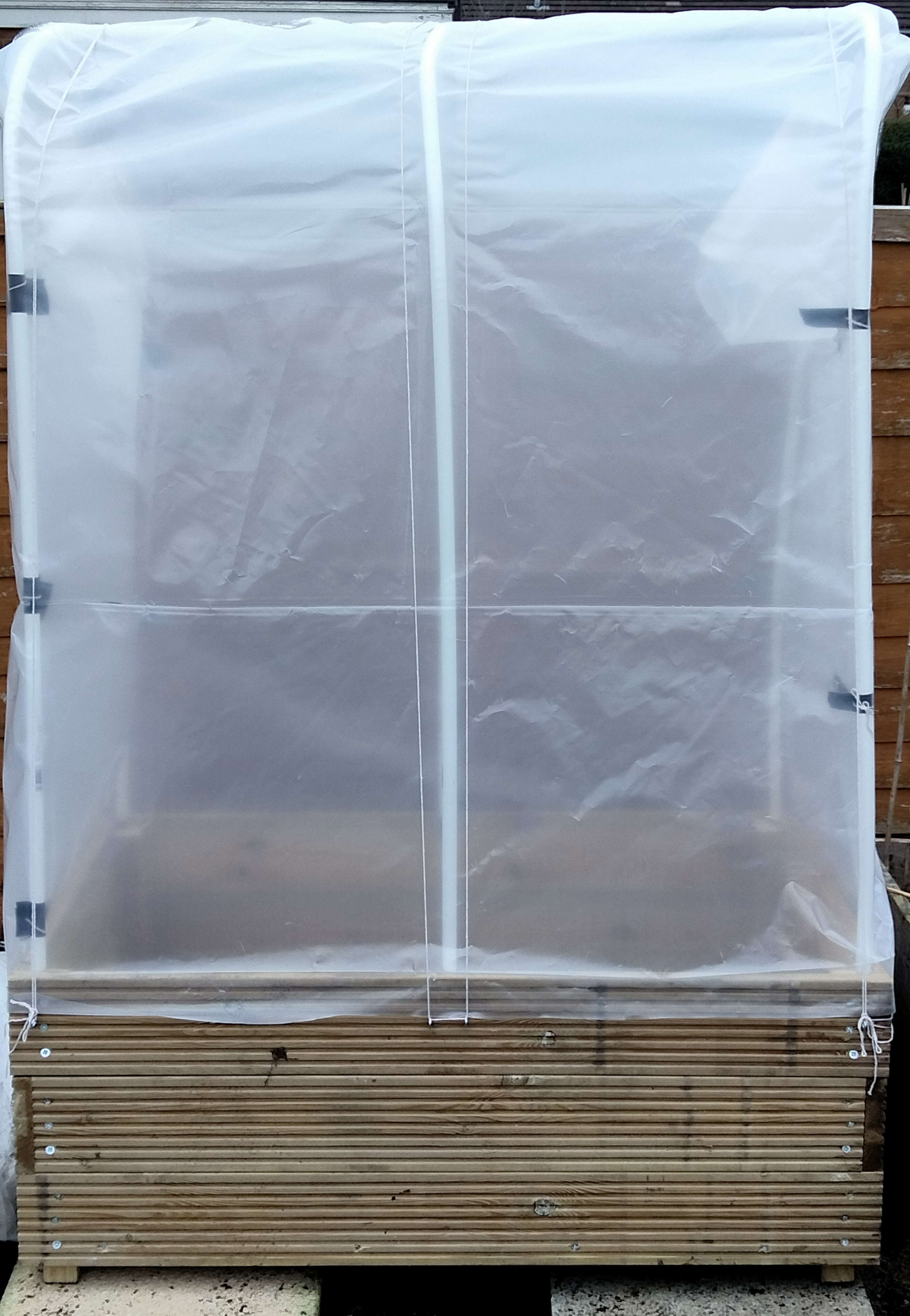

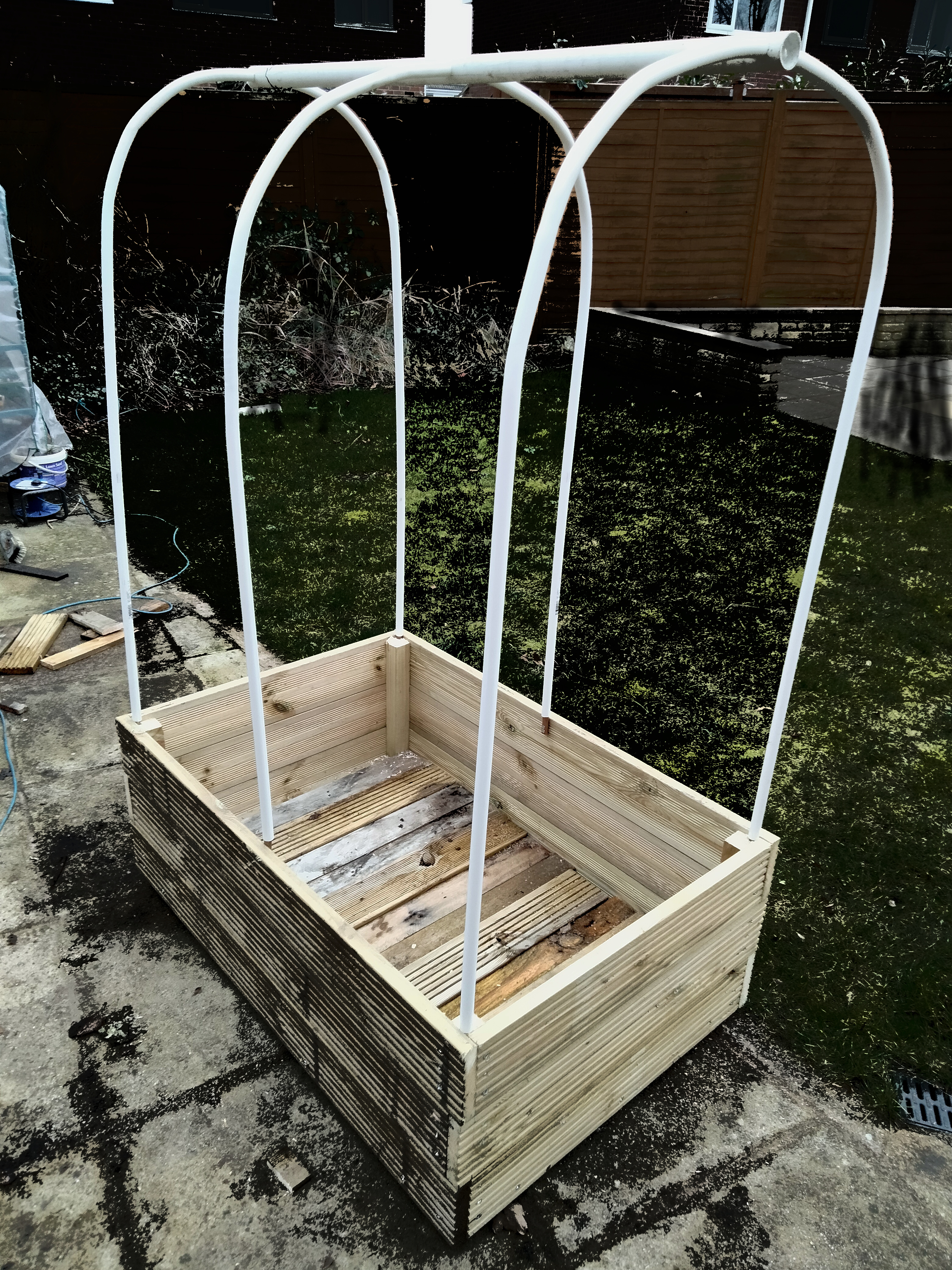

Sorry about the image duplication in the above post. Image handling on the forum is a bit broken for me and i cannot fix the post.
