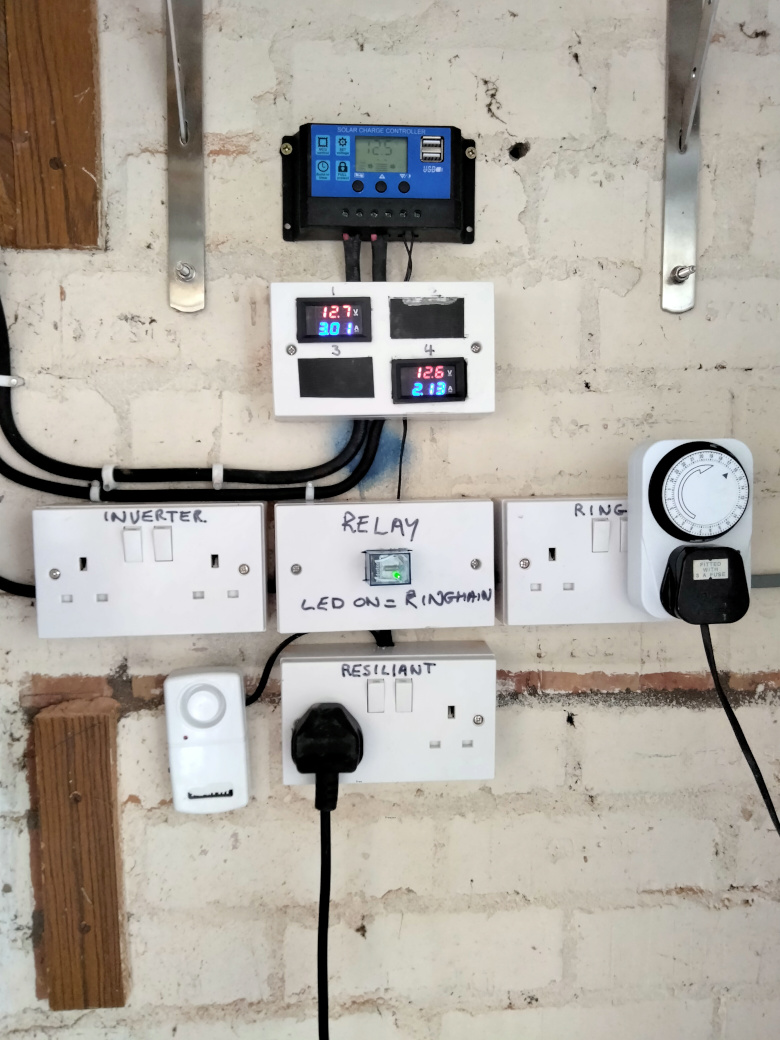

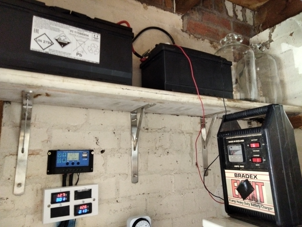

Yorkshire Andy wrote: Mon Aug 08, 2022 7:02 pm Well my old power box project is no more :o
Managed to get the bulk of the heavy wiring done .. ...
You showed me yours so I'll show you mine... :lol:
I finally got my relay and timer arrangement sorted out and bodged together, with a bit of help.

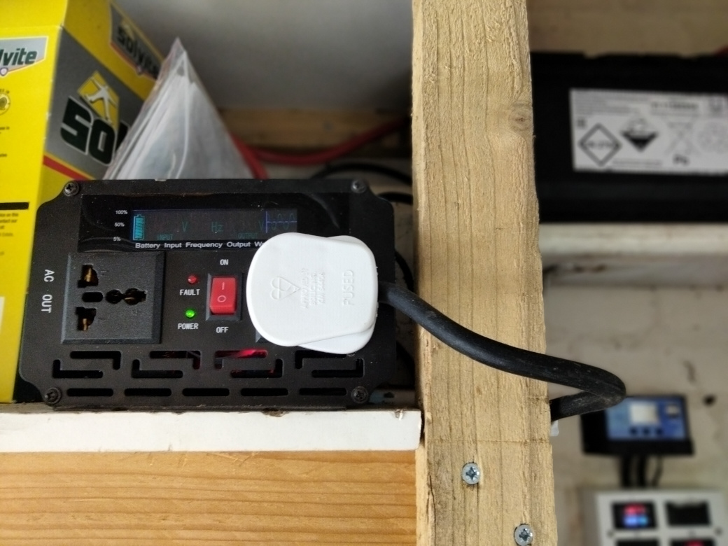

Using a relay and the seldom used timer feature of the PWM controller to switch the freezer to domestic mains by night and inverter mains by day. The inverter runs 24/7. Not under load at night
A simple mains timer powering an 8A battery charger, also by night so the batteries are nice and full by morning
I have a VERY loud mains fail alarm on the 'resilience' output sockets, so if it goes titsup, I can plug the load into the ring main socket, while I sort it out. I can also plug the load (fridge/Freezer) into the ring main if I go on holiday and can turn off the inverter, too.
This will not automatically power my freezer if the domestic mains fails at night.
Time settings will need to be revised throughout the year. There's also a bluetooth battery monitor constantly getting checked.
I did have a lot of help with this.
