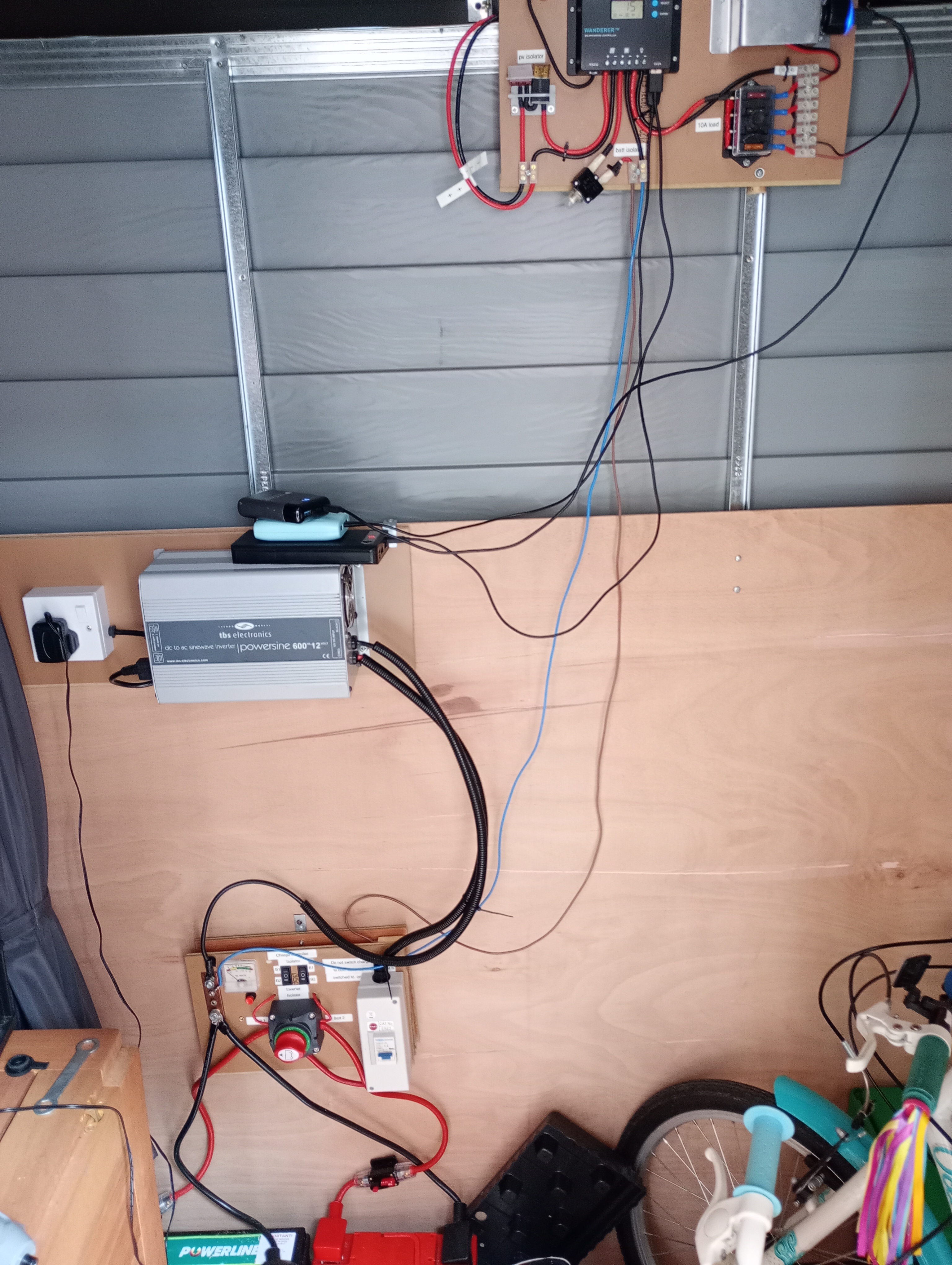

Today I've been thinking about how to rework the small solar setup I put on the shed during lockdown. It's only an 80w panel and a couple of small batteries but has been quite useful for charging power packs and tools; I've also been using it to boil a small travel kettle every day in the week during the summer and every other day over winter.
Apart from the panel, controller, battery, breakers and inverter it was built out of stuff I had lying around in the garage. I'm wondering whether to add a panel or just get a larger replacement as there's not a lot of roof space, and add some better storage.
Still going to keep it small, low voltage and stick with the little pwm controller for now; I'll probably just add another panel first and see what difference it makes over winter, maybe add a proper PV isolator too (and use the right colour wires on the PV side!) ... Oh and bin off the cheap Chinese breakers, they suck.

We have a portable system, a folding 100w panel with charge controller and battery leads, bought for camping,
And a small permanent setup, two 120w panels on the shed (south facing roof) two 80Ahr leisure batteries
with a 30A charge controller, the system is just for 12V lighting and rechargeable devices .

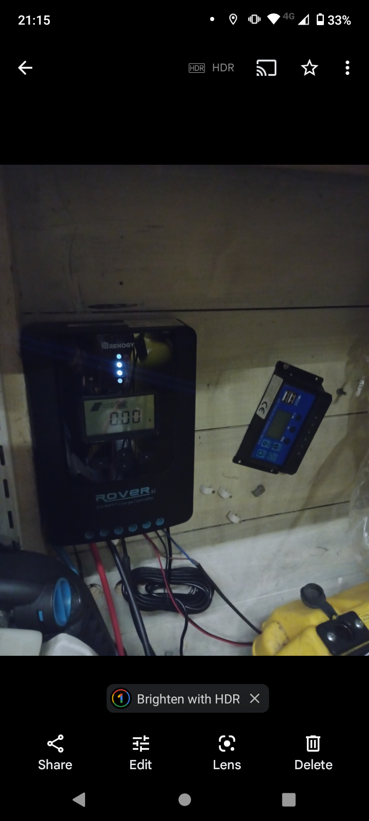

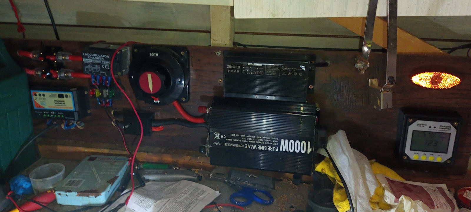

My standby system only has 60w of panels and a pwm 2 way split charging unit that provides standby backup power and the solar keeps two 110ah batteries topped up with a 20a mains charger for cyclic use which gives quick charging in the event of rota cuts..
My daily system comprises of a 300w inverter a 50ah lithium iron phosphate battery 2x 100w panels and a renology mppt .. that powers lighting for the shed the CCTV and a few other odds and ends the 100w just about coped last winter this year with the mppt and extra panel it should give me plenty...
