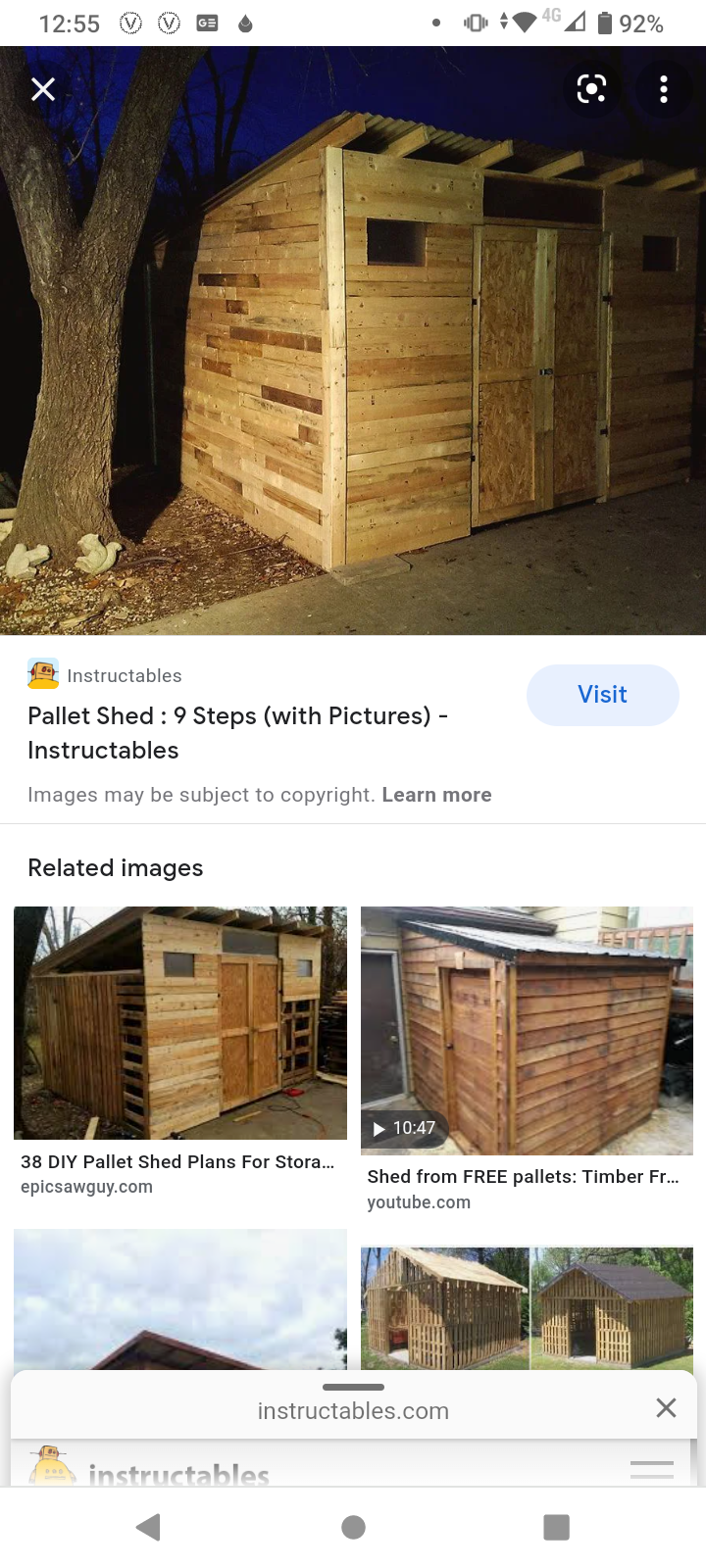

I recently rebuilt one of my sheds and almost all the cladding is pallet boards (your frame can be much lighter for the same security as the planks are quite thick compared with average shed cladding)
All my planting troughs are built from pallet boards, as is Herself's potting table.
Having now had a look on Evilbay, perhaps I should make some pallet breakers up for sale......
Yorkshire: I don't like the look of the roof on the top pic........ Unsupported tin sheet like that is just begging to go flying
