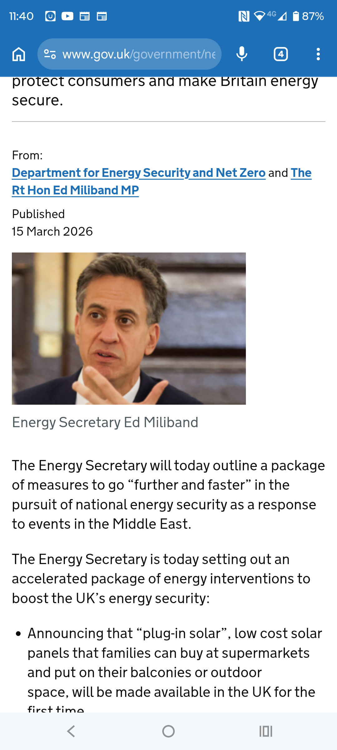

Well looks like the government might actually do it.
Facestalk link to a BBC interview
https://www.facebook.com/share/v/1G8xYp8QUf/
Might be a closed group ..
From dot gov

Yorkshire Andy wrote: Sun Mar 15, 2026 11:31 am Well looks like the government might actually do it.
From dot gov
Gov press release this morning - https://www.gov.uk/government/news/gove ... rgy-secure
