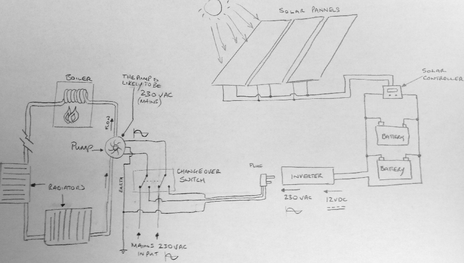

Thankyou - so what about a pump for 7 radiators off a multiburner stove? What kind of load does that take and how the hell do you get it into the pump?
(clueless helpless female here!)
TorNicho
Re: No Heating
The pump power requirements will be on the pump (you may have to find it, I don't know where mine is), I can't see it requiring much more than 200W though.
One way to connect the inverter to the pump is as follows:-

Will show it to the husband
ty xx
