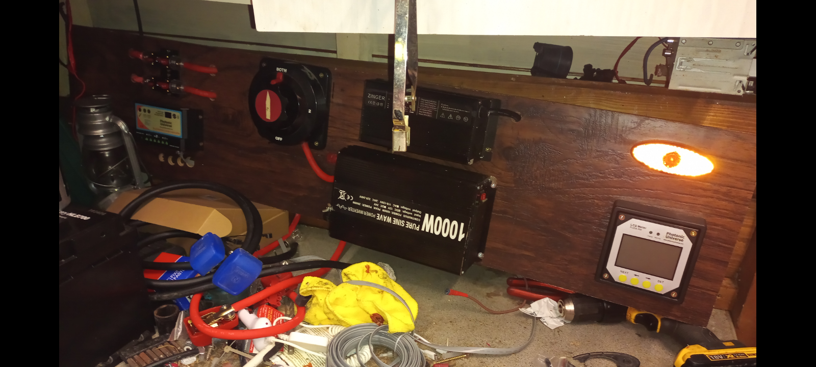

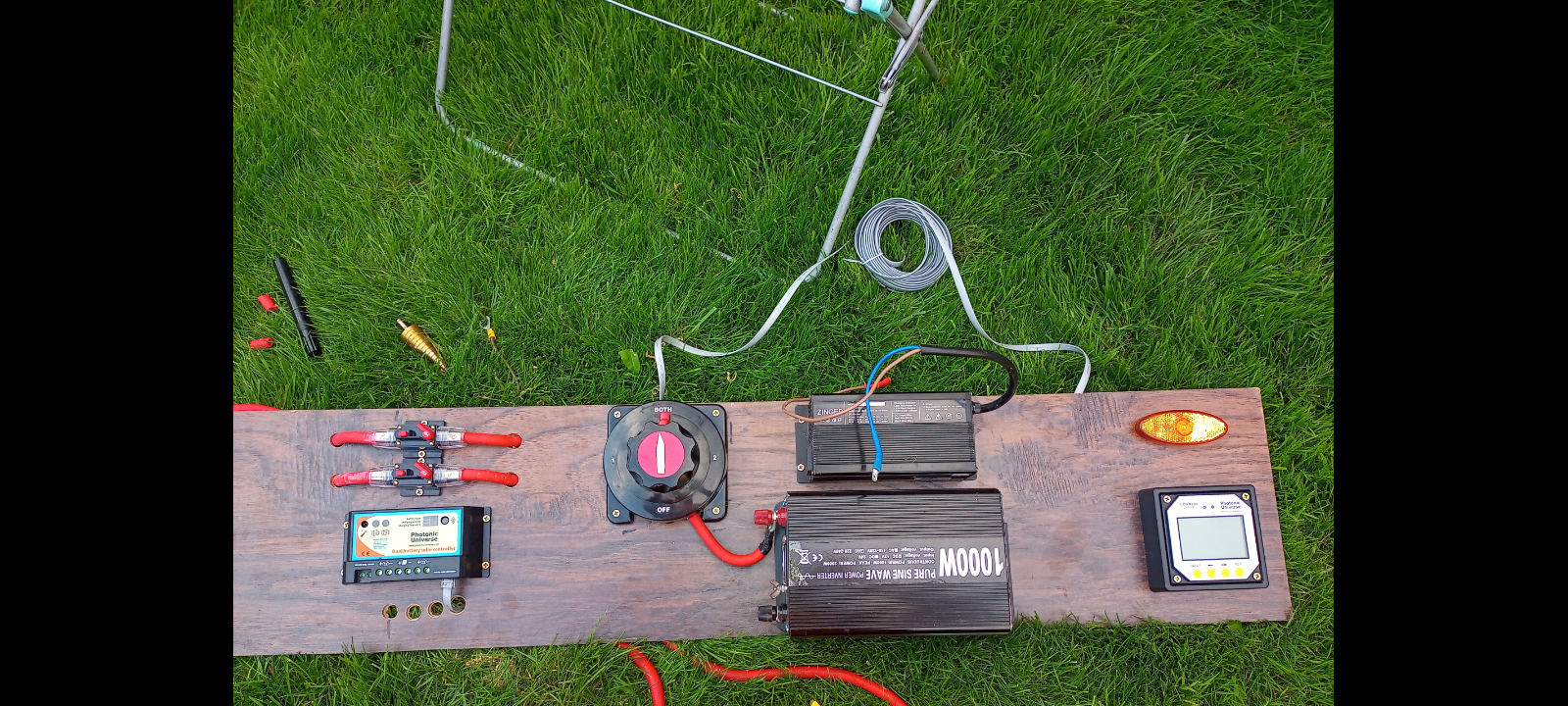

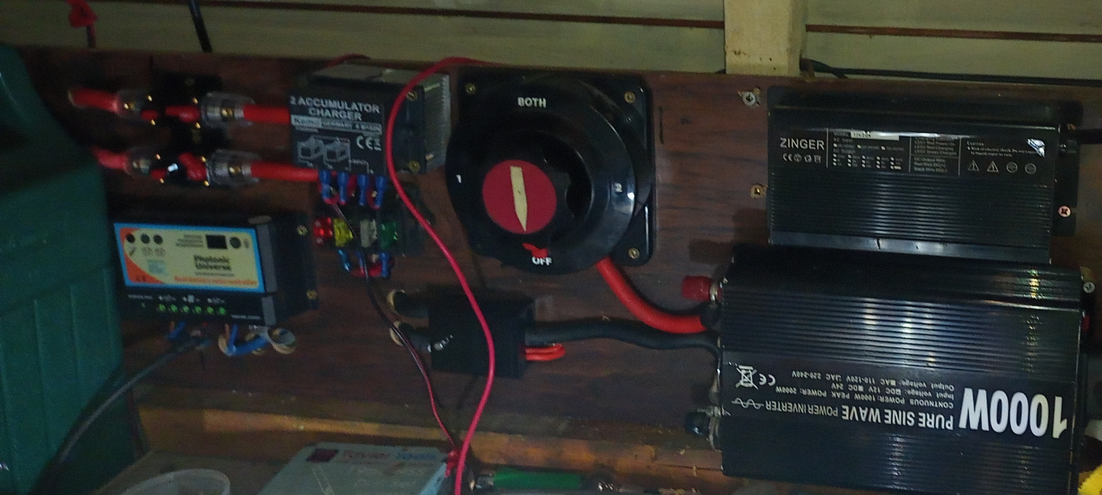

Well storage of the box made it a bit of a pain so it's now become a power wall :lol:
Batteries are in the cupboard below...
New twin battery solar controller
Posts: 4206
Re: Inverter power supply
Nice bit of wood :)
Do I see two charge controllers? or is one just a display?
Did you go 24V?
Ruined a bit by the writing being upside down :(
