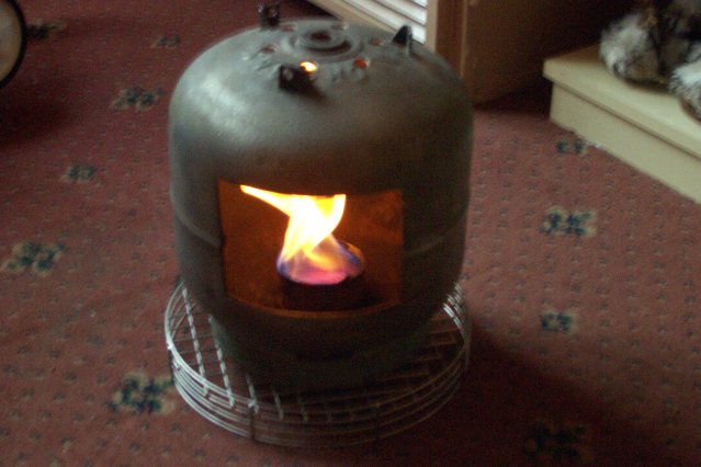

Well, that's the paint burned off, and rather than fit a hotplate I decided to drill some more holes in the top. This lets the flames lick out which will be much better for cooking. The three original tabs on the top that used to secure the carrying handle are ideal for supporting a variety of different sized pans

Very tidy job

Fantastic job, id be tempted to cut off the bottom rung and weld on 3 large old bolts (8-10inch)with rounded heads, just for the aesthetic look of it, 3 legs also makes it easier to keep stable ive found.

I'm not making 'gel fuel'. I buy comercially available 'chafing fuel' that is safety rated for indoor use. Of course I ventilate the room, but to be frank Rik, I've been burning candles and paraffin lamps indoors for decades and have not woken up dead yetrik_uk3 wrote:Take care burning candles, they throw out an awful lot of nasty fumes you don't want to be breathing in if you want to wake up in the morning, make sure to ventilate the room well.

Have you tried cooking or heating water on that thing as of yet? I would have a concern about the temperature being a bit low

The heat output is a little dissapointing using standard cans of gel fuel. Good enough to heat precooked food but I wouldn't want to depend on it for boiling a pan of spuds. I tried completely removing the top of a can of gel fuel with a can opener and the heat ouput shot up, but the fuel burned completely away in about 40 minutes instead of the usual 3 to 4 hours. If a complete circle of metal was removed from the top of the stove instead of just drilling holes and the fuel was raised on an internal base or I found a decent burner design it would probably improve it's efficiency as a means of cooking, but as a means of emergency heating it does make a difference to a cold room. Much better than the 'flowerpot' candle heaters.nickdutch wrote:Have you tried cooking or heating water on that thing as of yet? I would have a concern about the temperature being a bit low
