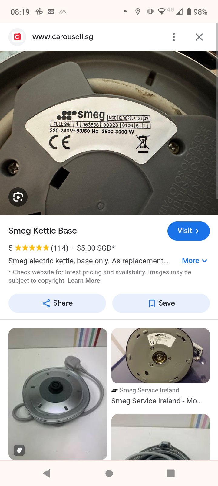

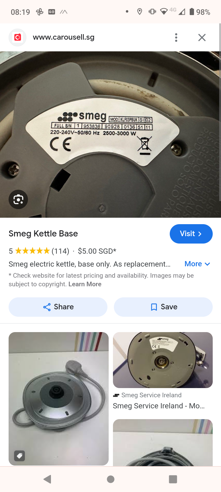

To work out what it'll run you need to look at the appliances ratings plate on the back / base usually you'll find a id plate
Shamelessly stolen of Google :lol:
As you can see a kettle is one power hungry monster pulling between 2500-3000w depending on the voltage as there's fluctuations between parts of Europe so let's say that kettle on average pulls 2750w that's one big power bank required even the average / standard honda eu20i caravaners favourite generator wouldnt power it

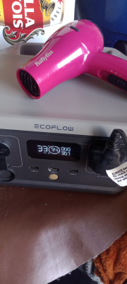

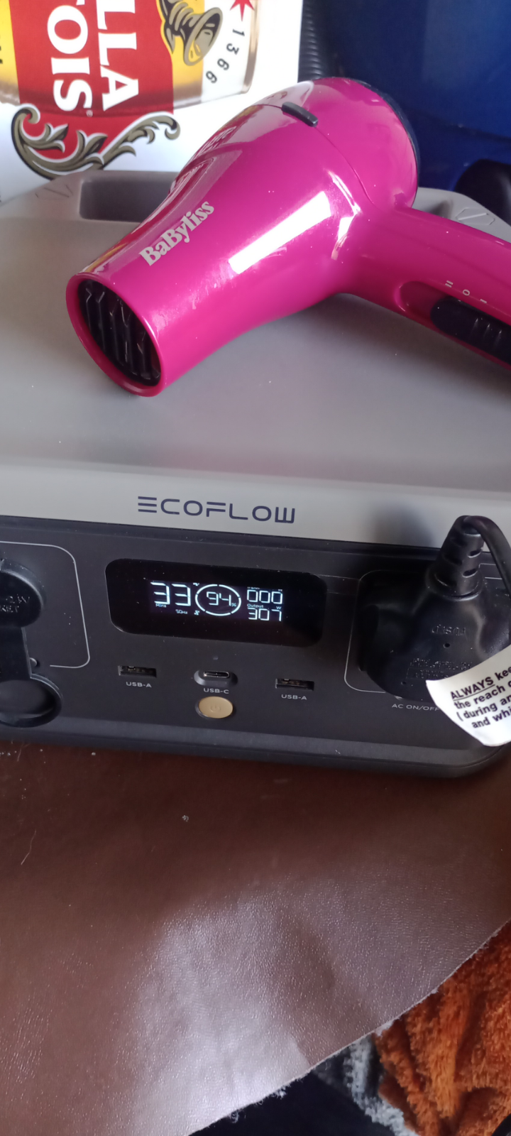

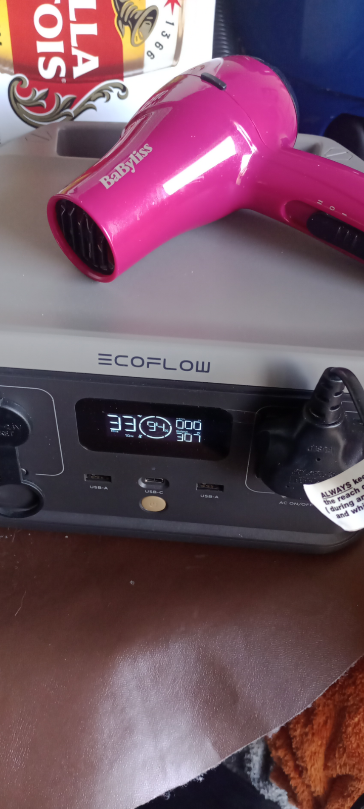

My river is 256wh so a tad smaller than yours but at maximum load of 300w (travel hair drier on setting 1 is 300w) it'll run for just over 30 minutes

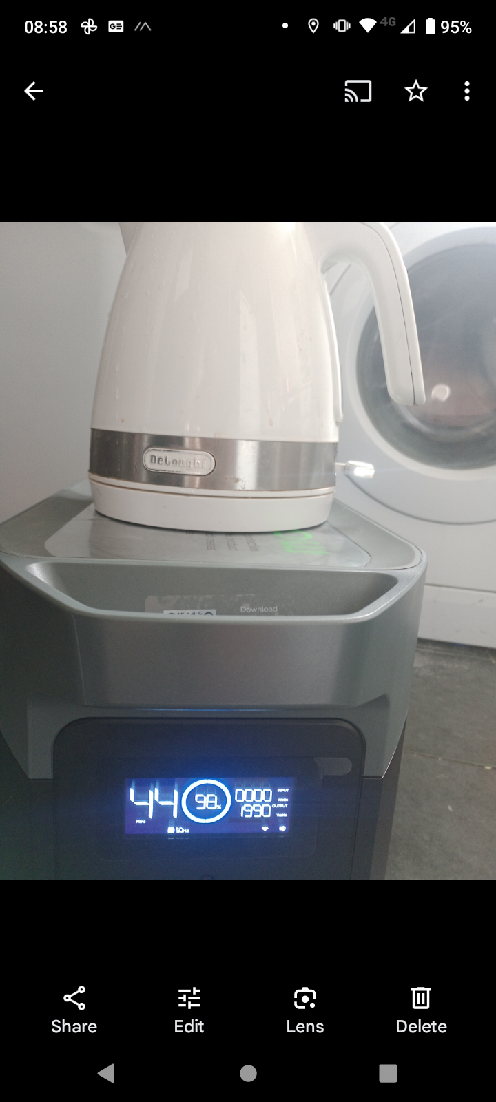

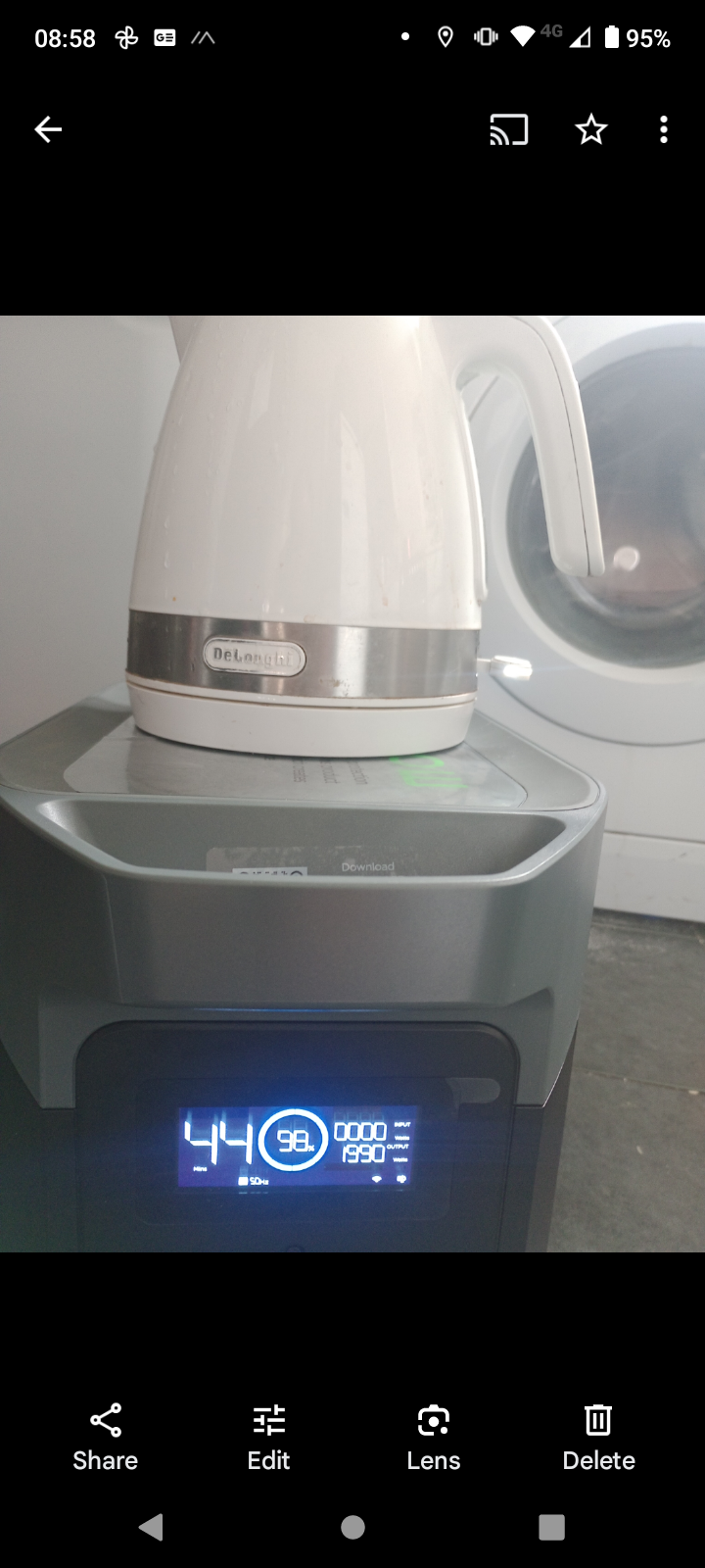

As good as power banks are anything with a heating element is one power hungry beast I'll take my ecoflow delta max downstairs in a bit and see what it makes of the generic kitchen kettle it will run it but it'll soon flatten the battery I have no doubts on that

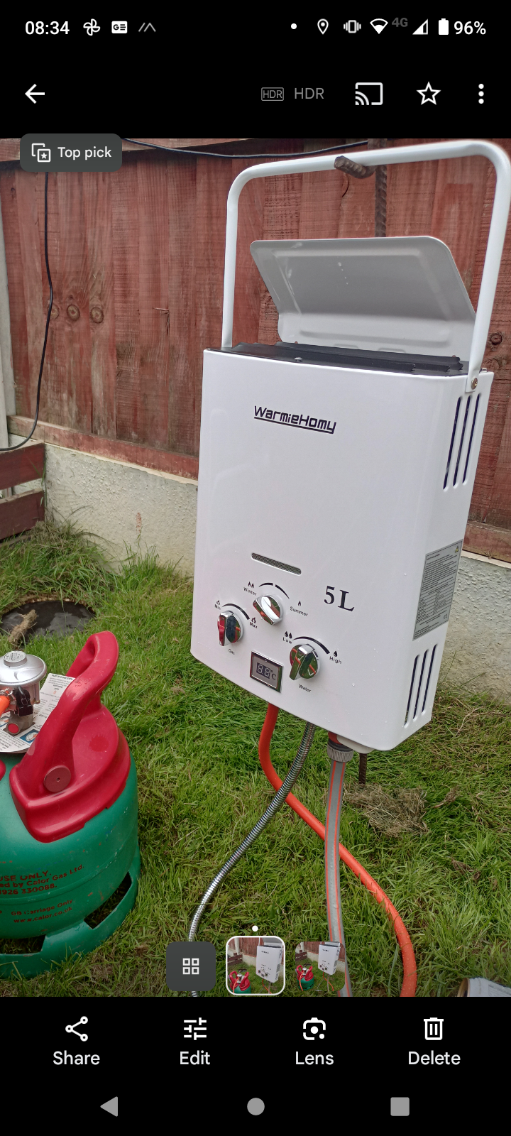

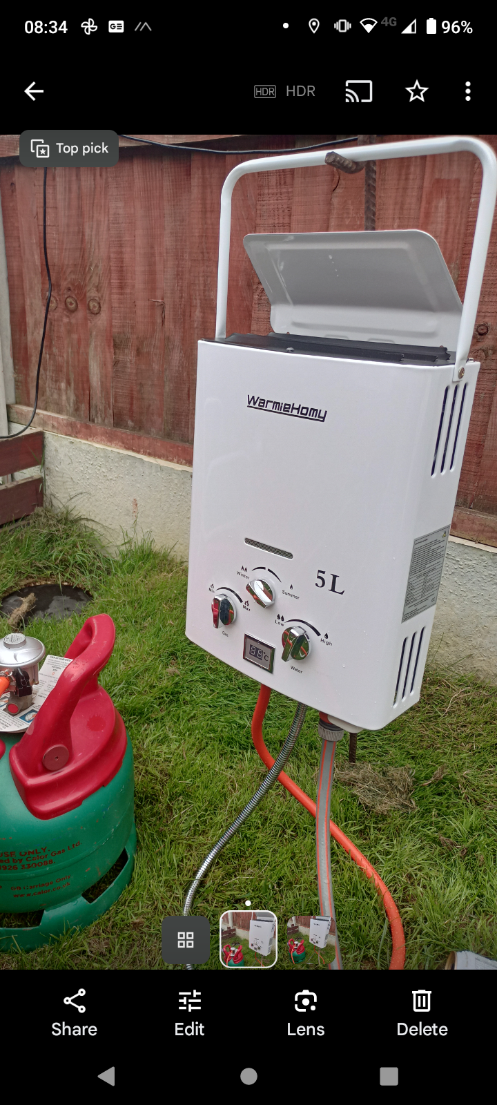

Still think for hot water for a brew you can't go wrong with a jetboil type stove and hot water for washing / bathing one of the compact lpg water ' boilers ". You can buy a lot of gas with close to £1000 :lol:

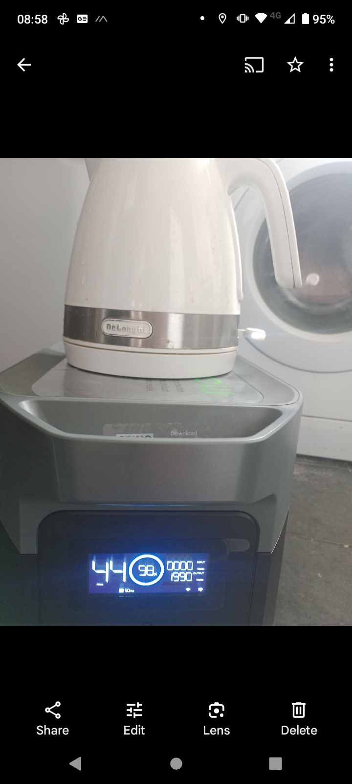

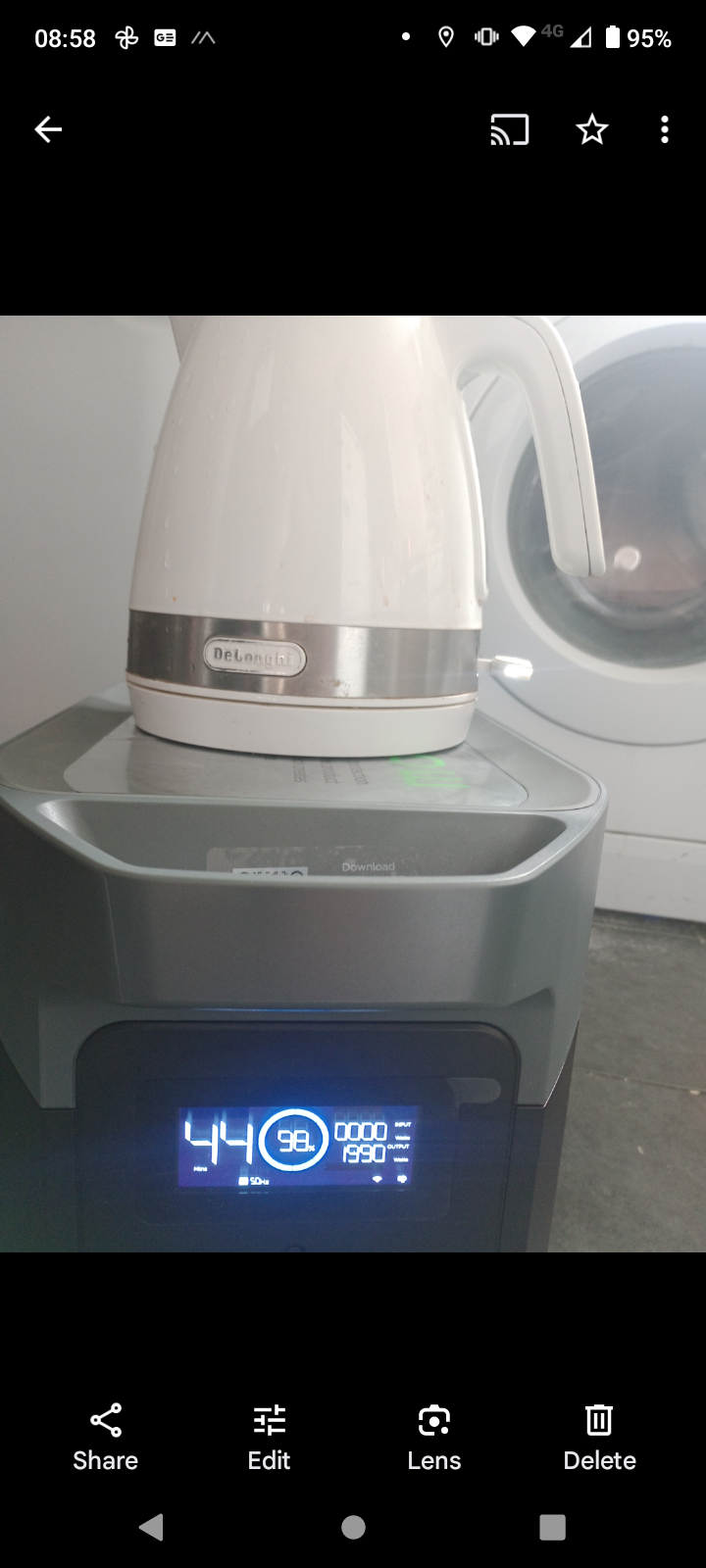

Well the delta max 1600wh was showing 45 minutes run time with a 2500w-3000w kettle then it got upset with the load and tripped out I suspected so much
The 2000w displayed is due to the xboost over drive mode trying to run it (it's cuts voltage to reduce draw)
