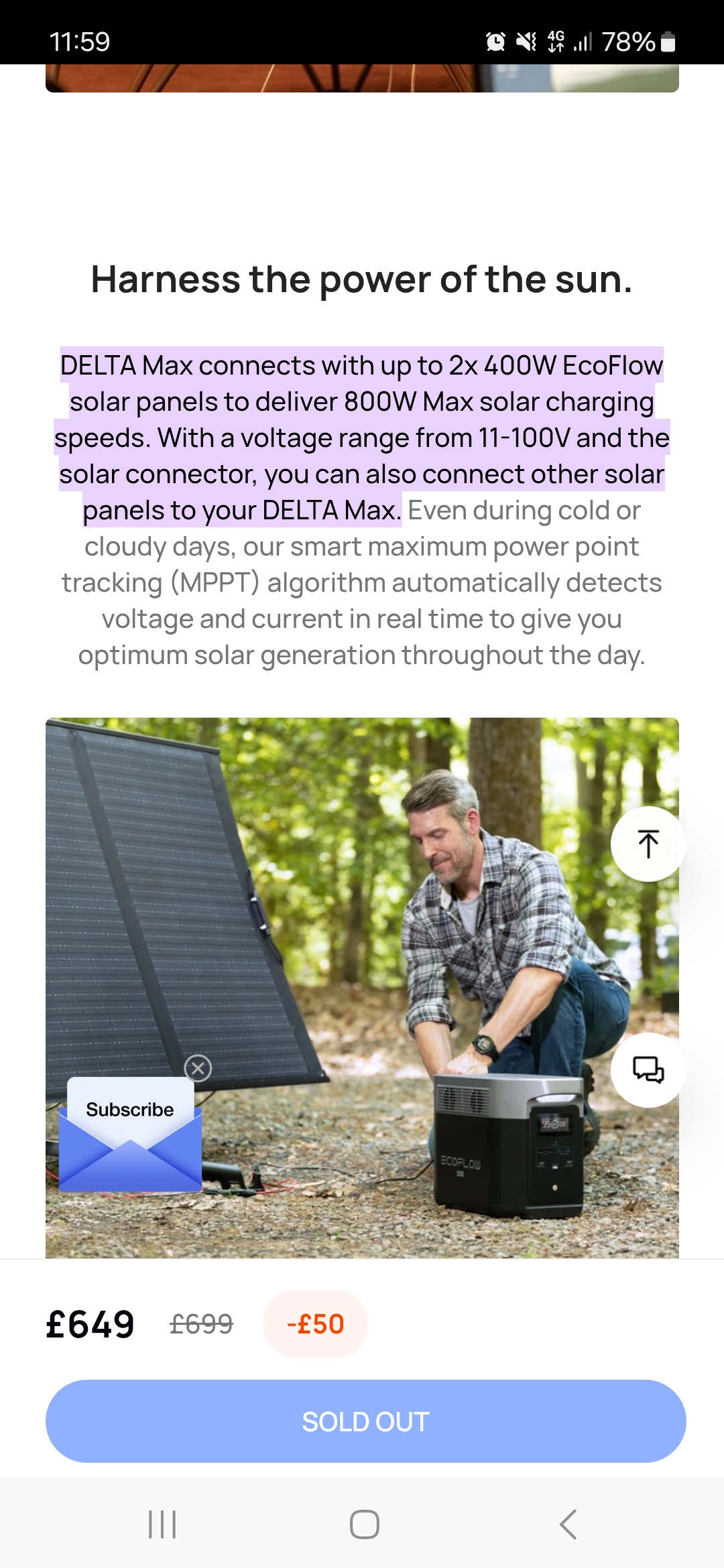

It's voc you need to watch *voltage open circuit *
The maximum voltage that a panel puts out which can damage the mppt charge unit ..
It's fairly common to over watt a charger by an amount as very rare do we get full wattage from a panel ..
Far more detail:
https://www.12voltplanet.co.uk/news/wha ... xCkJlaOLYt
My ecoflow delta max will handle 100v input
The jackery look to take a much lower voltage but they don't make it clear
