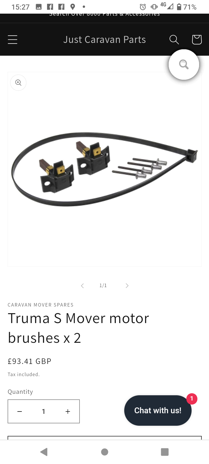

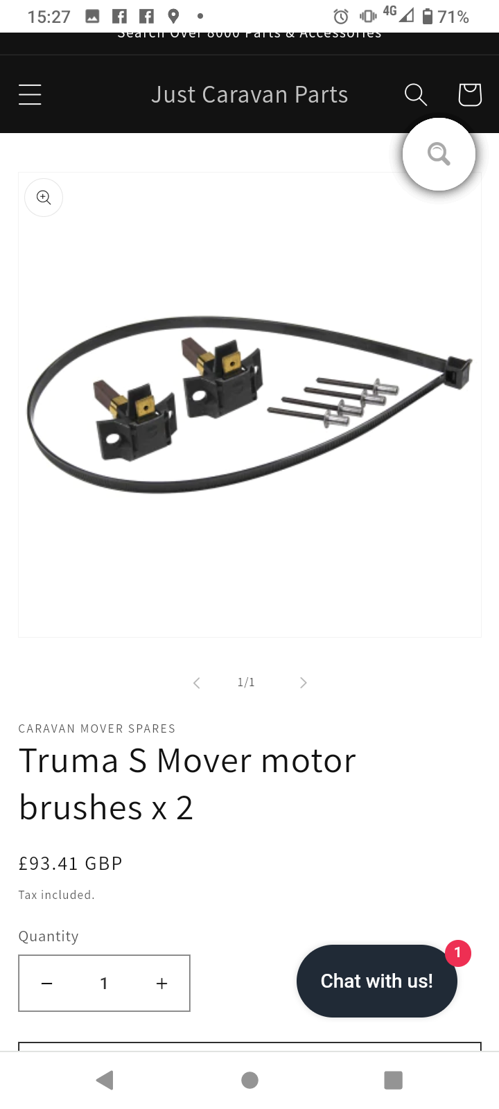

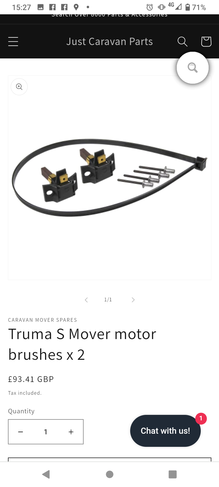

Had my Bosch 60w folding solar panel out today having spent 2 hours having had a battle with my parents caravan motor mover it soon banged charge back into the battery
Sometimes been "handy" saves a few quid having been parked up since before the China flu one motor didn't run despite been stored in the garage it had corroded badly and the motor brushes had stuck in the holders...
Bit of care saved my parents thick end of £100 plus what ever labor the caravan engineering chap would want
They cleaned up with a bit of wet and dry and a bit of light grease
