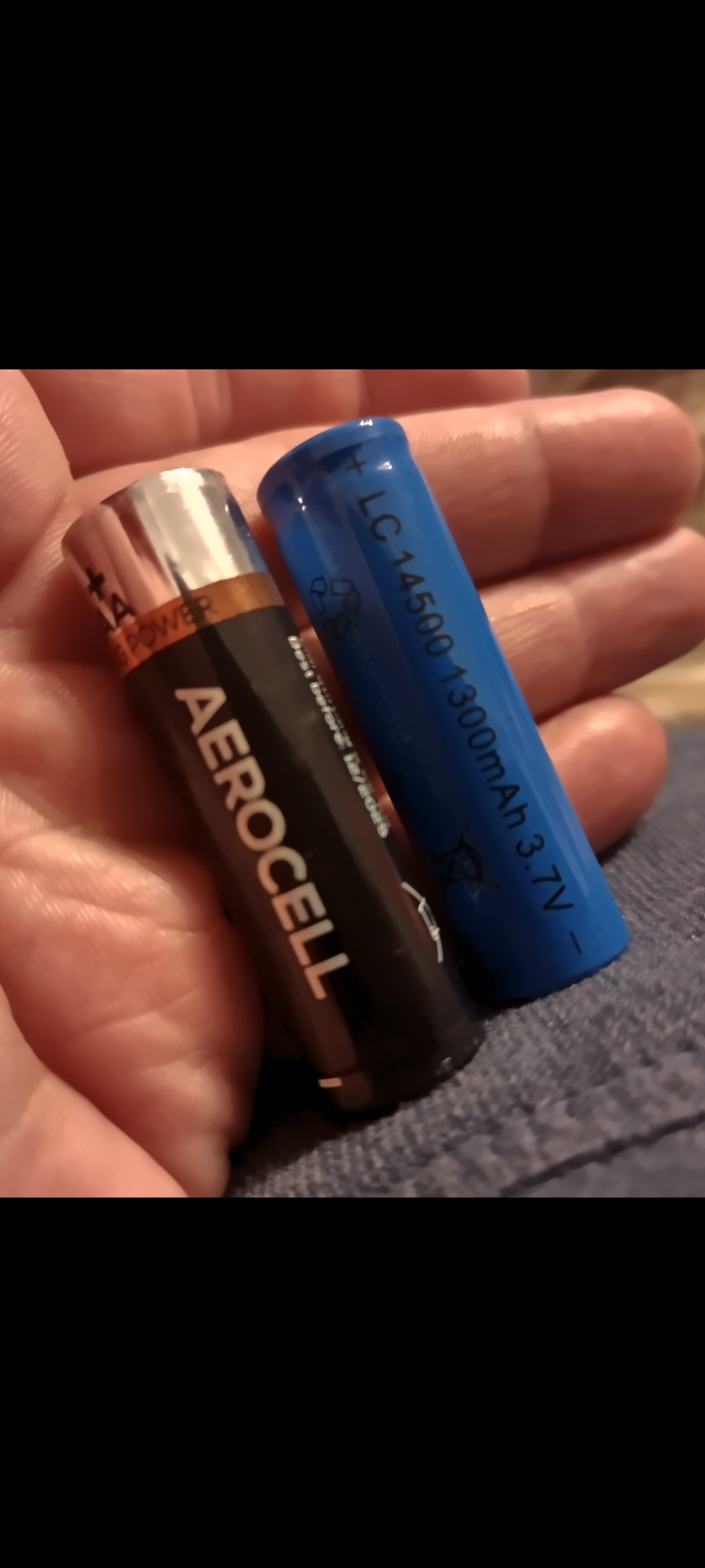

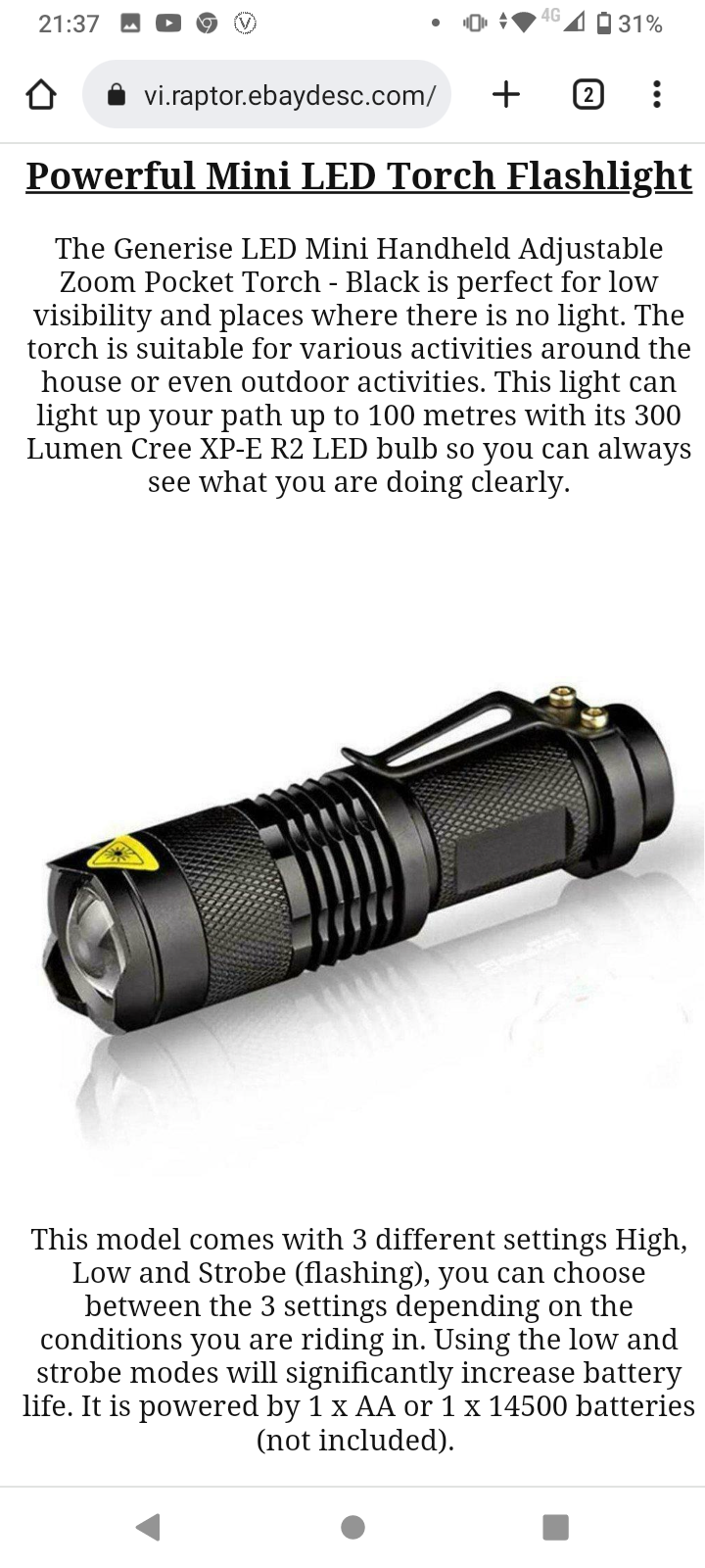

These little jobbies plenty of suppliers before the blind panic over winter cuts I got 5 for £12 ISH ...
Popped into a vape shop and bought some 14500 batteries well what a difference Vs a standard AA

Yorkshire Andy wrote: Sun Nov 06, 2022 9:42 pm These little jobbies plenty of suppliers before the blind panic over winter cuts I got 5 for £12 ISH ...
What takes 14500s?
Similar wattHour capacity? What are you going to do with them?
Posts: 9971
Re: Small/cheap equipment
jennyjj01 wrote: Mon Nov 07, 2022 1:03 am

The little edc torches they run on bog standard AA 1.5v or 14500 rechargeables which the pic above makes them chuck a lot more light out
Wh = mAh × V / 1000
So 1300x3.7/1000
Gives 4.81wh
