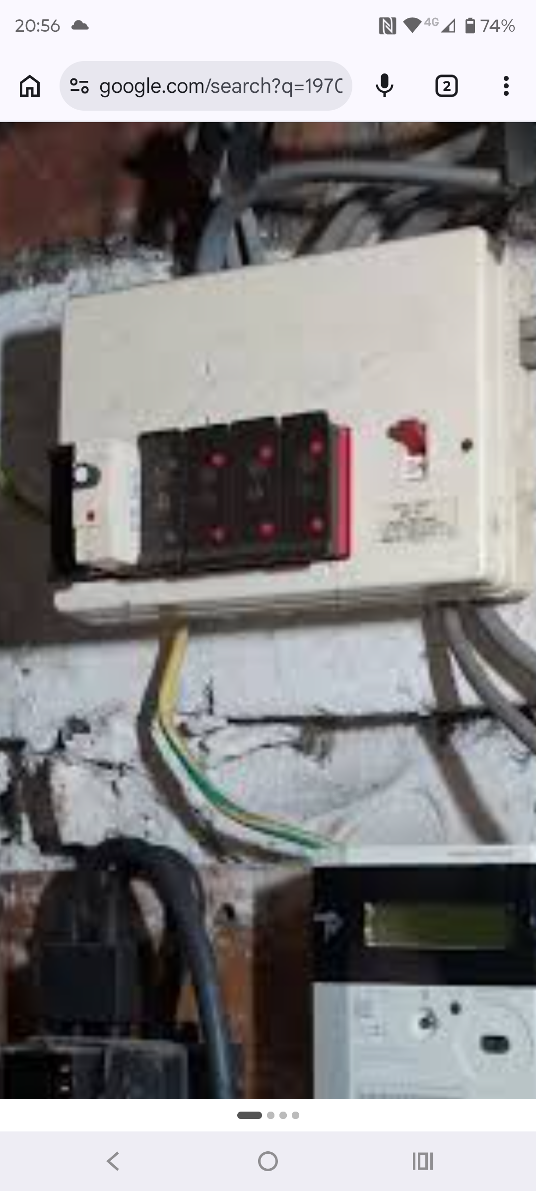

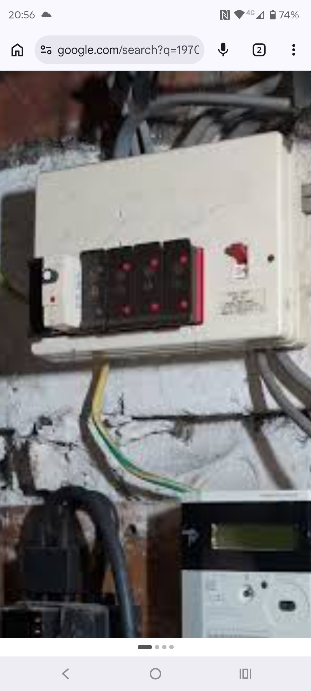

It transpires that my CU isn't really up to the job. It only has one free slot, is of 70s vintage and does not feature earth leakage trips, which he strongly recommended. It's barely better than an old fashioned fuse box. Also the way the garage is wired in is outside of regs. Before he would replace the Consumer Unit, he would do an earth leakage test on all circuits. Gord knows where that leaves us if anything fails ( which would not surprise me)

Yeh erm 1970s vintage I'm guessing that's the realms of old wylex bakelite type board with probably 1990s upgrade with plug in circuit breakers
Something like this
Posts: 4318
Re: Home Solar System
Maybe a tad newer.
