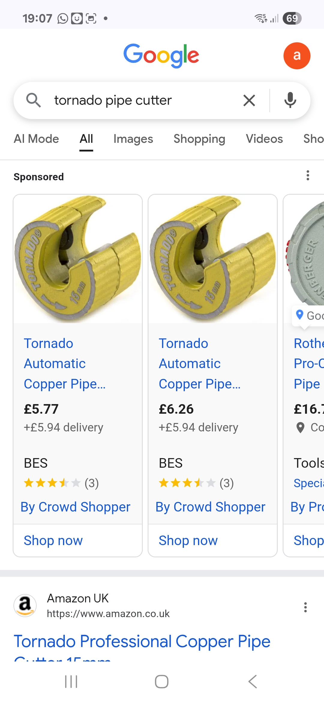

Why i stock some 15mm and 22mm speed fit isolators and rotary pipe cutters shtf..
Cut pipe and bang a isolator on then shut the valve.. Big escape of water for a few seconds then capped securely till a man can turn up
I have these cutters in 15 and 22 mm
Not the best but for occasional use I've no complaints
A length of 15mm and 22mm per plus end inserts and a few in line / bends connectors and threaded adaptors to get stuff working in a problem. And a few spare flexi tap fittings
