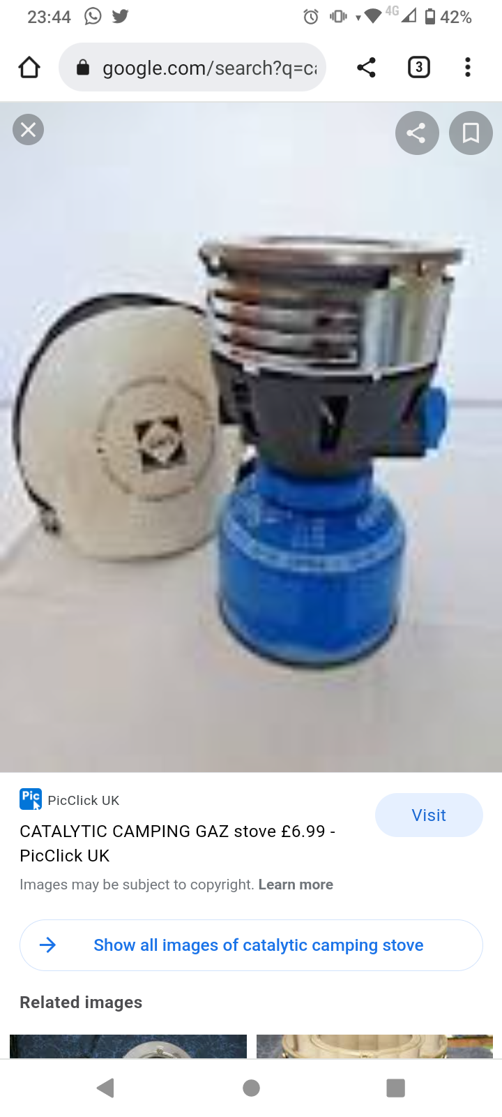

Look at a jetboil or similar you can take it to the pavement and boil water in minutes fill a flask then take it home...
Camping gaz did do a catalytic camping stove years ago technically there was no flame it just got hot... But they discontinued it
