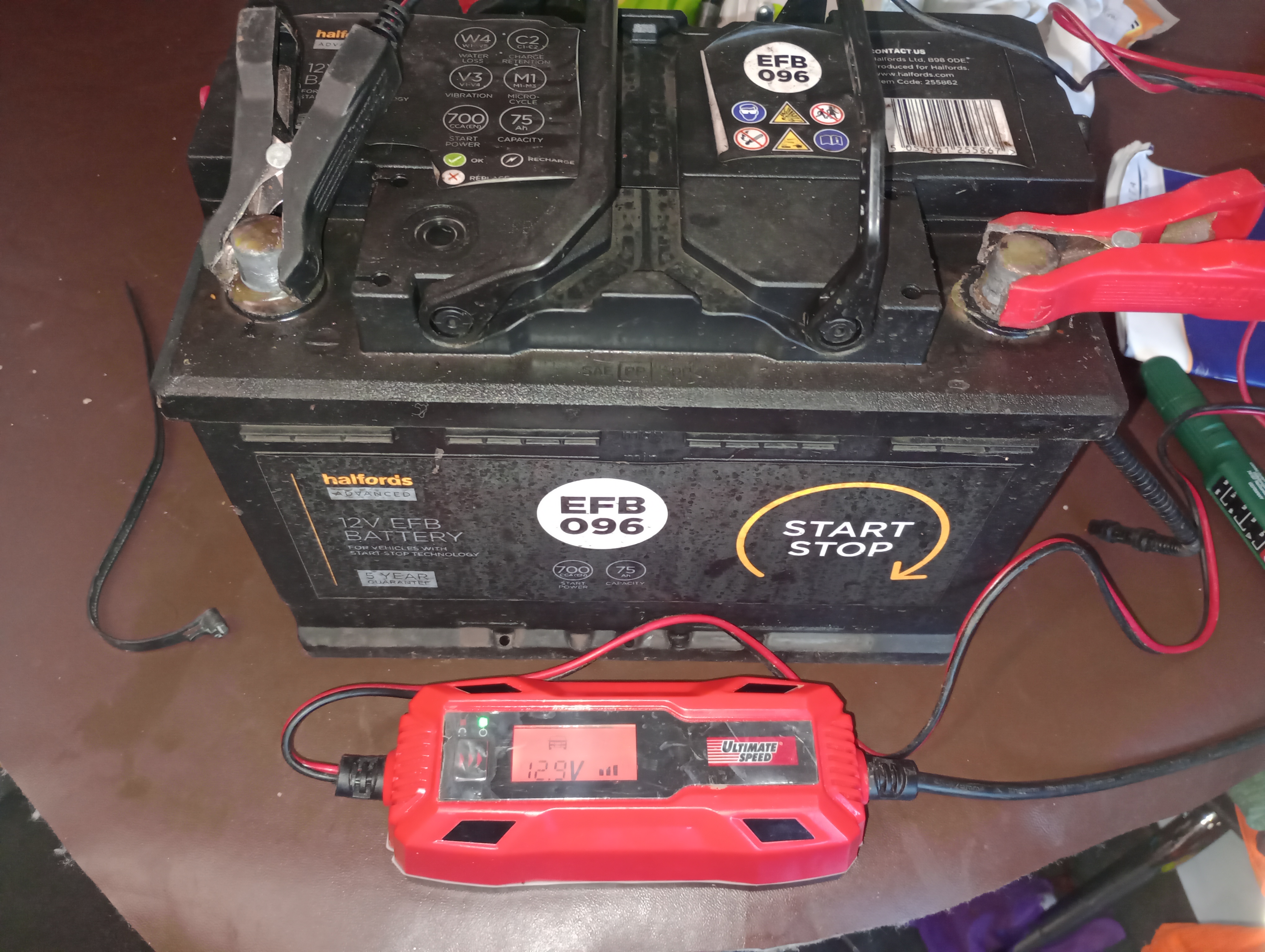

My tester showed my battery low on charge but healthy and it needed charging ...
So this morning I got the pwm charger out on the kitchen table..

Yorkshire Andy wrote: ↑Sun Oct 15, 2023 8:12 am My tester showed my battery low on charge but healthy and it needed charging ...

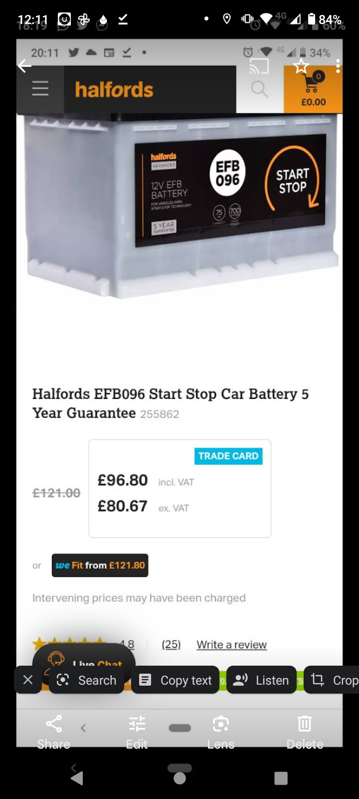

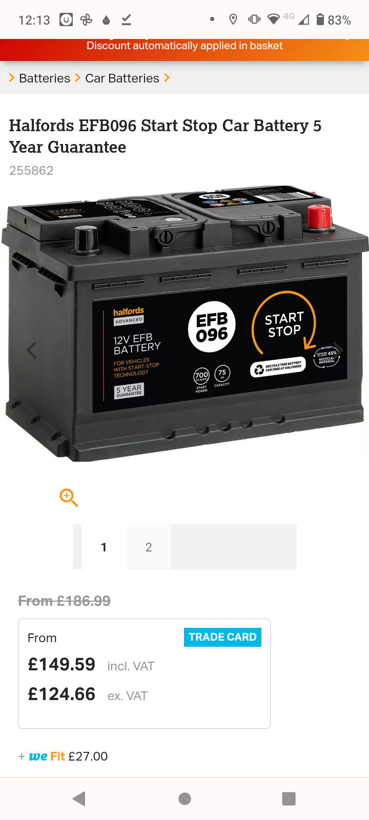

We I tested it after charge and it's not happy... So jumped to the internet a efb096 battery in Halfords 5 years ago just out of warranty typically :evil:
Then:
Now
Found a replacement on eBay form one of the better online supplies for £110 near as makes no odds
The car still starts but I know it sounds "sick" the digital obd gauge drops to about 9v when cranking.....
Rather than wait till my car won't start at 6:30am on a cold dark morning I've ordered a replacement .... Mate of mine waited 8 blooming yes eight hours for the aa this weekend... Begger that for a game of whatever ;p

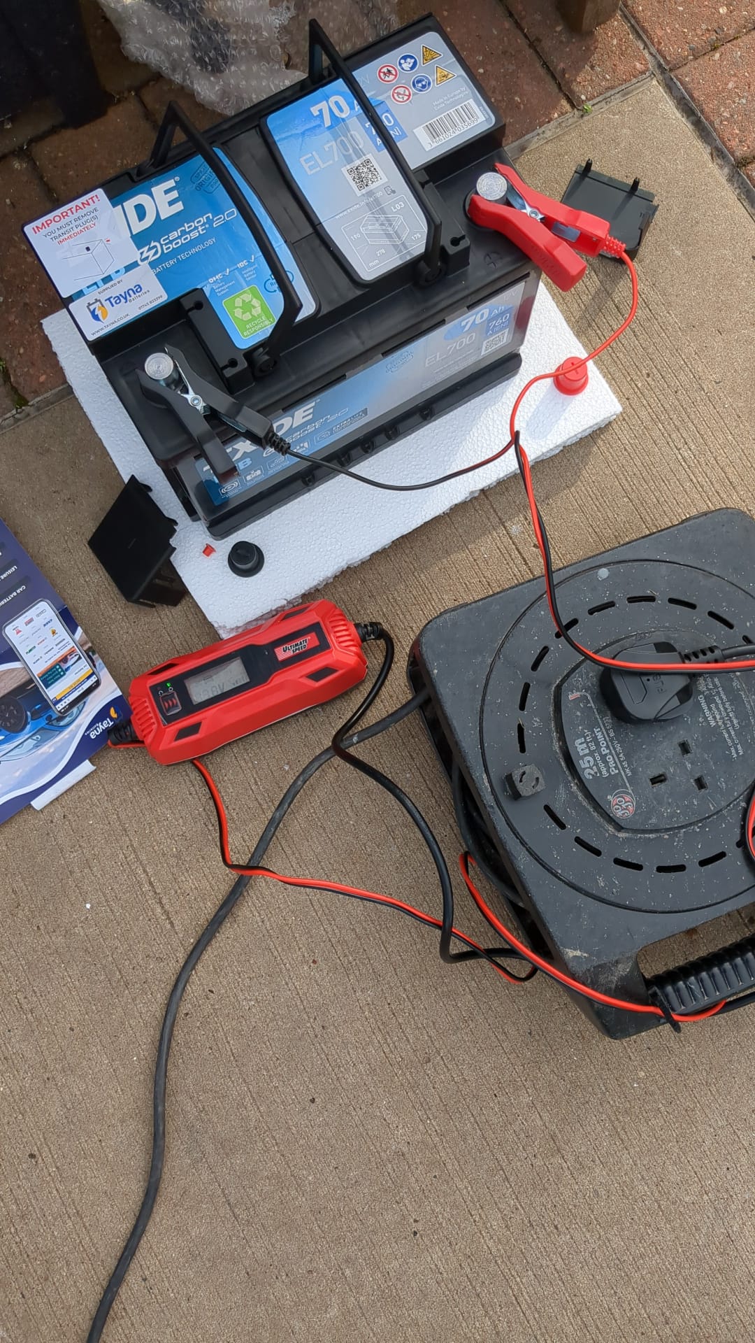

Well new battery was bench charged by my apprentice today after delivery (aka dad) :lol: as I got there tonight it came up fully charged on the charger display .. left it 30
minutes after removing the old battery to allow the bcm module to clear and left the fully charged battery disconnected from the charger to let surface charge disapate (car has stop start eco hippy system so this is the procedure ) refitted battery after cleaning the battery tray and applying wax oil type stuff to the tray whilst the battery was out ...
Fitted the battery and wow it starts almost instantly you turn the key for the last few months it was taking a couple of cranks to fire up...
So happy car poor wallet :lol:
