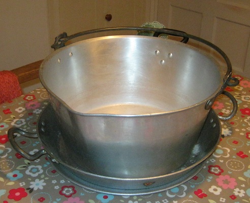

jam kettle.jpg (76.4 KiB) Viewed 1908 times
Thanks for all the comments - really helpful. Sounds like I can safely suspend it above the fire at least! Have attached a pic... in my ignorance - how do I tell if it's pressed or cast? It also came with the large shallow pan underneath and it's all sitting on the lid, which is just a disk which fits on top. My find of the week! :D
12mp82
Posts: 953
Location: outside
Re: Jam kettle / preserving pan / Dutch oven question?
Post by 12mp82 »
looking at that picture it is a pressed one, and looks quite thin aluminium compared to a cast one.
tigs
Posts: 1350
Location: south yorkshire
Post by tigs »
the best way to tell if its cast is weight cast iron is really heavy also its a dark colour often black . take a look here http://www.dutchovens.co.uk/
