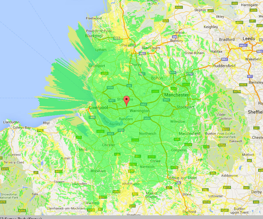

You actual radio needs are "interesting". The range you get depends heavily on location. A 2 metre radio signal might be heard only a few miles away if you are in valley or heavily wooded area. Stand on a hill top and you go further. use a simple hand transceiver with its standard antenna and you will not get far. Attach it to a magnetic antenna on your car roof and you will get further. So how far is a difficult question. In THEORY you can get a long way
Repeaters are not really an option for a crisis as they are usually mains power supply dependent.
Attached is a computer generated estimate for 2M coverage from a high point on the M62 between Liverpool and Manchester. From that point I reached N Wales 40 km away using 5 Watt handheld but with a car roof antenna. On the other hand I can struggle to reach across the town where I live.
