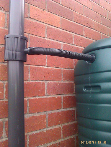

Can anyone post an easy (words of less than two syllables) tutorial of how to fit a water butt and the tools someone would need in order to do that? I think that would be really helpful.

You need a fine tooth panel saw
You water butt and diverter kit
https://www.diy.com/departments/floplas ... 0wod0wIFxA

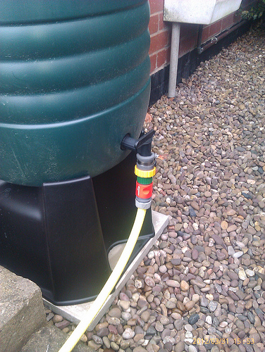

Ideally a flag stone to stand the butt on
Stick water butt close to a down pipe
Use a spirit level ideally to line the butt inlet hole with the drain pipe
Carefully cut out the inlett hole on the butt and fit the hose retainer I used a "tank cutter" on the drill but a sharp knife can do it
Now the "difficult bit chop the drain pipe to fit the diverter you might need another pipe clip or 2 to support the drain pipe
Think I cut about 1" out if the down pipe the diverter pushes into the bottom part of the pipe and the plastic trim slides onto the top part then the top sits into the diverter and the trim holds it in place
When it rains the water runs down into the diverter which shoves it into the butt when full the water goes down the drain...but it must be level if the butt is too high it won't fill too low and it will overflow
