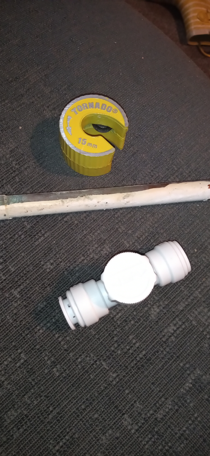

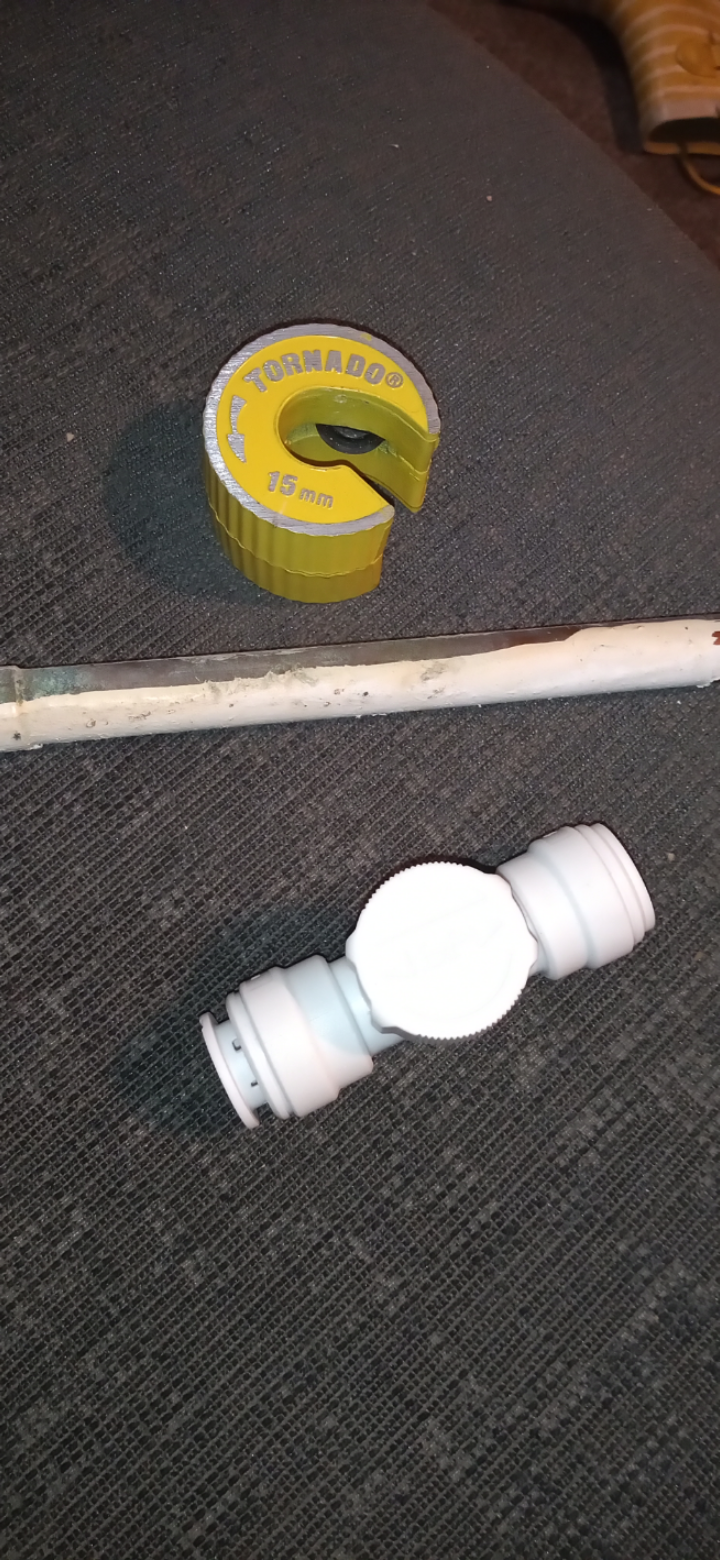

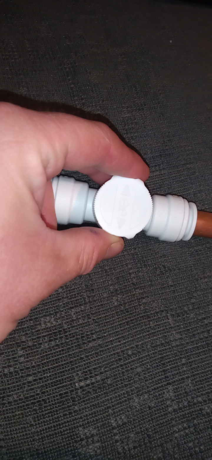

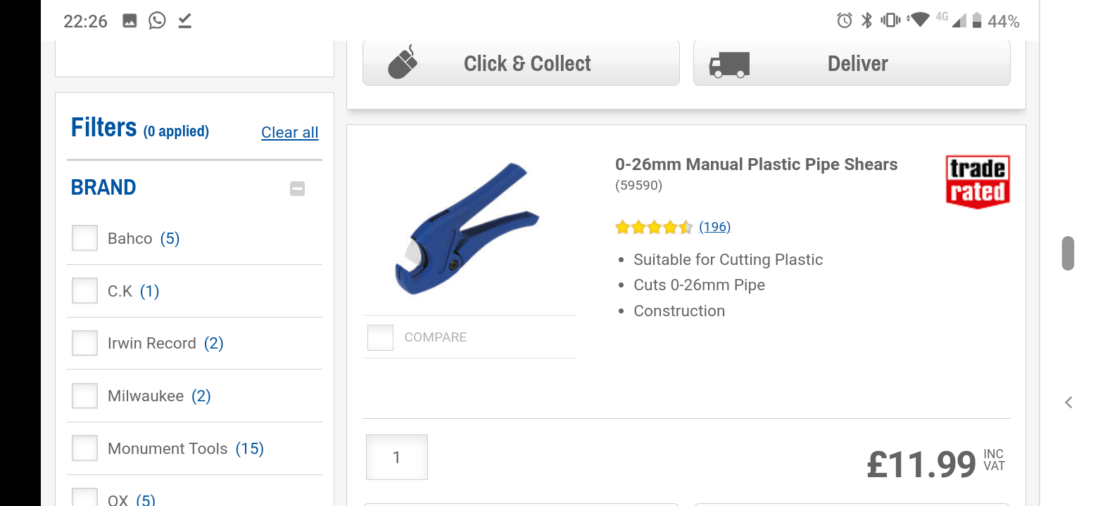

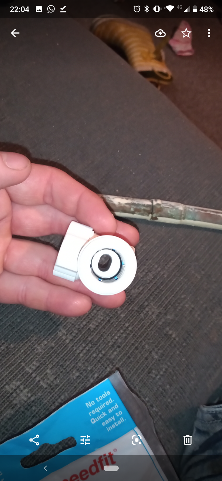

A few tools are needed most are cheap the 15mm pipe cutter cost me £6 the 22mm is also £6 (well £5.99 if your going to be pedantic) and a push fit "service valve" £5 ISH each for both 15mm and 22mm this is a minimum kit so £22 ISH for 4 items and a £1.50 scotch pad ideally

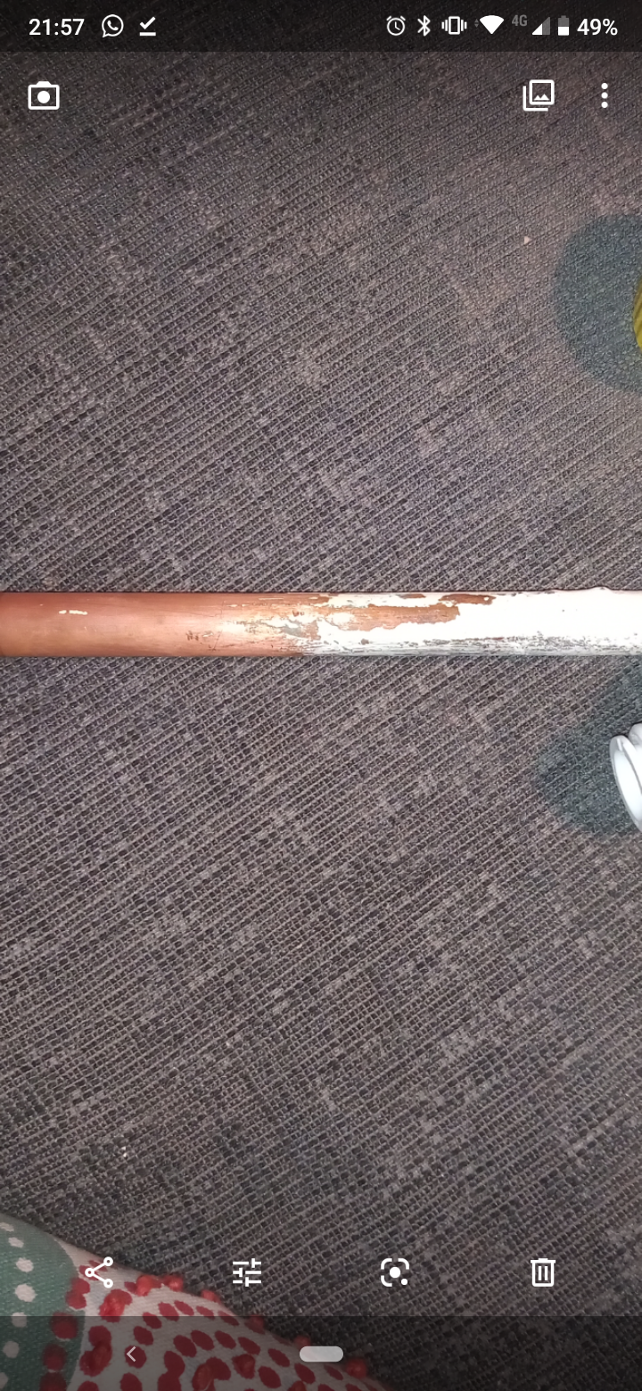

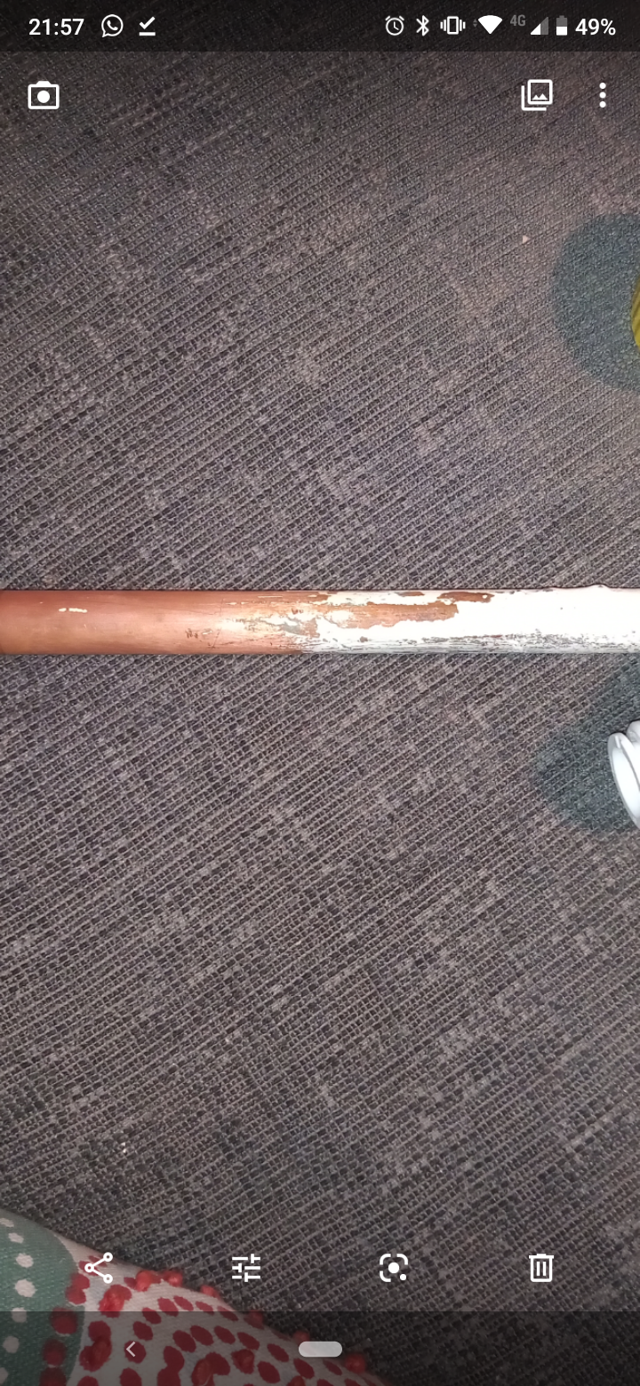

Use the rough scotch pad (car shops sell them for removing paint get the corse one (red) to clean the pipe on the supply side of the pipe
Nice and shiney :mrgreen:
You need to be about 2" ideally 6" from any joist on the supply side you will see why ... And have the ability to cut about 1 ft from the outlet end
Now pack the area with towels / blankets / whatever is to hand.....

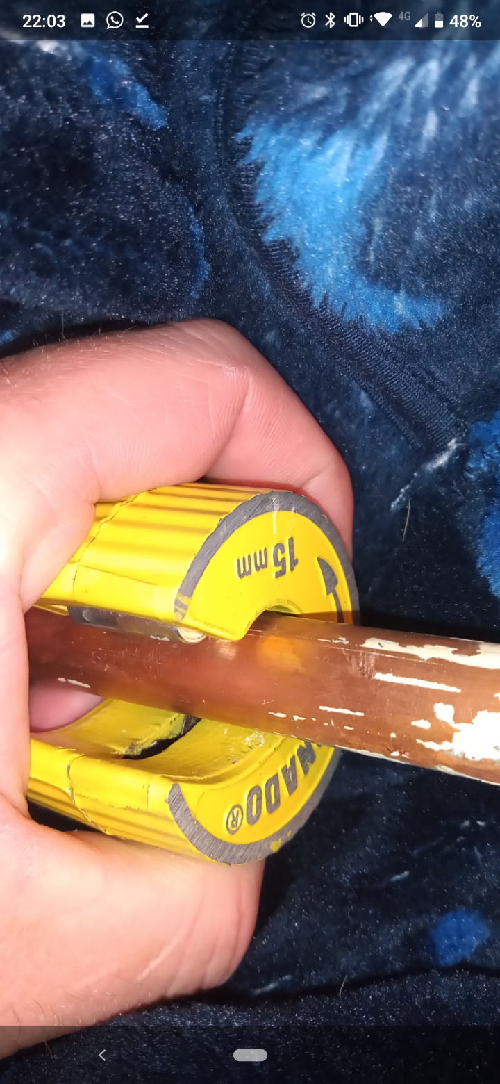

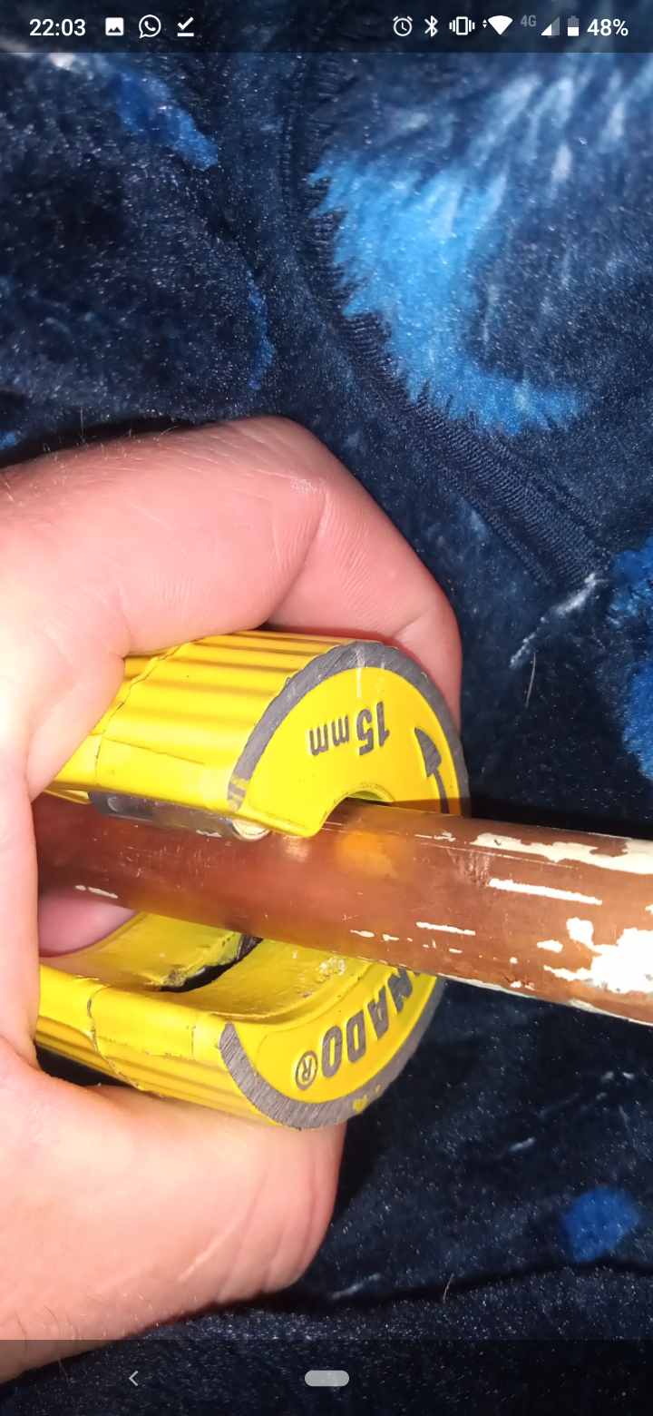

and slip the pipe cutter on the pipe and rotate it smoothly in the direction of the arrow continue untill it cuts the pipe fully

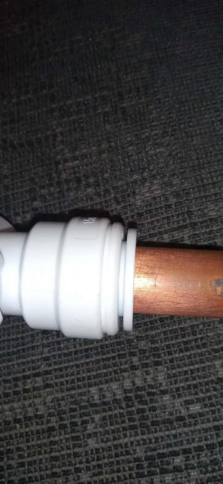

I like the fixed size over the adjustable ones for emergency work ensure a minimum of 1" clean copper on the supply side and have the valve to hand with it open !
Why? Try shoving that on the pipe against water pressure :lol:
The pipe once cut needs the outlet end moving out the way either brute force bend it out the way or make a second cut to create space....

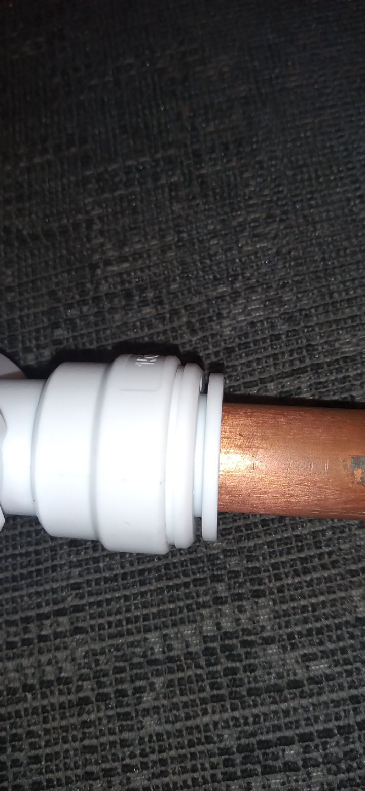

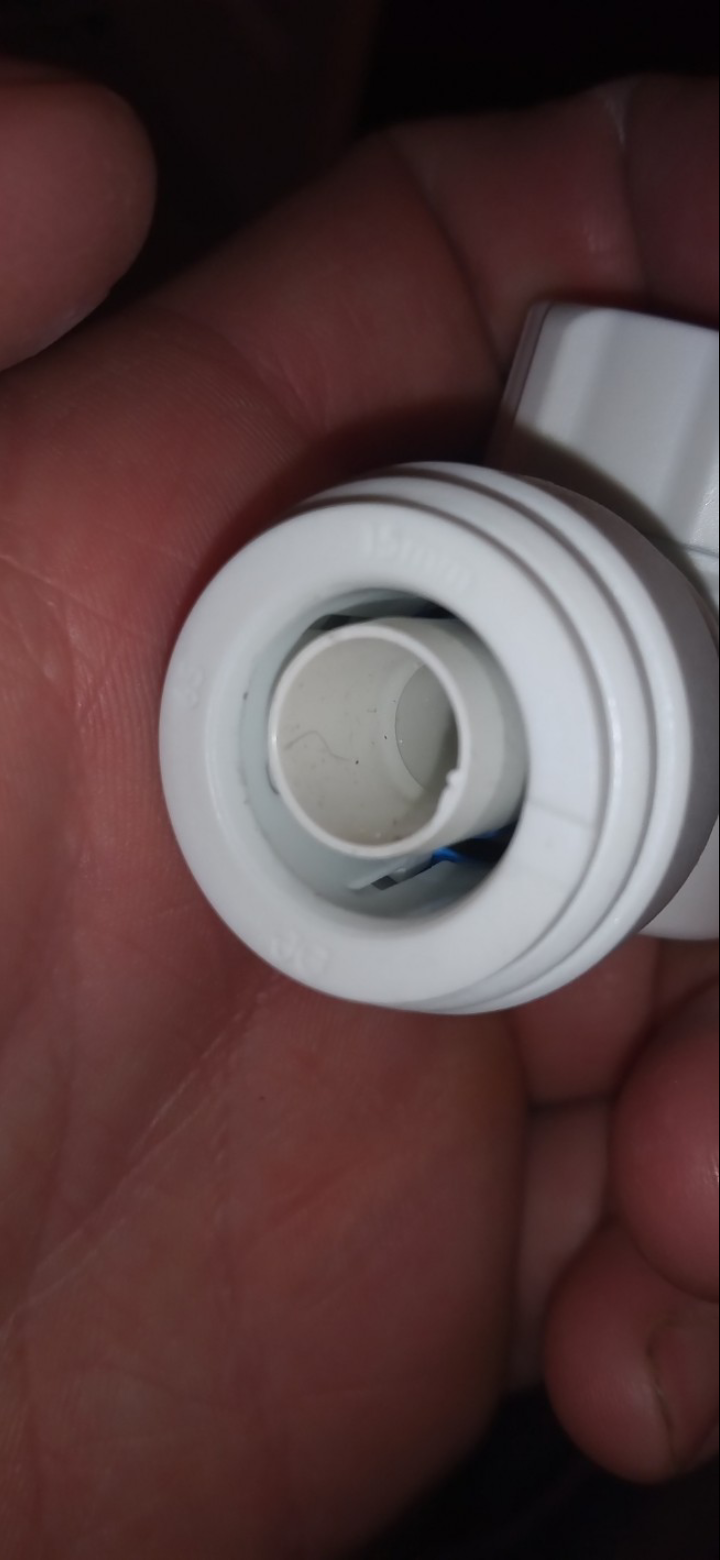

By now water will be to put it bluntly pissing out the pipe under force the cutter gives a nice clean cut with no burrs unlike a hacksaw which is important speed fit uses an o ring to seal.. so it won't rip the seal likewise cleaning the paint off ensures it seals well

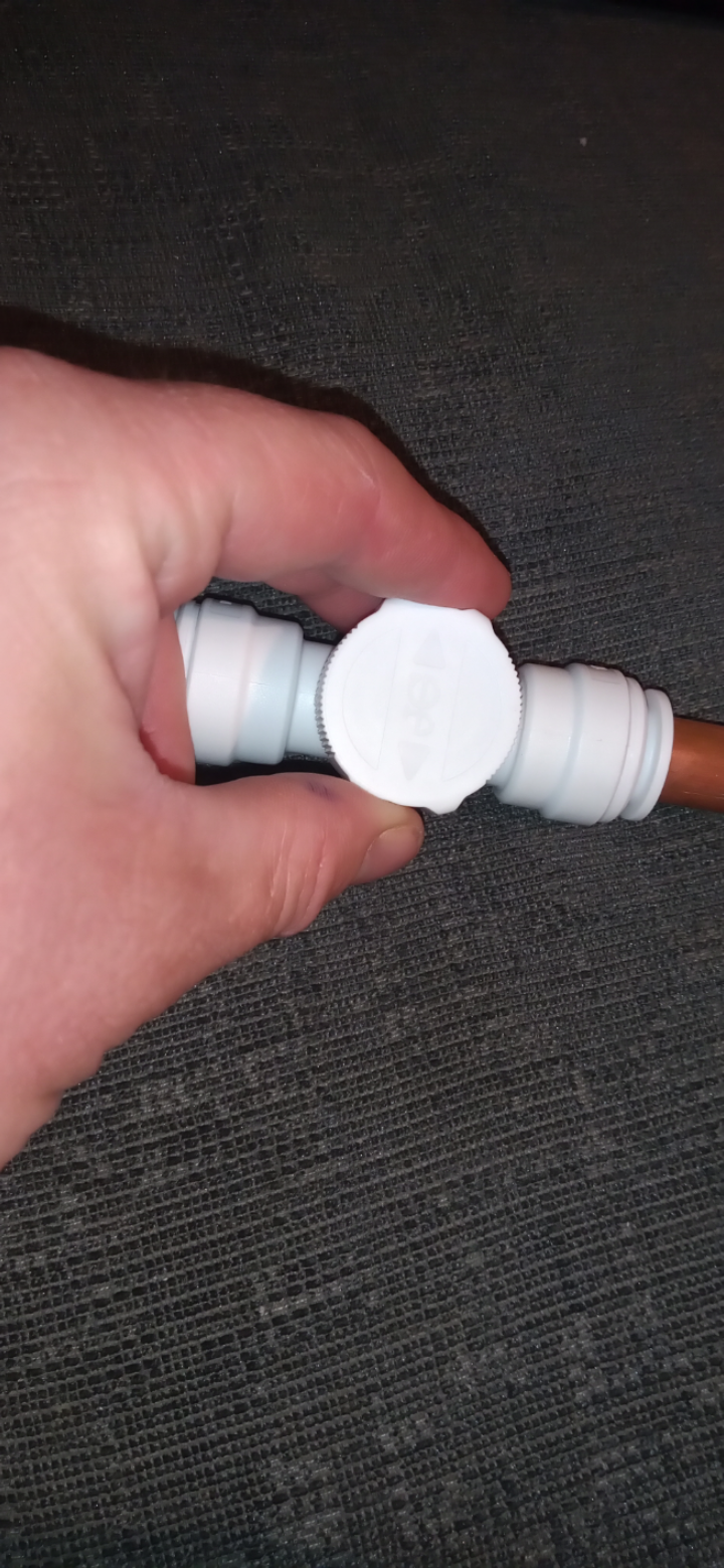

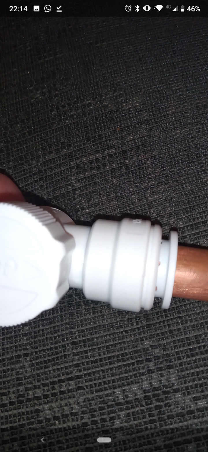

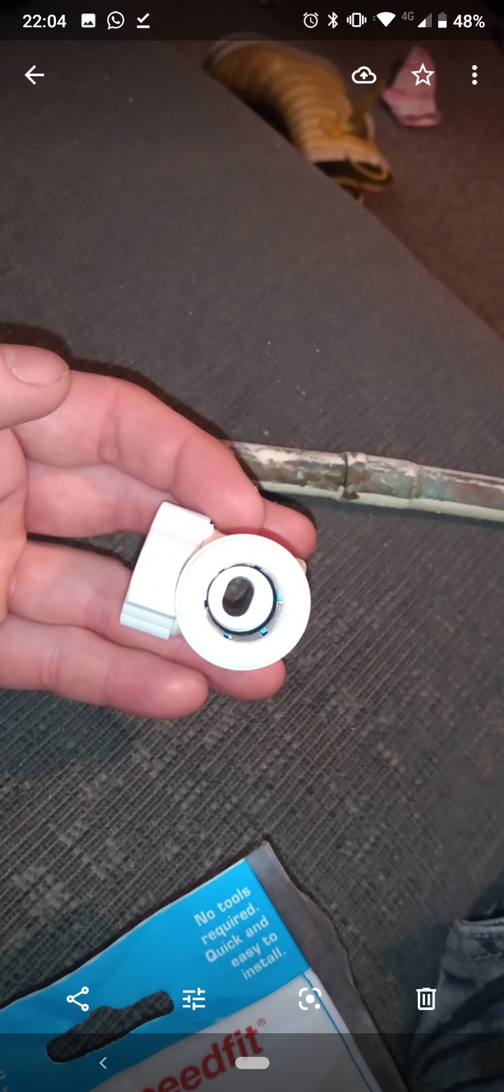

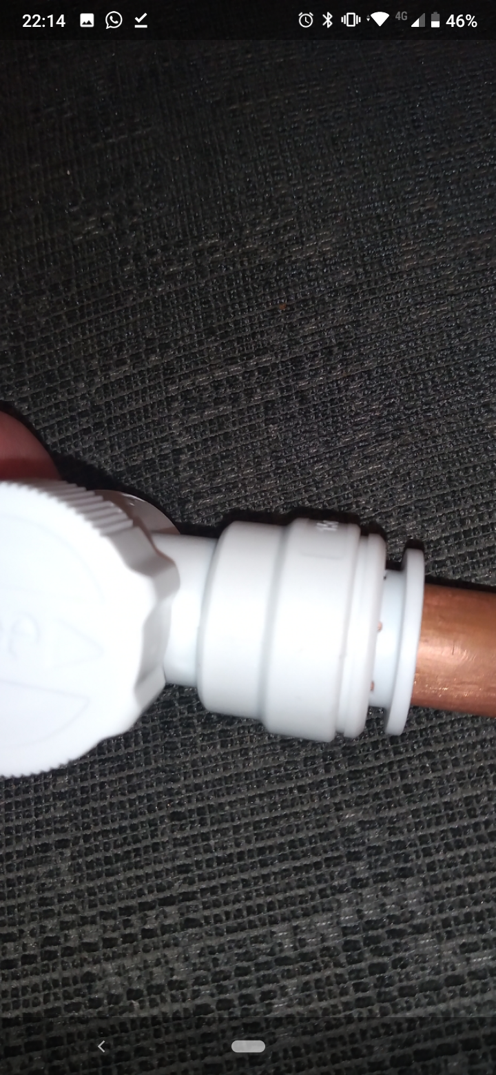

Now grip the pipe that's spitting water and with your other hand grip the push fit valve and push them together firmly till it stops then yank the new valve back a bit as you do the lock ring pulls back a bit
Then rotate the valve to shut off the water...

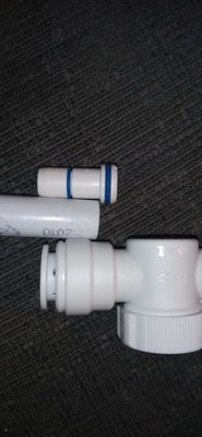

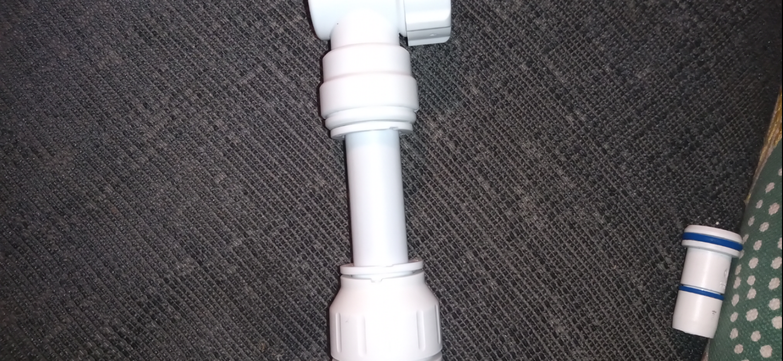

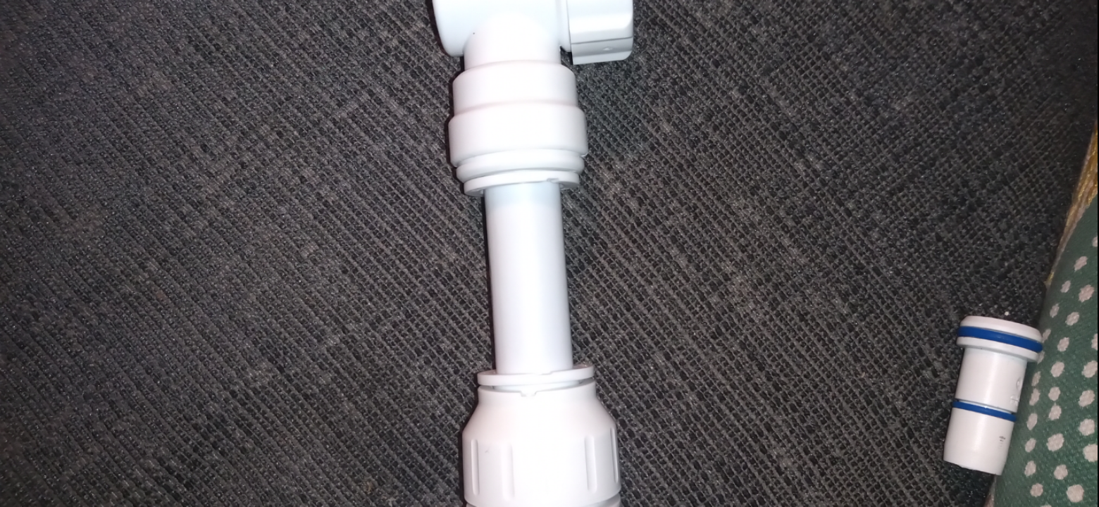

As a true diyer I also have some PEX pipe end fittings and some other none valve inline connectors and pipe cutters .
So the leak is stopped but the plumber can't come for a week or so :lol:

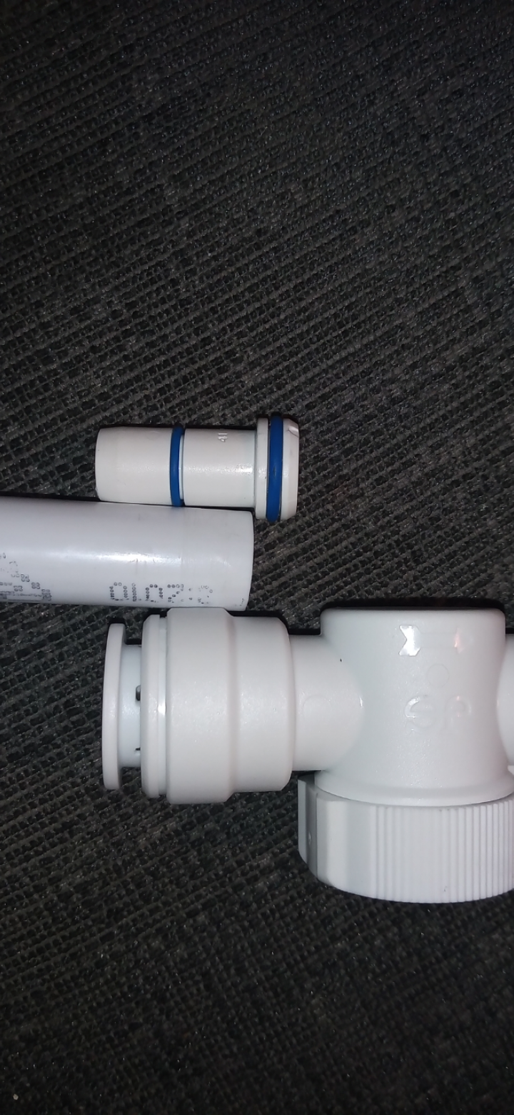

Remember saying about cutting about a foot out above ;)

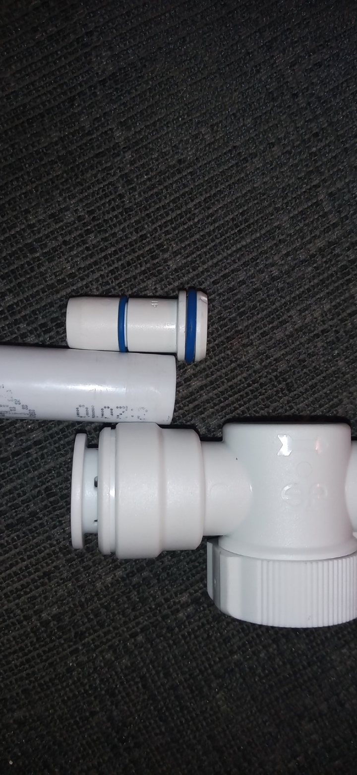

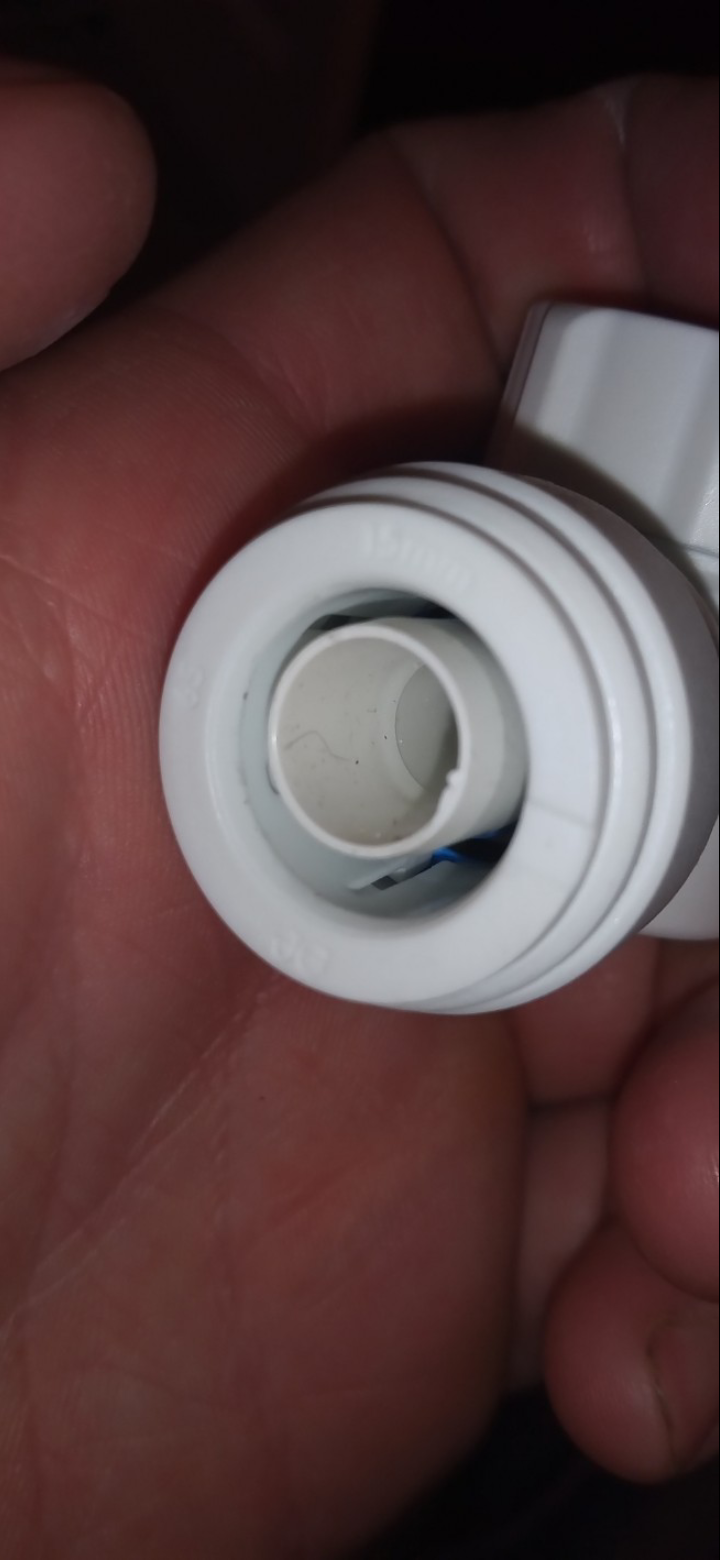

Cut some PEX pipe about the distance between the new valve and the push fit inline connector ends add on the length of the 2 push fit inserts before cutting ( one for each end) as that's the amount that sits inside the new fittings
Ideally you need a bit of free play in the original pipework of about 1 1/2 inch to slip in the new
pipe
But ultimately..
You will now have 2 speed fit ends a bit of pipe prepped to fit between the 2 fitting ends and a permanent fix

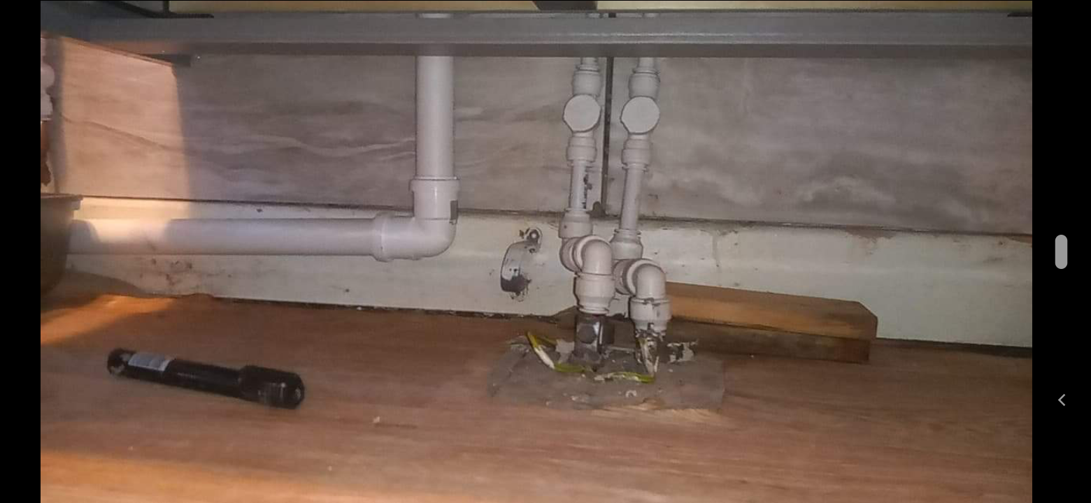

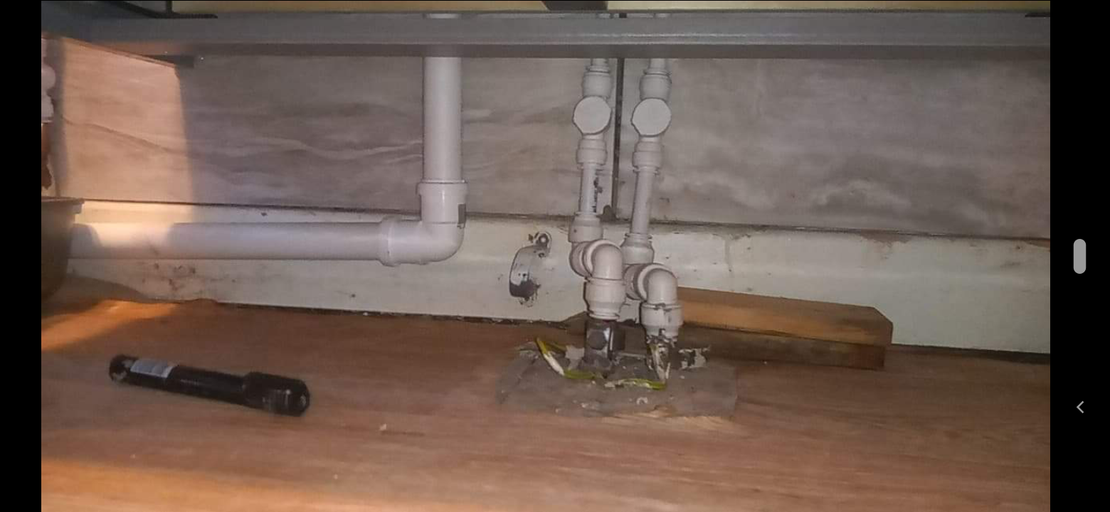

Had to retain the original copper above the floor level to maintain the earth cross bondings in a visible location for the eicr electric inspection (tried to get the council to replace the bathroom before lockdown
"computer / funding says no"
So I'm installing it and they will send some council bod out to inspect my handy work :lol: so all been installed to Wras standards (pipe clips to follow ) and maintaining iee electrical installation regs and a dramatic improvement from the leaking bath (to the point the floor has wet rot leaking toilet pan ( wet rot) and mould all they do is come and bodge it my kids health is important : :evil: any issues with my work will expose an argument over out of date smoke detector bases (they have a date of expiry on them. I've got enough knowledge and qualifications to cost them a fortune if they get clever . :twisted: )
