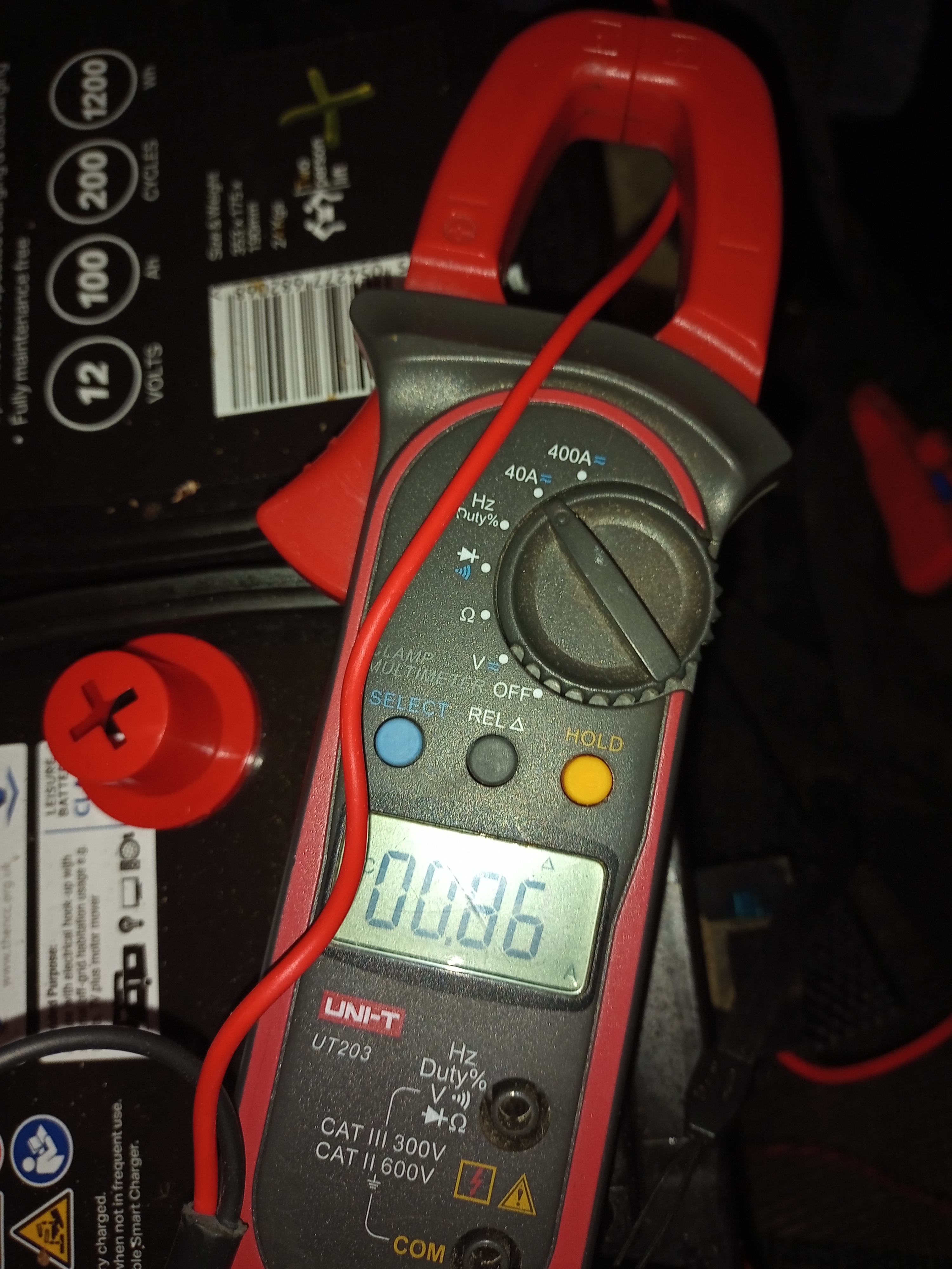

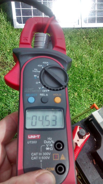

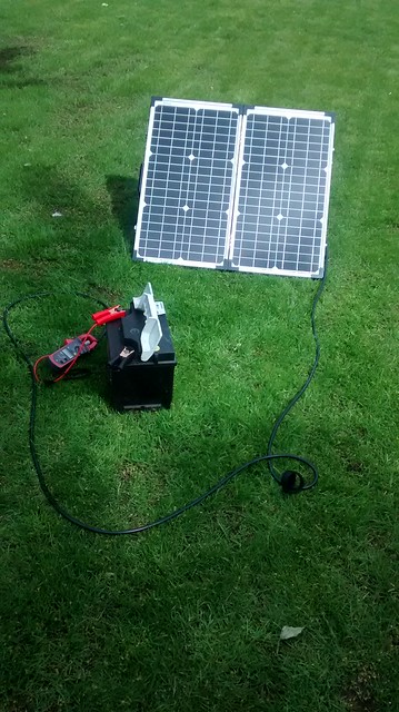

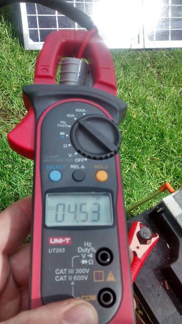

The good Bosch 60w folder I've got with a charge controller puts out a good 4a on a bright day might put out more depending on the charge controller Vs the state of charging of the battery..rik_uk3 wrote: ↑Tue Feb 01, 2022 7:32 pm I've tried the cheapo 60w-100w solar kits with charger and run a meter over them and you might get 10w usually less but still fine for charging a powerbank sort of thing or hooked up to your car battery for a trickle charge sort of thing.

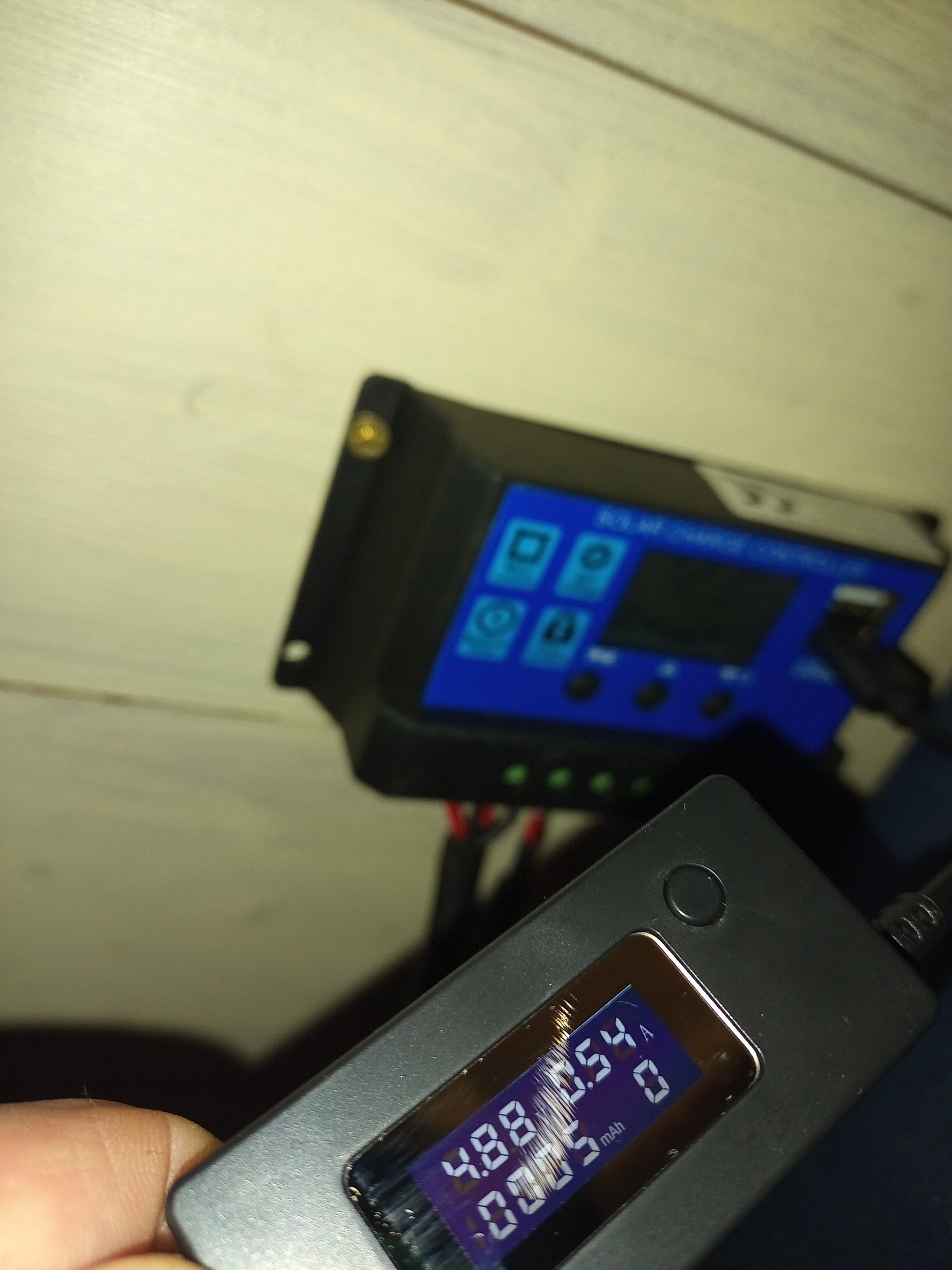

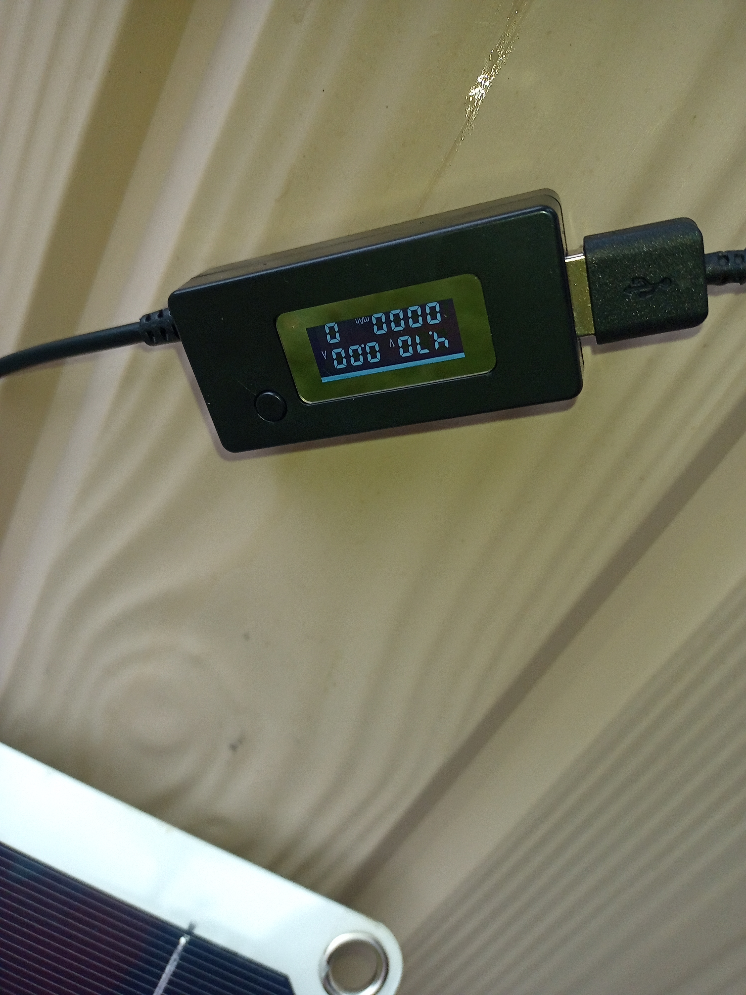

Well found my little China made usb meter ..
But it's blooming cloudy ..
The cheap "100w"
So tried the Lidl 14w and the cheap China "20w" panels they wouldn't even power up the tester ..
Most success was the 60w solar panel plus charger/ controller with the leisure battery
(Can't get to the wires to measure the panels input)
The 50w panel with the charge controller is taking in about 0.8a for comparison doesn't sound much but it's holding its own Vs usage
To be continued

Interesting research there Andy.Thanks for sharing that.Yorkshire Andy wrote: ↑Sat Feb 05, 2022 1:19 pm
The cheap "100w"China panel looked to be doing good showing 5 volts until I plugged in the Anker power bank then it dropped to IMG_20220205_123105_253.jpg
No ampage no charge...
To be continued![]()
Re: Power cut kit..
That's fascinating, Andy - what stands out immediately is that what's written on the box has very little to do with reality!
