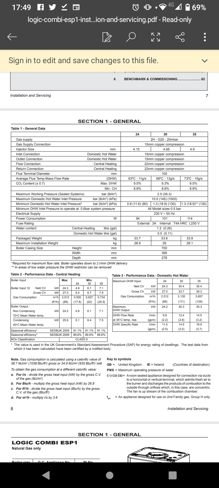

Jansman - or anybody else who can work these things out - what is cheaper? This is what we're on just now:
ELECT : 25.86p/kWh
GAS : 6.26p/kWh
Obv the gas is cheaper but I think gas heating uses a lot of elect too in the pump etc? So should I add the gas & elect cost together per hour the heating is on then?

If you Google the make and model of the boiler electric consumption should be listed..
Ours uses 101w when the pump is running so about 1kwh for 10 hours running of elec
- Posts: 10370
Re: Heating one room ?
Oh there's an idea ta xx It's a VIEMANN vitodens 050 and there's a huge thick handbook up on the shelf above it..
