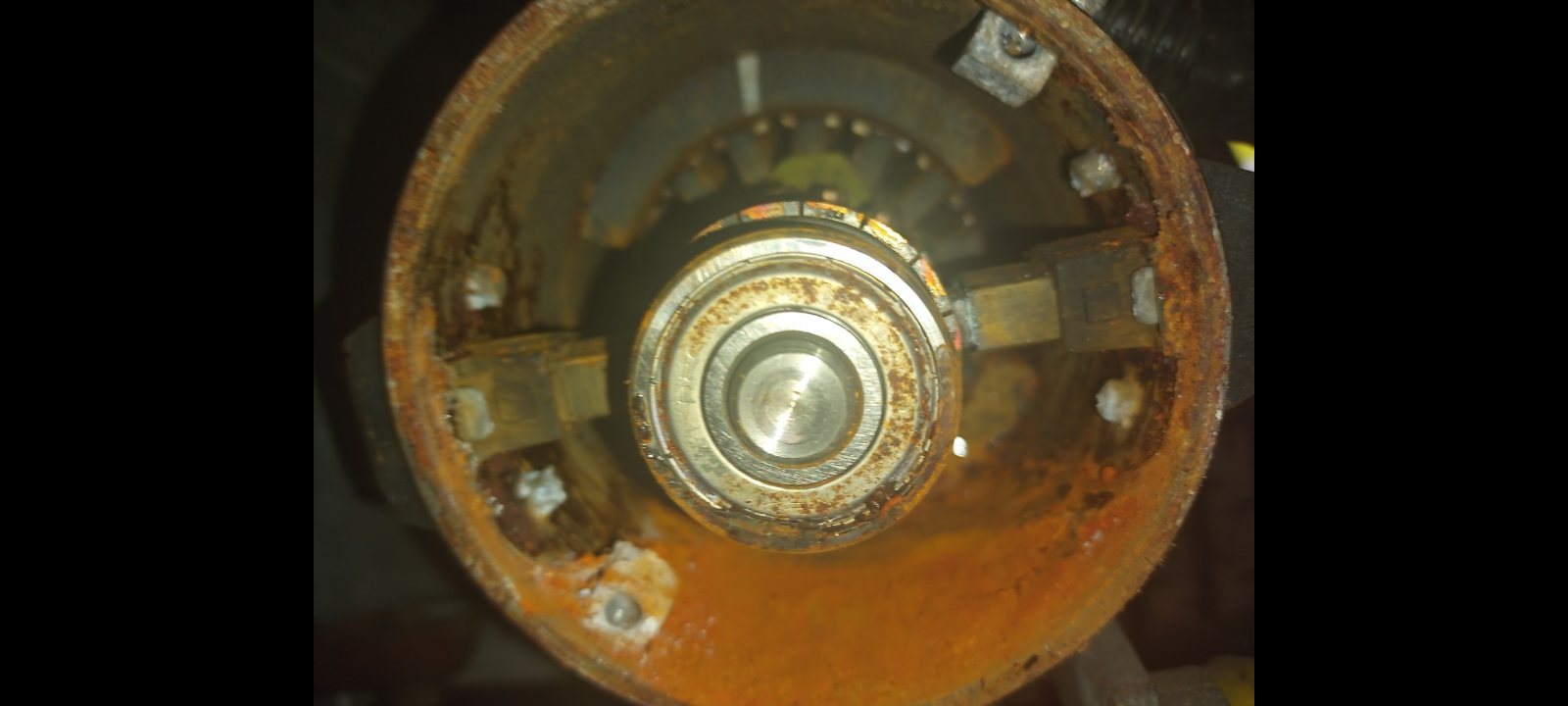

I'll second that just commented on another thread .. this is the guts of a 12v 20a DC motor mover on a caravan that decided not to work...
New motor =£600+ :shock:
New brushes and holders £96!
Bit of tlc a blast of compressed air, flush with contact cleaner , followed by light oil then aerosol grease for the bearing all is good for £3ish worth of lubes / sprays
