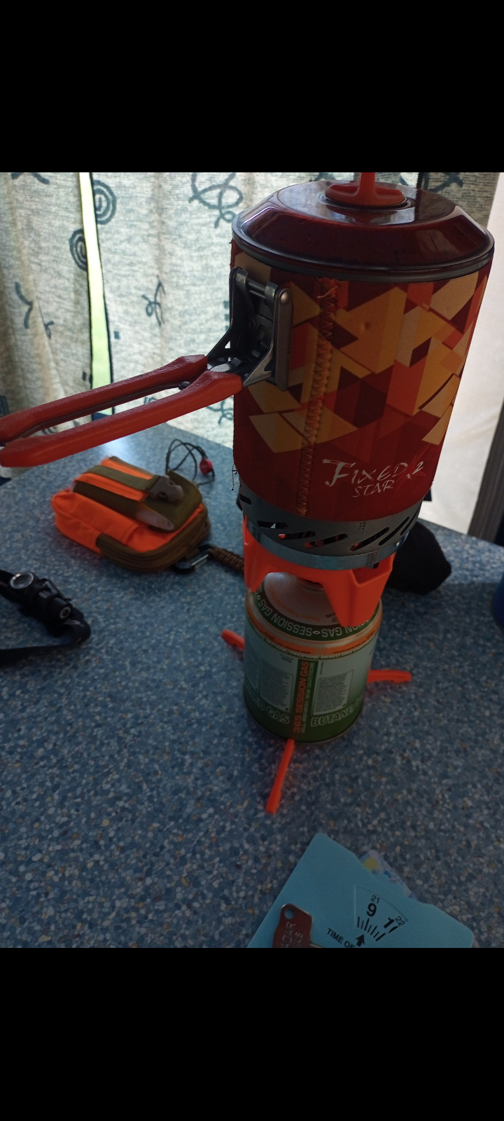

But is it ..... Really ...... What you really need is one of these
https://www.planetx.co.uk/i/q/CPPX750PO ... PPX750POCS
I've got one of the bigger versions under the fire maple brand it's bloody ace :lol:
I hammered if for a week solid doing 2x morning brews so 4 cups. Plus kids hot chocolate on a evening, boiled water for washing up at least twice a day . Plus a couple of hand wash smalls sessions in buckets plus boiled water for rice and pasta and I used in the region of half a cartridge which at the cheaper shops are circa £5 each .....
Boils fast and the one above even had a coffees press so you can have a posh coffee and stay caffeinated :lol:
And it's not Amazon or eBay :mrgreen:
Cartridges here under a fiver each
https://www.winfieldsoutdoors.co.uk/col ... pxEALw_wcB
So that's theoretically 12 weeks off brews for £25 ISH in gas
Not that you need one I understand :twisted:

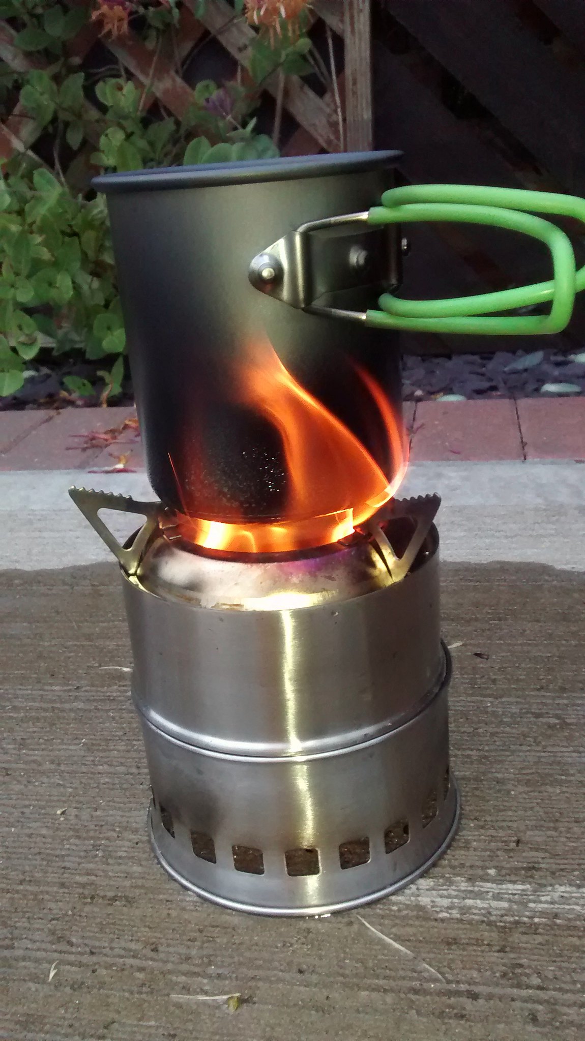

I havre three stoves that burn twigs. One is round and is a gasifier https://smile.amazon.co.uk/gp/product/B078Q6THFK/. The other two fold flat. One of these is titanium, so very light https://smile.amazon.co.uk/gp/product/B082CXLRJ9/.
Also have a Trangia with a gas canister burner, a mini Trangia (the meths burner from this can be used with the big Trangia), and two other gas canister burners.
I have a ferro rod for lighting fires if I run out of lighters https://smile.amazon.co.uk/gp/product/B00PSGOM32/
Also this can be done with a magnifying glass.
Easy way to get a fire started...cotton wool balls dipped in vaseline. Very flammable. Once you get twigs on you need to blow or fan gently to get oxygen in there to aid combustion, unitil the fire is going strong.

Yorkshire Andy wrote: ↑Wed Aug 03, 2022 10:09 pm But is it ..... Really ...... What you really need is one of these
Andy, you B****** !!!!!
:lol:
Shall I just give you my amazon and ebay logins and you can buy me everything you bought yourself?
Actually, I was looking at side-insulated saucepans and this includes one. So I'm tempted.
I like how efficient the burner looks and sounds. Also that pan could sit on my hobo stove..... I'm tempted.
Serious question...... Do those gas carts have unlimited shelf life?

The neoprene wrap won't like the flame on the hobo stove
it's a strange base it's got a set of crinkled fins on the base think looking between a double dometic radiator you can almost wrap your hand round it when it's lit I wouldn't want to damage it :lol:
You can get higher efficiency cook sets
https://www.gooutdoors.co.uk/15901577/o ... t-15901577
But it's as much as a full stove set up :lol:
Cartridges last ages I lightly oil them with 3 in one oil
to stave off any rust then just rag them clean when needed
I'm all for sustainable cooking but at 7am if it's cold last thing I'd want to be doing is starting a fire when I can turn a tap on press the spark button as it's boiling get a tea bag has cup ready :lol:
