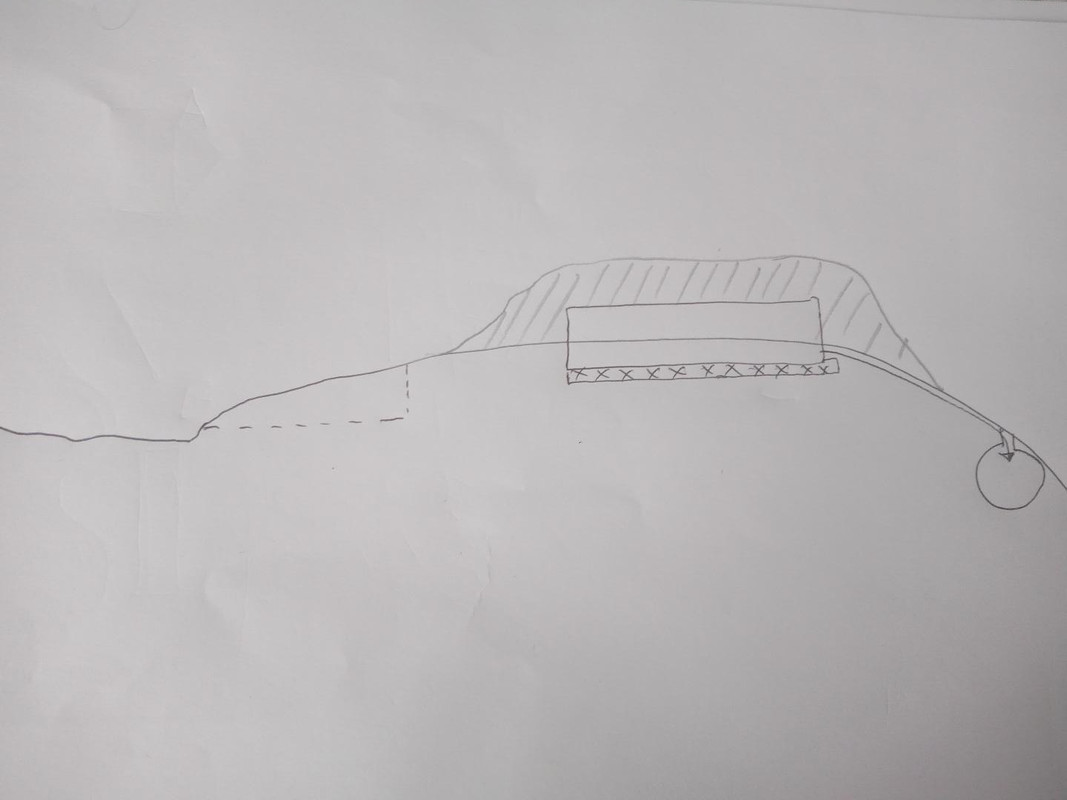

This is a rough sketch of what I was thinking might be a compromise
Posts: 5403
Re: So i want to bury a shipping container
This is roughly what I had in mind as a compromise
Where you label 'drainage' I label 'moat' :) *
Ignore me. I'm only jealous because the poster has his own coppice and JCB.
*I know: It's only a horseshoe around it.

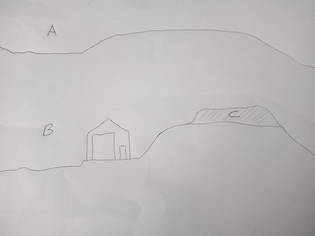

Vitamin c wrote: ↑Sun Apr 23, 2023 12:12 pm Just out of intrest
How would you get fresh water and get rid of dirty water.
hi Vitamin C
well choosing the location is probably the most important factor, you need to be underground but above the water table, i was able to pick a good spot and then improve it further
looking at the above is the rough side profile of my site, the area marked A was where i intended to put my barn when l built it 30 years ago, however it soon became evident that it flooded there as it was one of the lower areas so i cut out part of the hillside to make sure my floor was 2ft above anywhere that might flood, this produced a huge amount of spoil that had to go somewhere so i used it to increase the Hight of the hill, it all over grown now and you would never know its not part of the original hill
that gives me tolerance with levels to work with, any waste water from within the bunker and from the french drains around it can flow down hill and either out into the fields or in the case of sewage into a holding tank, the site is on mains water which can be plumbed into the shelter which is quite unusual around the area as most are on wells and i will eventually drill myself a well , i have no idea how long i might want to inhabit it but i magine a coupe of weeks max but would like it capable of a much longer time if required

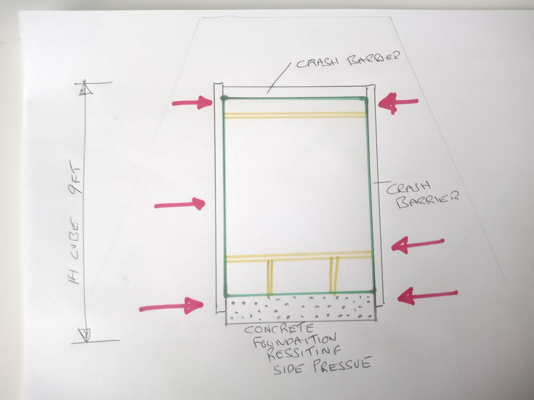

Frnc wrote: ↑Tue Apr 25, 2023 7:42 am This is roughly what I had in mind as a compromise
Hi Frnc
thats pretty close to what i was thinking, the difficulty i see there is the reinforcement drawn in red has no where to finish half way up the wall where there is no strength to lean on it really needs to go up to the top where you have a hard edge which is much much stronger

so expanding on the crash barrier idea instead of the concrete skin
the barriers are abou3mm think they have they waving from to resist impact/pressure they are suppose to stop a 1500kg car at 70 mph from going through, i see them as plenty strong, theres loads about relatively cheap
i will need a concrete base at around 250mm thick for the container to sit on with out good foundations what ever you do is doomed for failure
if i weld the barriers upright to the sides of the container leaving 150mm sticking down and up then weld them across the roof i have created a shield around the container at lower levels the barriers are stopped from moving inwards by the concrete foundation and at higher levels the roof barriers transfer the side loads to the other side where the opposing forces cancel them out, if they wernt welded to the container you could pull the container out ,

i am proposing to use a hi cube container which means its 9' tall. that will allow me to install a false floor about 18" up so water/batteries/ etc can be stored underneath and again adding a further reinforcing structure side to side and at aprox 12" down i will add a false ceiling above which dried food clothes etc can be stored
