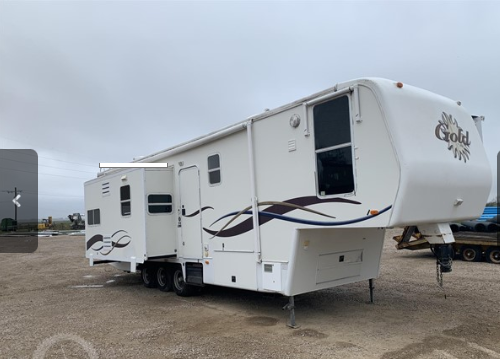

l know i wouldent have any problem living in 40'x8' as i have one of these 5th wheel campers which is the same size
over the last few years i have lived in in the summer months with it sited in a clearing next to one of the lakes i have dug in my 7 acre "coppice"

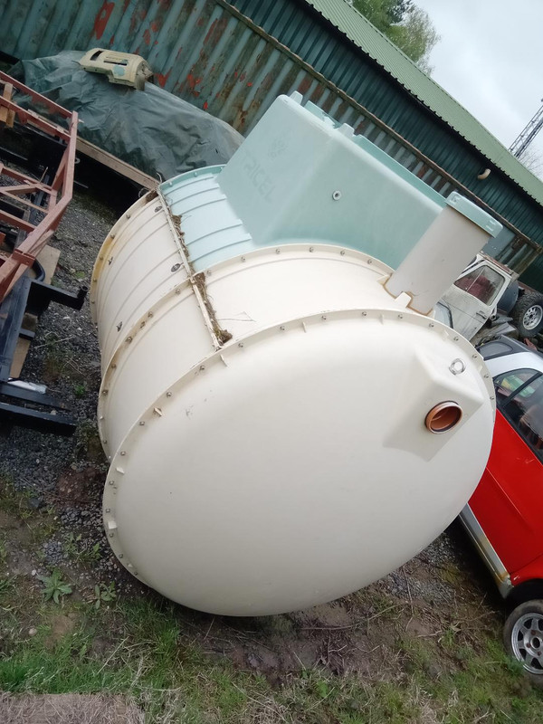

no ones found me, the council haven turned up and turfed me out, its all very doable the only dislike i have is the very small bathroom, my shoulders touch the wall in the wc and in the shower hence my desire to have a proper size bathroom in the bunker that functions exactly as a normal house bathroom, to that end i picked up this to use as a cesspit recently,

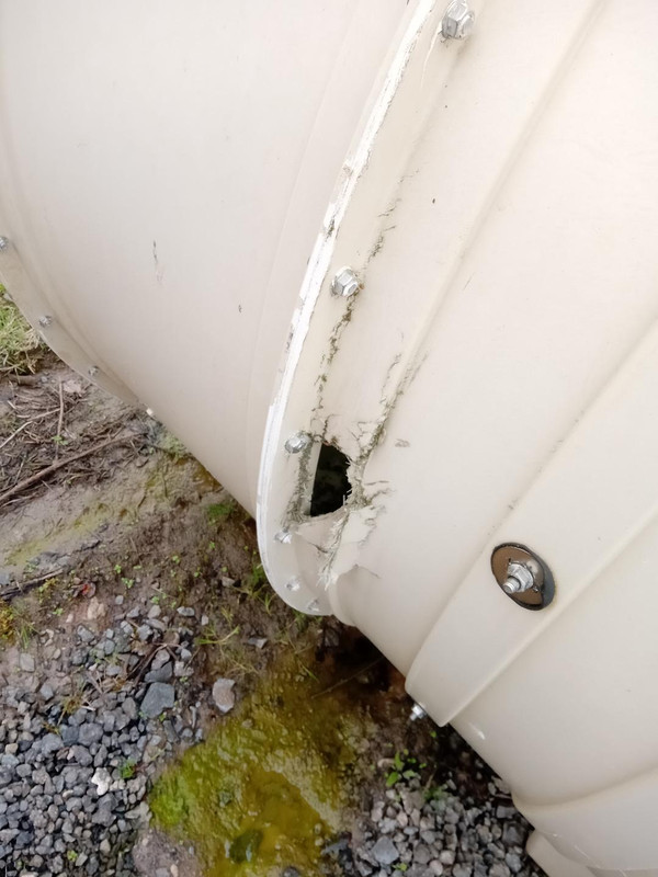

dont know how much they are normally but this one came for a hundred quid so i bought it myself for Christmas, all i have to do is repair a small hole where the yard fork lift driver got all excited with his forklift truck and punched a hole in it
simple repair with grp and its good to go
