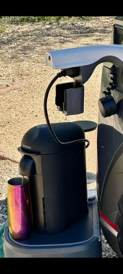

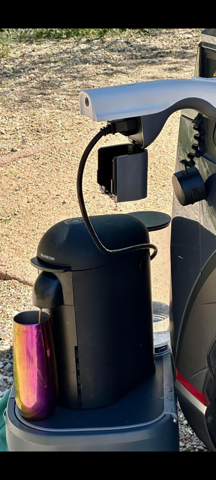

Anything and everything lil, haven't tried the washing machine yet but kettle, toaster. fridge freezer and microwave work just fine.
Think of mine as a DIY solar install with battery like you see on the TV Adverts. Except mine is portable
You just have to change your "working" habits i.e any heavy electrical loads are done before 10am so the Powerbank has the rest of the day to recharge

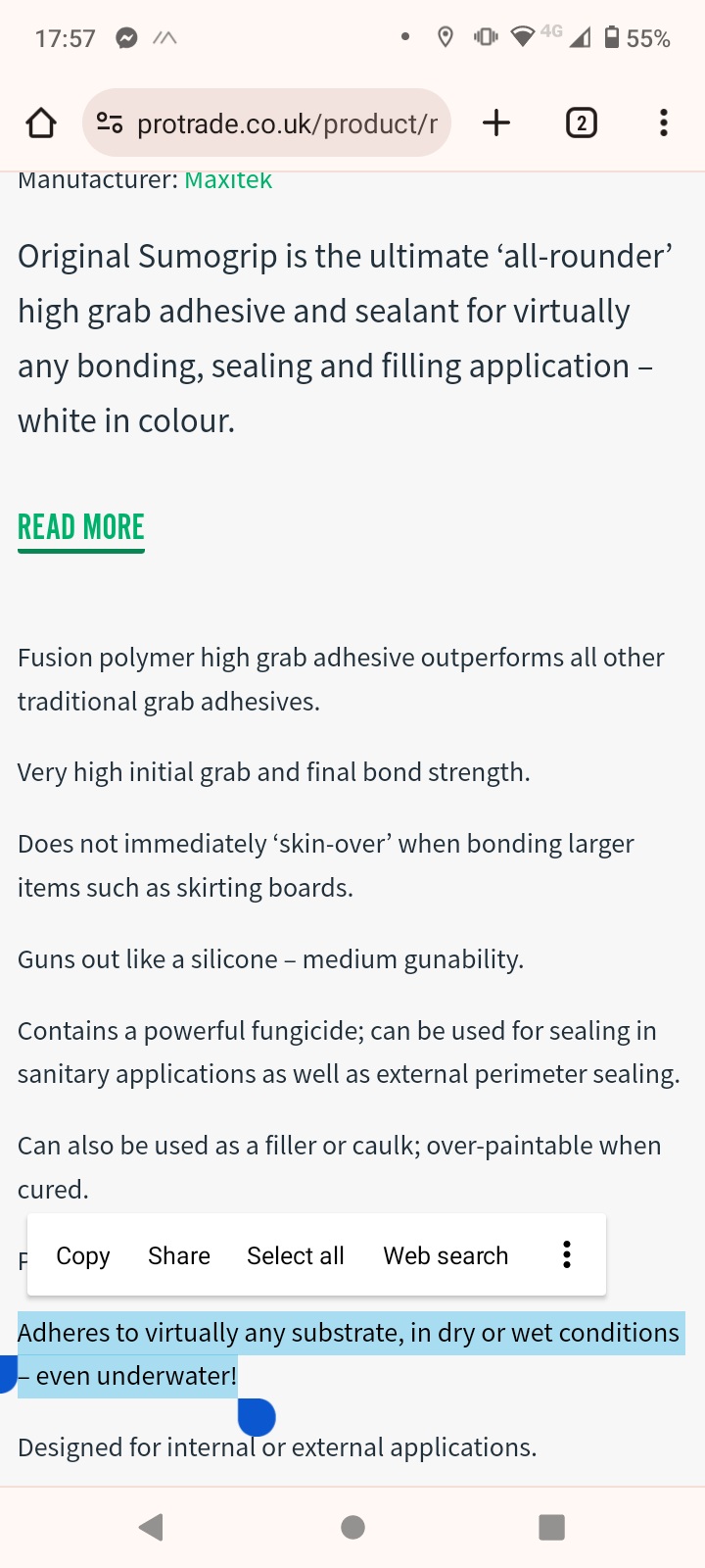

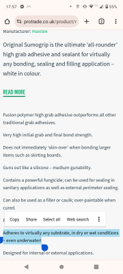

But can Sumo be used on wet materials? From what I can gather, CT1 and Sumo are similar in many ways (I have read a review comparing them), but that page doesn't say Sumo can bond to wet surfaces or under water, and the review didn't mention it either. I've not looked at the Dow Corning, but obviously I've heard of it, is that a normal silicone?
- Posts: 9077
From sumo it's also anti fungal Dow is "normal silicone"Frnc wrote: ↑Sun Apr 14, 2024 4:26 pm But can Sumo be used on wet materials? From what I can gather, CT1 and Sumo are similar in many ways (I have read a review comparing them), but that page doesn't say Sumo can bond to wet surfaces or under water, and the review didn't mention it either. I've not looked at the Dow Corning, but obviously I've heard of it, is that a normal silicone?
I must have missed that. Looks like Sumo might be the better option. Reminds me, I need to silicone the extractor fan hood outside soon, got some brown silicone for it.Yorkshire Andy wrote: ↑Sun Apr 14, 2024 4:59 pmFrom sumo it's also anti fungal Screenshot_20240414-175738.pngFrnc wrote: ↑Sun Apr 14, 2024 4:26 pm But can Sumo be used on wet materials? From what I can gather, CT1 and Sumo are similar in many ways (I have read a review comparing them), but that page doesn't say Sumo can bond to wet surfaces or under water, and the review didn't mention it either. I've not looked at the Dow Corning, but obviously I've heard of it, is that a normal silicone?
