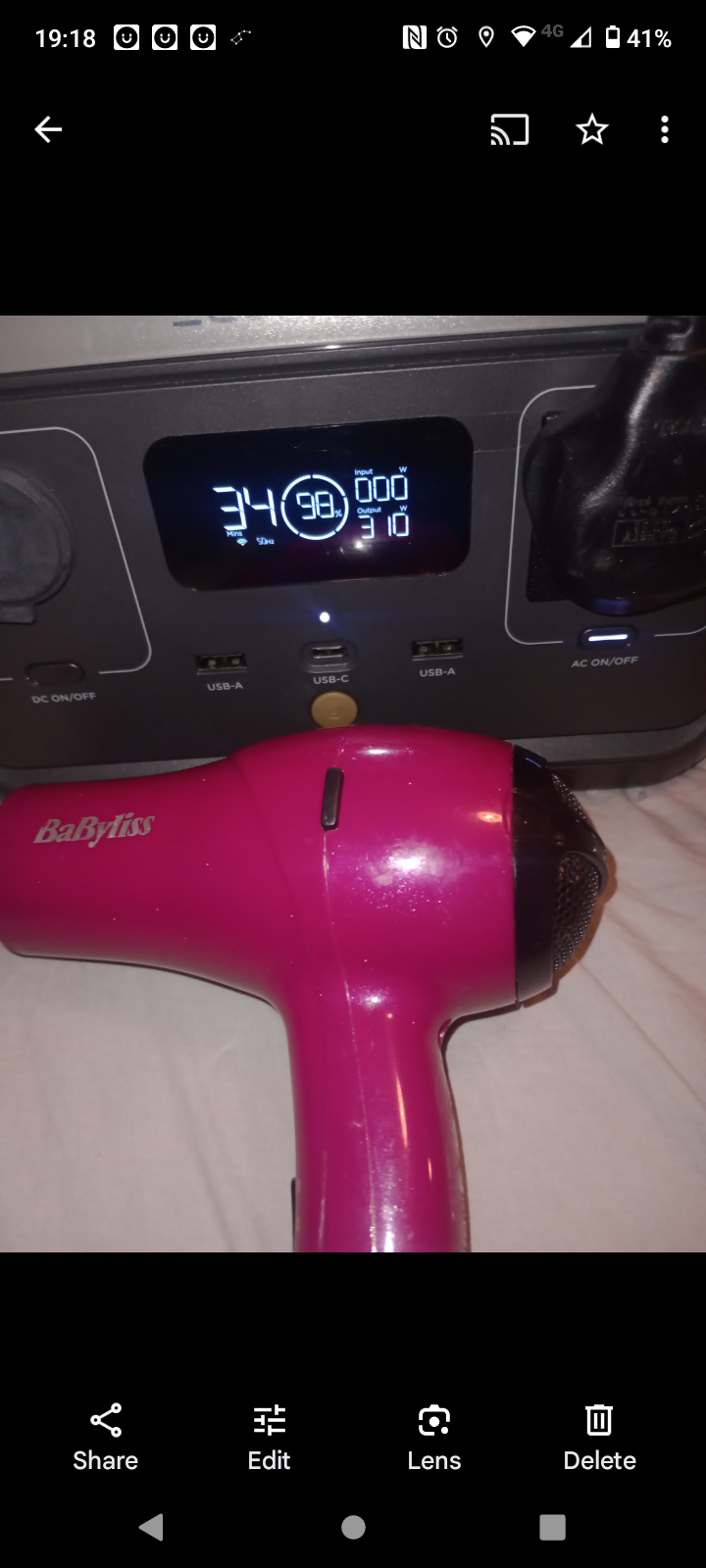

Is this solely to dry her hair? One shower / drying session and phone charging ?
On low power (trips on full) it'll get 35 mins run time
Added bonus from nearly flat it'll recharge in about 2hrs from the car cig lighter (average holiday running about visiting places)

Hair driers tend to be high power. So you would need to be able to provide a couple of KW for the ten minutes or so needed which means a big and expensive gadget.
My cheapskate hair drying solution when camping is one of these for 20 mins:https://www.amazon.co.uk/gp/product/B08 ... UTF8&psc=1
Then staying somewhere warm ( sitting in the car) to complete drying off which is much quicker than with a standard towel.
