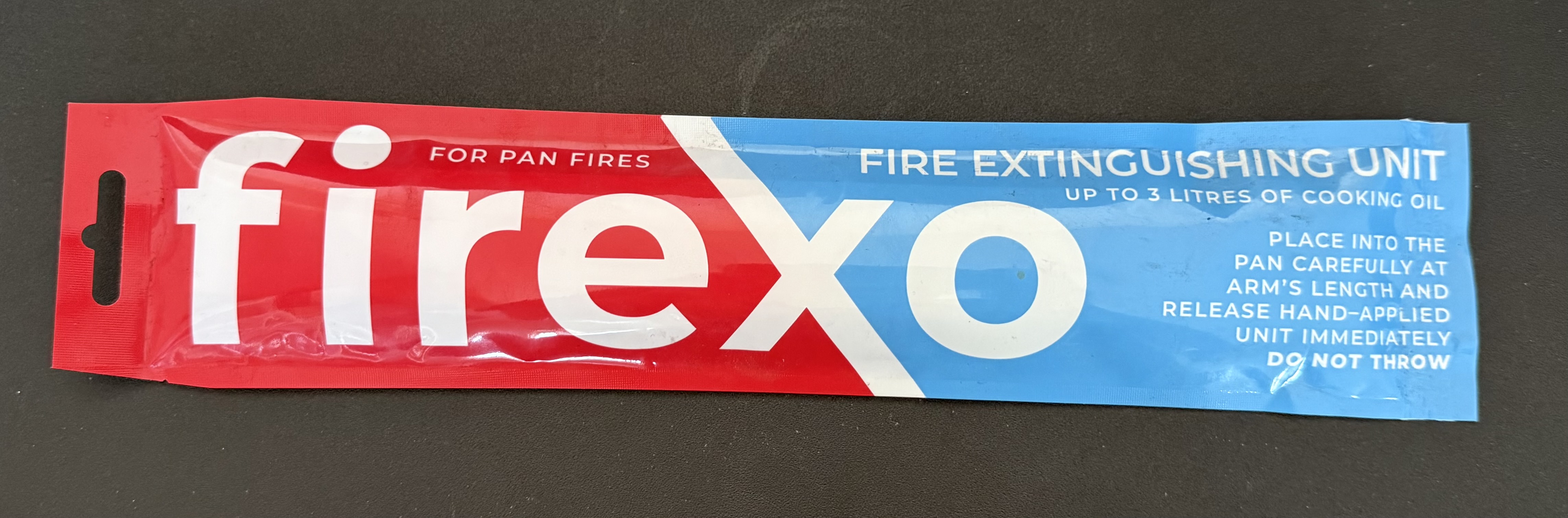

I grabbed a few of these when I was in B&Q for some materials. £3 each, just pour into an oil/fat fire and poof, it’s out. Handy bit of kit, cheap, and takes up hardly any space.

Just lay it in the pan in its packet and let it melt
https://youtu.be/O0B4Z7-ZXdM?si=EJl09-x-k9WoPLJi
