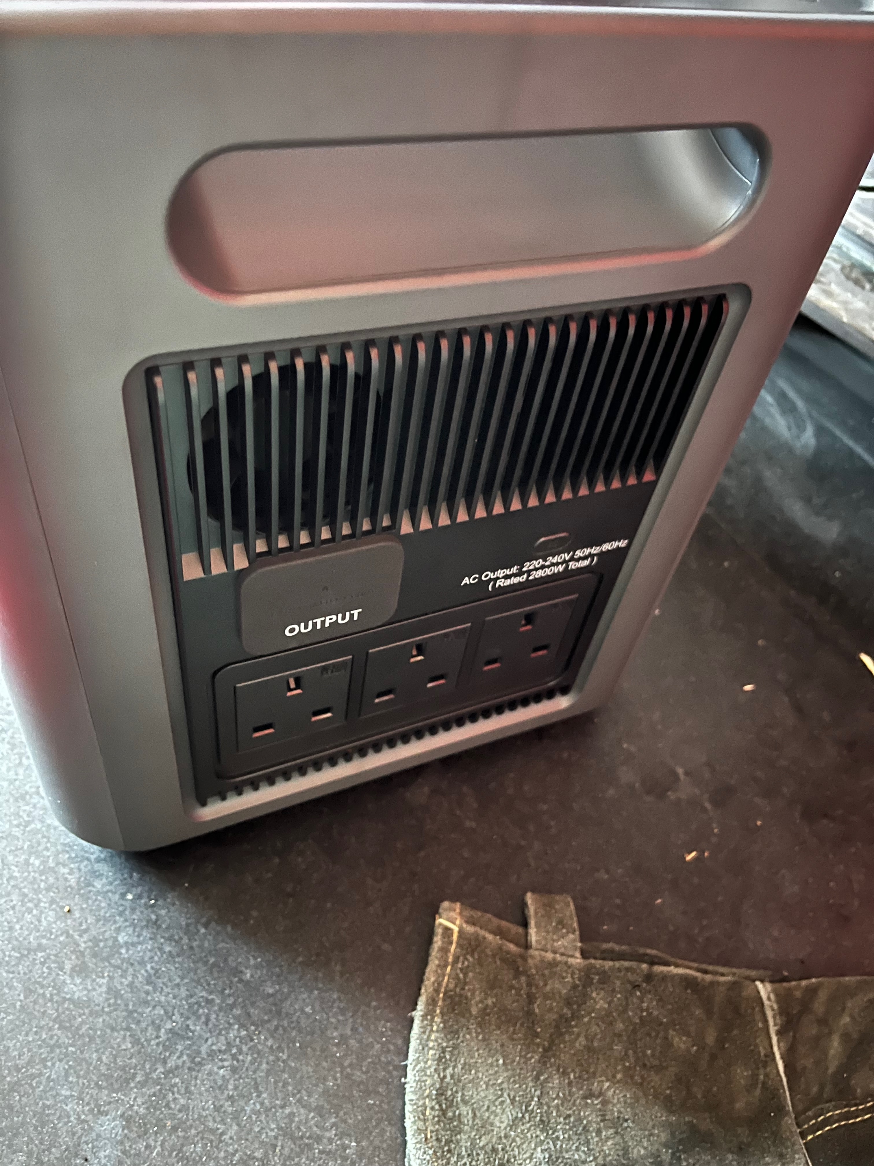

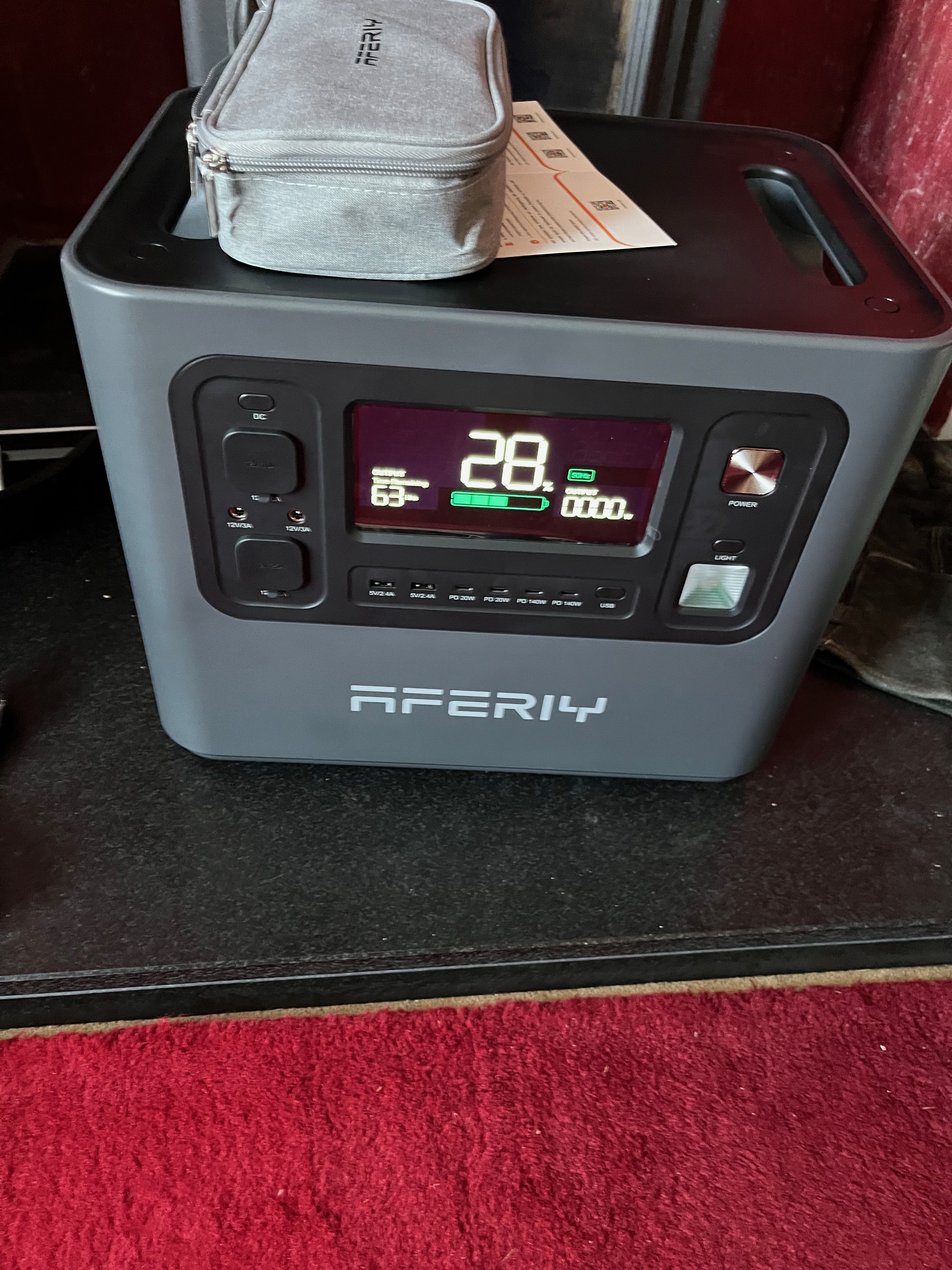

Picked up a new addition to the power banks. This is the Aferiy P280. It's 2.8Kw continuous output, with a 2048Wh battery. They claim its portable... well maybe - its not light. What I liked about it is that its expandable, up to 10KWh - you can daisy chain 4 more external batteries.
At the moment, they are on sale via the Aferiy site (no affiliations). I got this at 40% off the normal price.
Aferiy P280 power bank
