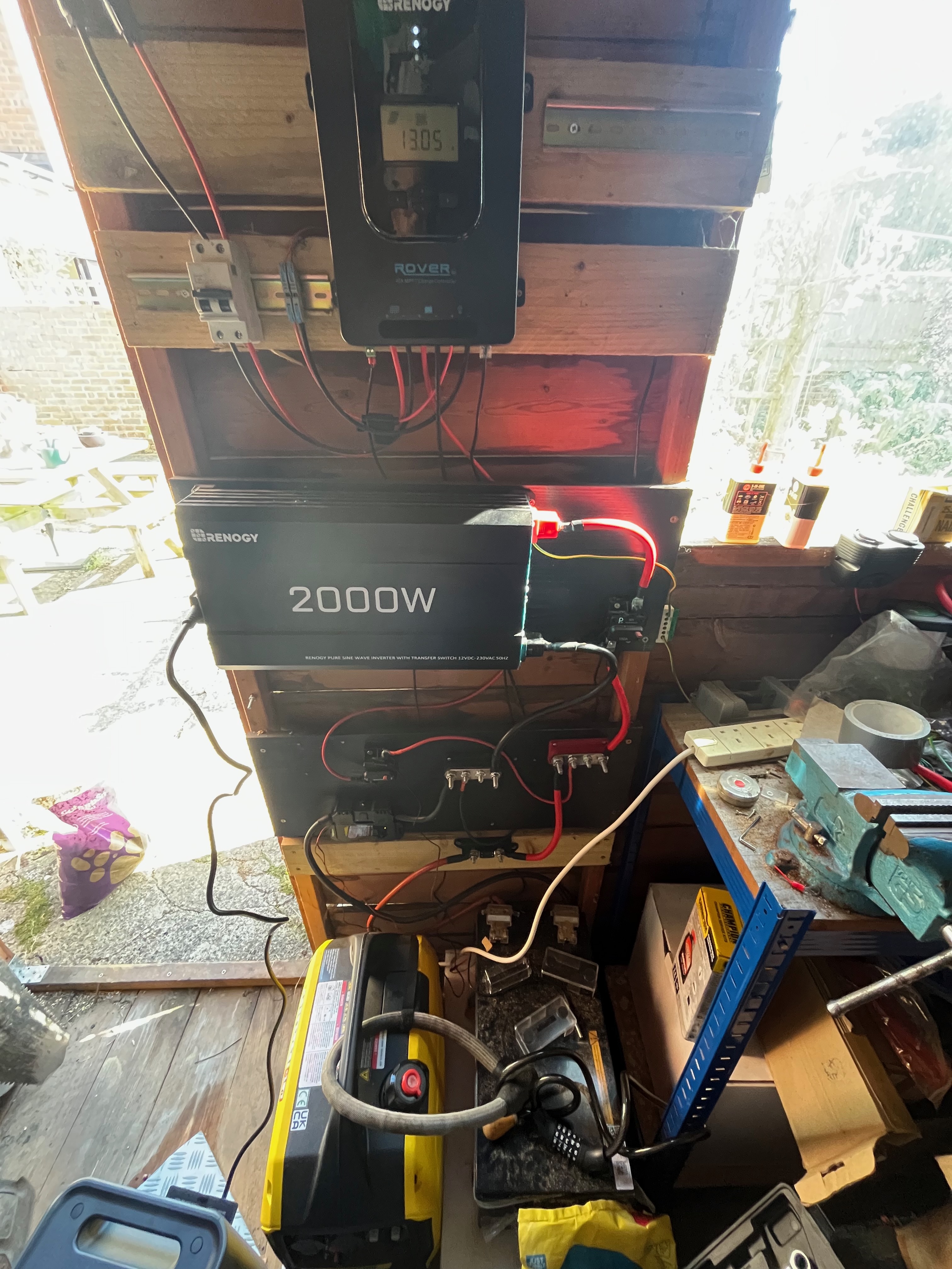

So, I have been stress testing my home solar power rig, following the heat issues due to corroded connectors. Now that everything has been cleaned up etc, am getting much better thermal control. However still have a few bits to solve. To recap, when running it at a 600W load at 12V, I was getting a couple of hot cables (one in particular).
This is the actual rig. Renogy 2Kw inverter, Eco-Worthy 280Ah battery, Renogy Rover 40 Charge controller. This is the thermal image with no load. Temperature in the is around 19C, as its south facing. The max is coming off off the concrete floor outside. I than ran it at 600W load at 20 minutes. The 29.8C Max is the cable coming out of the break, on the +ve DC, going into the inverter. However, it is in the sun. But.. I then cranked the load up to 1.2Kw and left it for 15 minutes. The first image is the fuse on the -ve return to the battery. Bit warm, but was stable. The next two are the 150A breaker again. Getting a bit toasty. Ok to touch but definately a bit on the warn side. So the issue now is that breaker. Reason its causing a problem is that it was cheap, so has stupid little terminal connectors. Need to swap that out for something with a recent surface area - at least M8. The lugs on the cable onto it are M8 and there is slack. However, from a supply perspective, my base load is around 200W. Running it at 600W then I'm now fine. Can even crank it up to 6X my need, and with a few tweaks, should be fine. .

I’ve found a smear or copperslip grease on high current connectors (ie vehicle engine earth straps) improves
connection and prevents corrosion, and could be beneficial but I haven’t tried it on our solar rig.

Do you guys think that adding in whopping great fuses might actually increase fire risk because of the extra terminals in play?
I'm starting to feel uneasy about some of the very high currents involved with these leisure batteries and inverters. I worry less about the mains voltage side.

jennyjj01 wrote: ↑Fri Apr 17, 2026 6:21 pm Do you guys think that adding in whopping great fuses might actually increase fire risk because of the extra terminals in play?
Id initially fuse the battery

A fuse will protected you from a catastrophic short, but running at 12V means you by necessity run at high current. My issues are thermal. For instance I use 35mm welding cable for my battery runs, which is rated at 240A. However, that's a max current. For prolonged use, ideally it needs to be a lot less than that, but a 2Kw inverter flat out is pulling around 180A. So at that level, I ought to use 50mm or 70mm cable. That size cable is hard to crimp yourself, plus it needs big terminals to attach to.
Or you go up in voltage. Like most people I started off with a small inverter and a 12V leisure battery. That's fine for a camper van or shed where you are maybe pulling 200w. But now I've got to the stage where I want a more extended capability.
With hindsight, I should have started at 24V or more. But now you are into kit that is much more expensive (victron etc). I could take the rig to 24V, but then i'd need a second battery, a balancer and a new inverter. Or go for one of these combined hybrid charger/inverter solutions. Either way, it's more expenditure.
On the other hand, the Aferiy I bought runs on 40135 lithium cells. Internally, the pack is at 51.2V so flat out at 2.8Kw it's only doing 55A ish. At my base load, it's about 6 A..

GeraldTheBonzai wrote: ↑Fri Apr 17, 2026 8:21 pm A fuse will protected you from a catastrophic short, but running at 12V means you by necessity run at high current. My issues are thermal. For instance I use 35mm welding cable for my battery runs, which is rated at 240A. However, that's a max current. For prolonged use, ideally it needs to be a lot less than that, but a 2Kw inverter flat out is pulling around 180A. So at that level, I ought to use 50mm or 70mm cable. That size cable is hard to crimp yourself, plus it needs big terminals to attach to.
