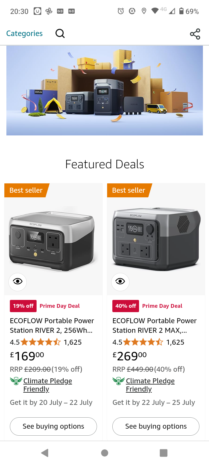

yep river 2 I got another recently from Argos in the sale for £166 which is the same price as a decent leisure battery :mrgreen: it will do pass through charging you can even set it so if the battery drops low mains cuts in if above your % preset it then prioritizes solar

Thanks for confirming my approximate calculations, the River 2 would likely run the fridge for c.12 hours which is pretty good.
£166 is a cracking price, nice!
Seems to be around £200 now, if it was £166 I'd likely have just bought it already :lol:
Posts: 9971
Re: Off grid refrigerator
tarmactatt wrote: Tue Jul 02, 2024 4:47 pm Thanks for confirming my approximate calculations, the River 2 would likely run the fridge for c.12 hours which is pretty good.
Currently on prime sale assuming you've got prime
