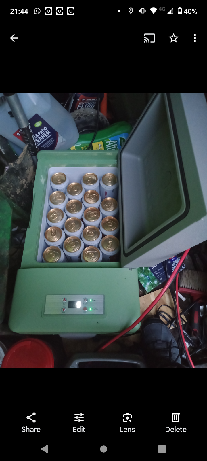

So fast forward the newer tech 12v compressor fridges
On eco mode it runs at 30w when cooling on eco mode will chill down to -20°c (freezer)
And since Saturday it's run happily off a 120w solar panel and a 250wh solar "generator" and over night it's dropped to about 45% then once it gets bright it's fully charged by dinner
Ideal for camping or storing things like insulin or beer shtf it's got a digital temperature display so you can set the temperature you require there's a calibration mode if you need to fine tune it out the box but it seems accurate enough to me ;)
The fitted fridge in my camper is of 2004 vintage and costs a fortune to replace it still works but isn't overly efficient anymore so this gives me a fall back when I'm away if it fails completely I've another option and overflow space when the wife gets too much stuff at Asda .... It's only 20l capacity but it's a nice size for transporting in the car boot when camping the 3 way chest fridge was a bit big...

The peltier ones in general are naff from experience they also don't seem to last long I had 2 die last summer kept my pack up in them at work under my bench and they are pushing 1/3rd the price of the compressor fridge anything over 25 degrees they just can't cope and the dead one I'm using as a cool box at work at the moment is plated at 50w on 12v but that's constant .. the compressor one cuts out there's no draw displayed on the ecoflow with it been a cool wet night last night the ecoflow was showing 70% this morning

18 cans with room on top for more :mrgreen:
What size cans though? :twisted:
440's so the pint cans will also fit ;)
