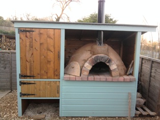

Well, at long last the clay oven has a house with smoker attached, a roof and chimney, thanks to the lovely sunny weather we have had over the last few days.
It has been made with recycled wood. We dismantled our childrens playhouse and next doors as they no longer has use of it and the wood was reused. Cost, again, has been minimal (as with the whole project). Roofing felt was the biggest cost. The colours are there because the playhouse was painted that way.
The smoker is on the left. It is a cold smoker (so just to flavour food) but it would be easy enough to convert to a hot smoker ( to cook and flavour food).

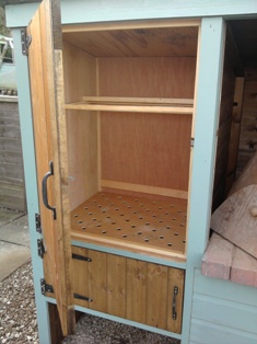

The small door below is the smoke chamber.
The doweling has held 2 sides of bacon during smoking - they just hung over the doweling. To smoke fish we put an baking rack (cooling rack) and laid the fish over the top.

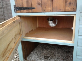

This is the smoke chamber. By the time the smoke has come through the pipe it has cooled down. It then gets dispersed through the holes in the main chamber floor.

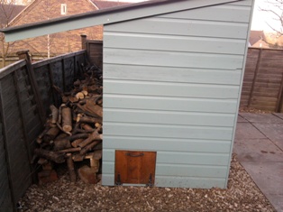

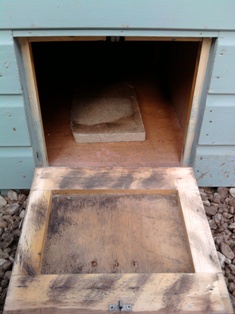

This is a side on view. The small door is the chamber where we put a metal tray with wood shavings and produce the smoke. The roof was made longer so we can have a small wood store for the wood that is used in the clay oven.
We have put a small piece of fire brick to sit the metal tray on (just in case!).
