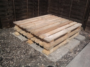

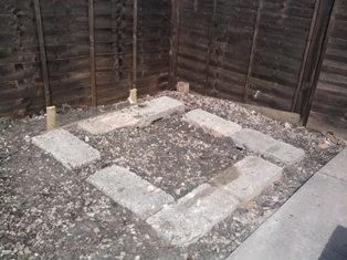

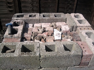

We laid foundations as the ground slopes down beyond the fence and this bit of ground had already started to slope.

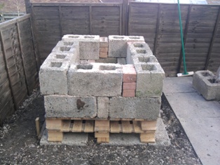

We used pallets as our base as we didn't have enough concrete blocks to give enough height.

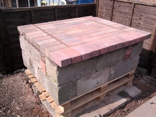

2 layers of concrete blocks.
We then filled in the middle with rubble (broken bricks etc)
And then finished off with sand (these were opened bags that we had so probably used the equivilent of 2 whole bags)

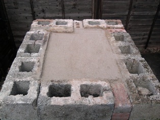

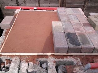

OH built a former to ensure we had level sand to lay the middle bricks on. This will be our fire/cooking base once the oven is built.
The edge bricks were cemented onto the concrete blocks, just for stability etc.
Here is the finished plinth.

Looks good. Only thing I would question is the use of the pallets. Have you treated them? My concern would be the wood rotting etc, I know after a while outside they tend to break up and you have a lot of weight on top there. If they do give way even a bit, the whole structure could be compromised.
Of course I could be talking complete tosh!!!! :D
Posts: 10368
Re: Outside Clay Oven
We have no clay anywhere near here or I would've tried this Sue. I would also have a wee bit of a niggle re the pallets but they might well be fine. Very neat and I would love a shot at bricklaying too, just to see what it's like :mrgreen:

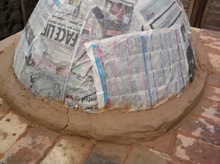

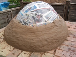

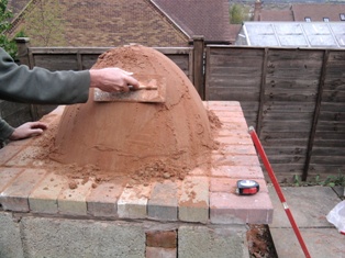

Well, 3 weeks on and we finally have a break in the weather so today we built the first layer of the clay oven.

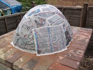

We started by building a mould of sand. We used 8 bags of sand to do this
Now this process is meant to be fairly 'organic' but OH likes to be very precise. The diameter of the sand dome is 80cm and 40cm high. All this sand will be scrapped out and used in the puddling of the rest of the clay.
We covered this in wet paper to help prevent the sand from sticking to the clay

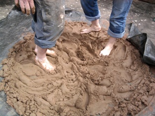

We then started to mix the clay we had dug from the garden with sand. The process is called puddling. The plan suggested 2 buckets of sand to 1 bucket of clay. To complete the first layer it suggested 6 buckets of sand to 3 buckets of clay.
Of course, puddling has to be done bare feet!!!! :D
Then to start building the first layer.
Half way......
Now as we get nearer to the top of the dome we realise that we are not going to have enough clay, so OH puddled some more. The first layer is done and scored ready for the next one. We have covered it and will allow 1 week to dry so fingers crossed next weekend will be dry enough to do the second layer.
We marked where the door will be.
Todays cost £24.00 (sand)
Overall cost so far £41.00

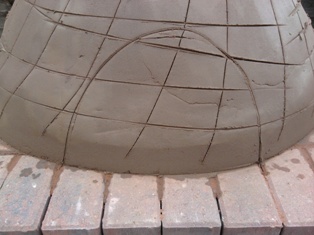

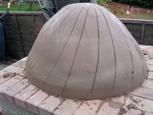

24 hours on from building the first layer and it's time to cut out the door.
The plan suggests after 4 hours but it was certainly not dry enough to do it then.
It has been uncovered all day, in the sun, and is drying well. There are a few cracks (anticipated) but we have just smoothed in some clay to close them up.
Looking good so far, no collapsing.
Fingers crossed we will be able to do the next layer next weekend.

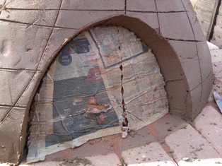

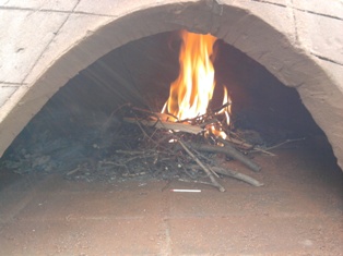

Today, with fear and trepidation, we removed all the sand from inside. Nothing collapsed . :D
A few fresh cracks but as this is only the first layer it's not too much of a concern.
I lit a fire inside to help the final drying. Although it produced a lot of smoke and we haven't yet built the chimney, the fire took well. I could soon feel the heat on the outside of the dome.
An hour later the outside of the oven was still hot, I could put my hand on it but not for too long.
