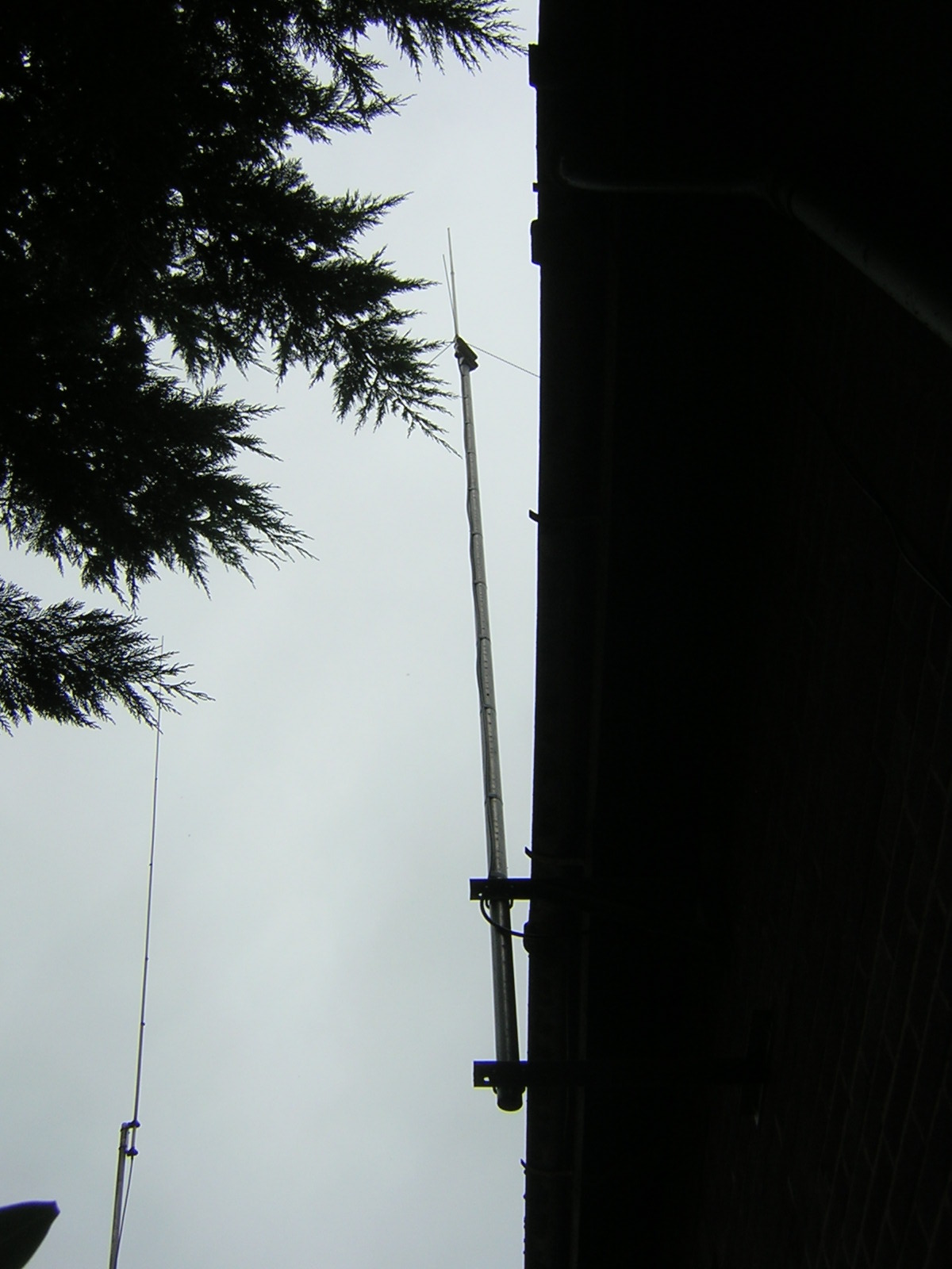

Re: Baofeng UV-5R
You really need to get the antenna as high as posible and into free air, like you i am only 76ft ASL, my antenna is on the side of the manor as my shack is in the east wing.filsgreen wrote:Thank you all for your invaluable advice, may I impose on you a little more? My station is going to be in a shed in the garden, it is only 25 feet from the house. I'm thinking of attaching a 15 foot post to the end of the shed and attaching an aerial to it. However, the aerial will still not be above the roof line of the houses around it, plus another house is less than 25 feet away from it. I live not far from a railway and the docks are only a mile further on, to make things worse we are only 10 metres above sea level. Even if I were to put the aerial on the gable end of my house, it would only be 10 metres above ground, am I flogging a dead horse? I've attached a photo so that my question makes more sense, just to be clear it is the shed on the left of the picture.
Phil
It is bolted on the side of the manor by a set of 24" T&K brackets to escape the roofline and then on a 20ft galv steel 2" pole.
