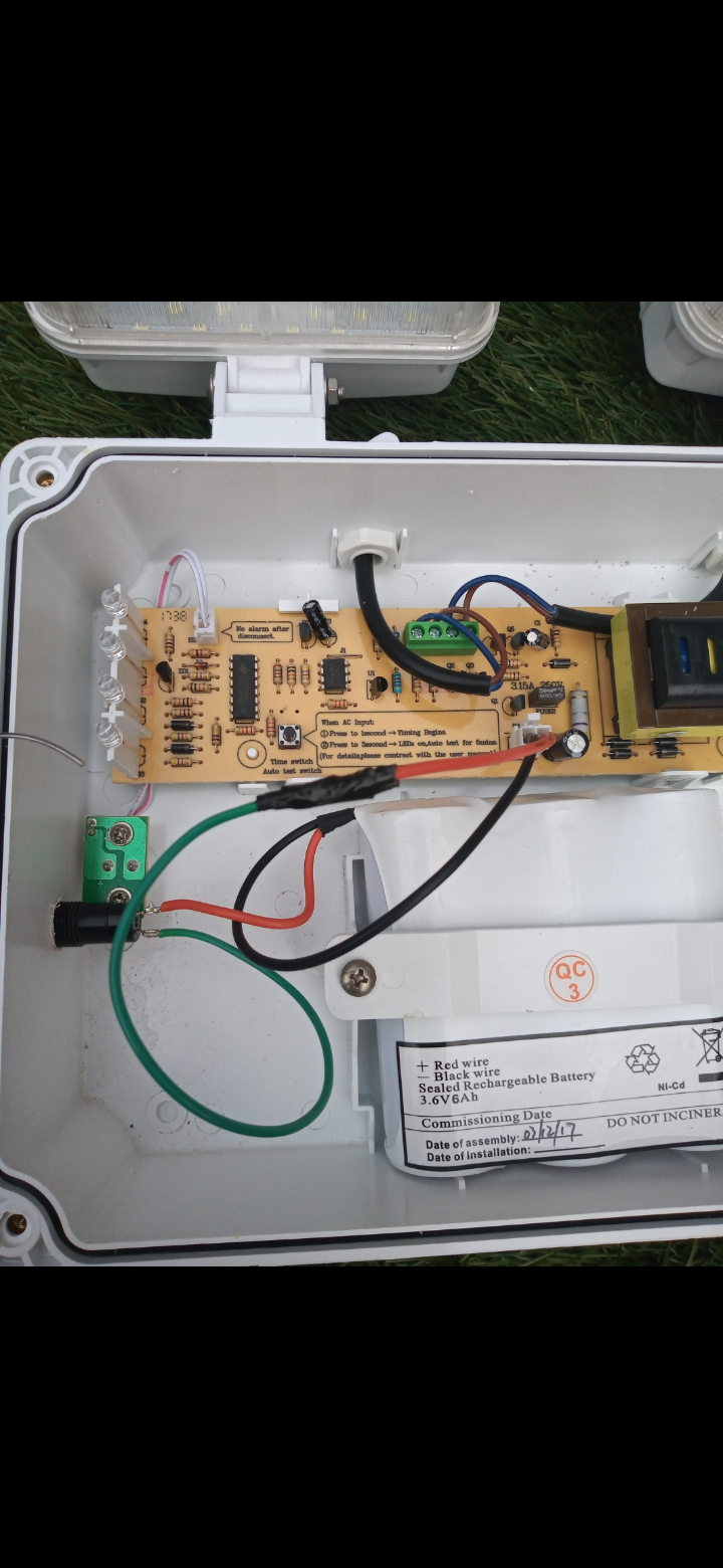

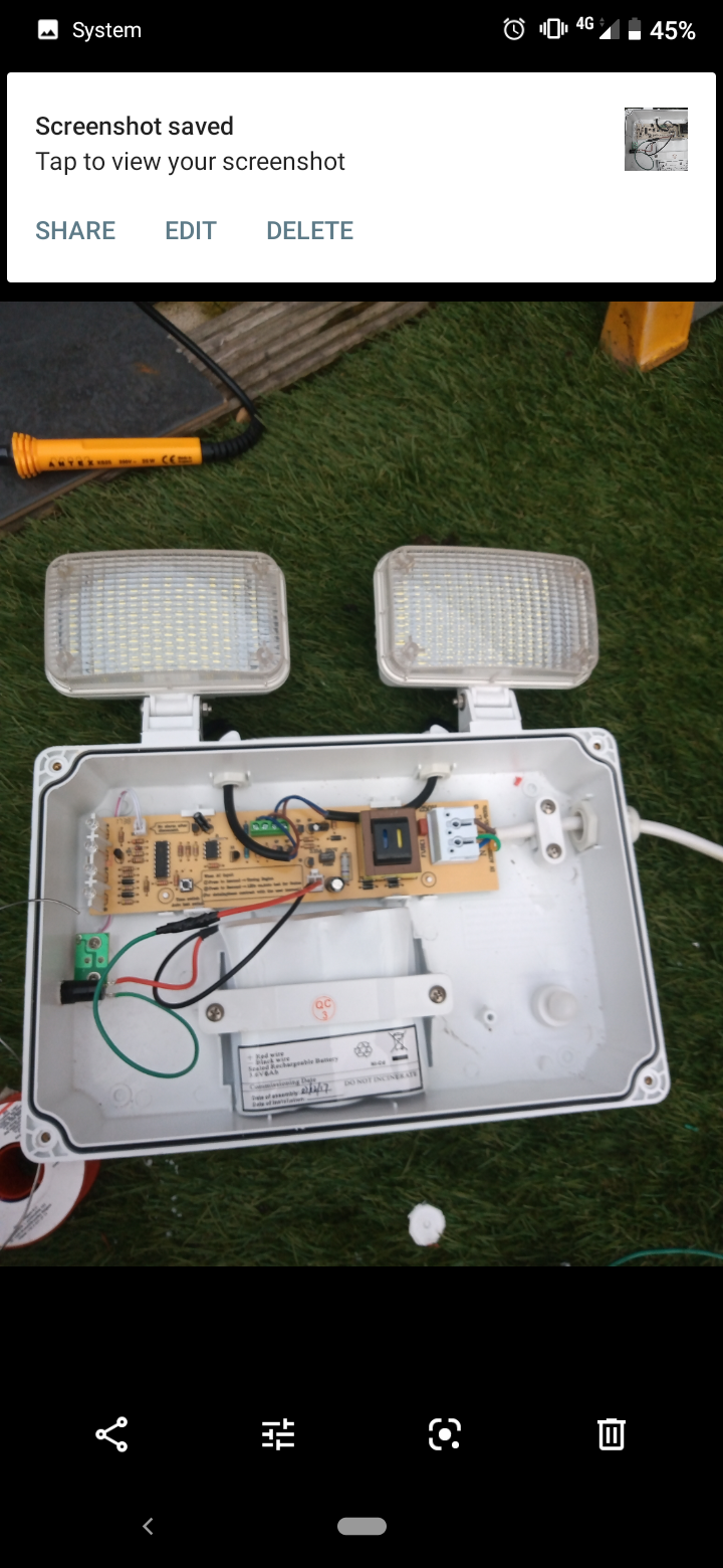

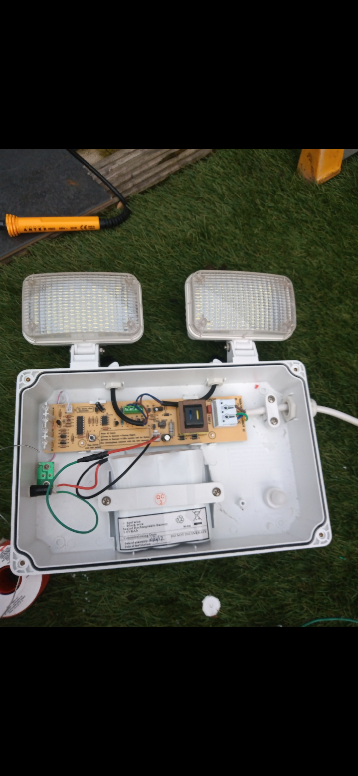

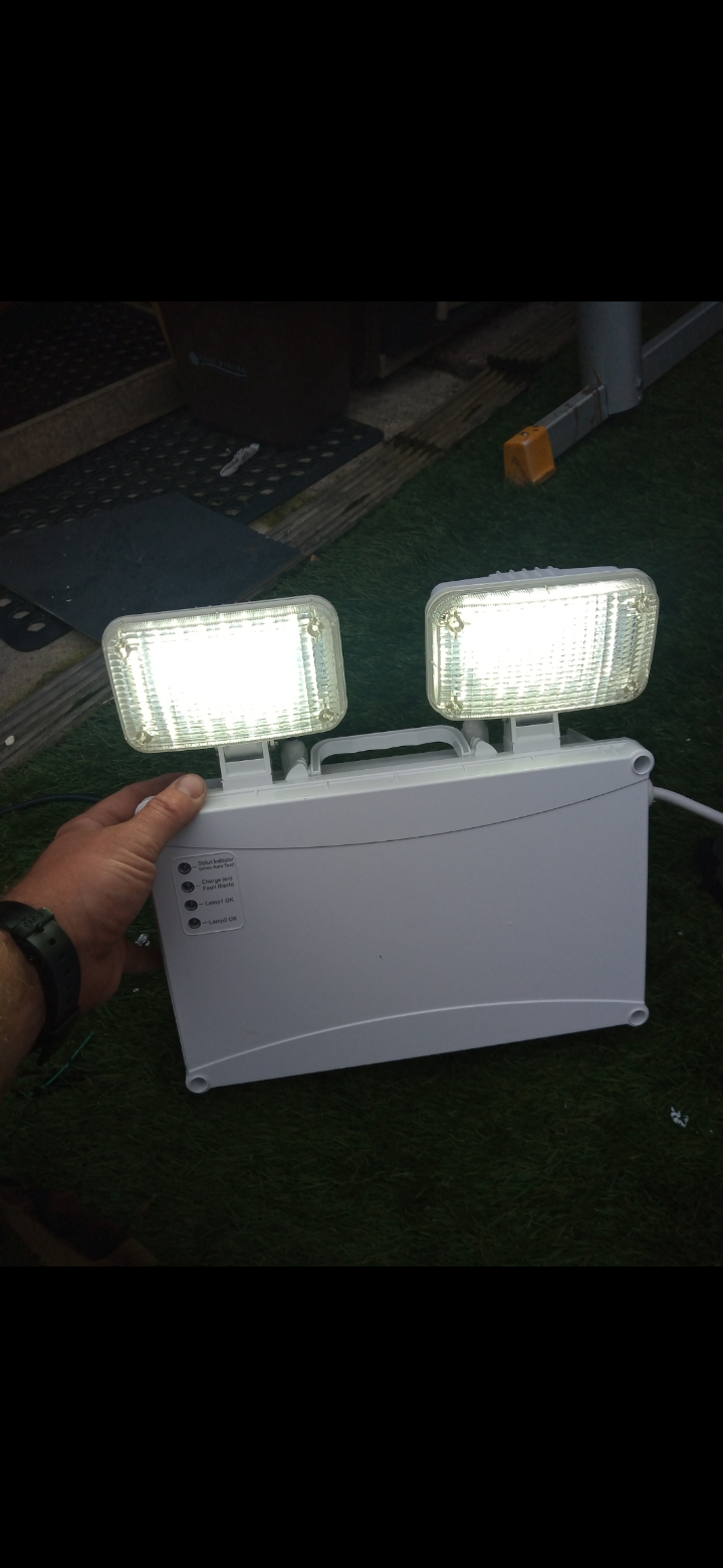

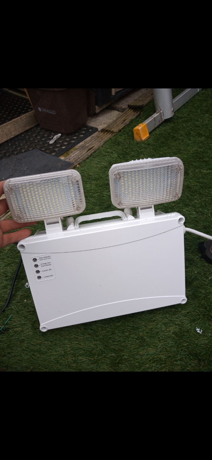

Got this for under a tenner off eBay.... 2x 3w led clusters these emergency lights are usually used in large areas eg sports halls / Wearhouse / stadiums to provide emergency lighting in the event of power failure
A switch added on the live battery wire.. added bonus with this unit if you leave the switch turned off and try to charge it it detects that the battery is not in circuit and beeps to tell you

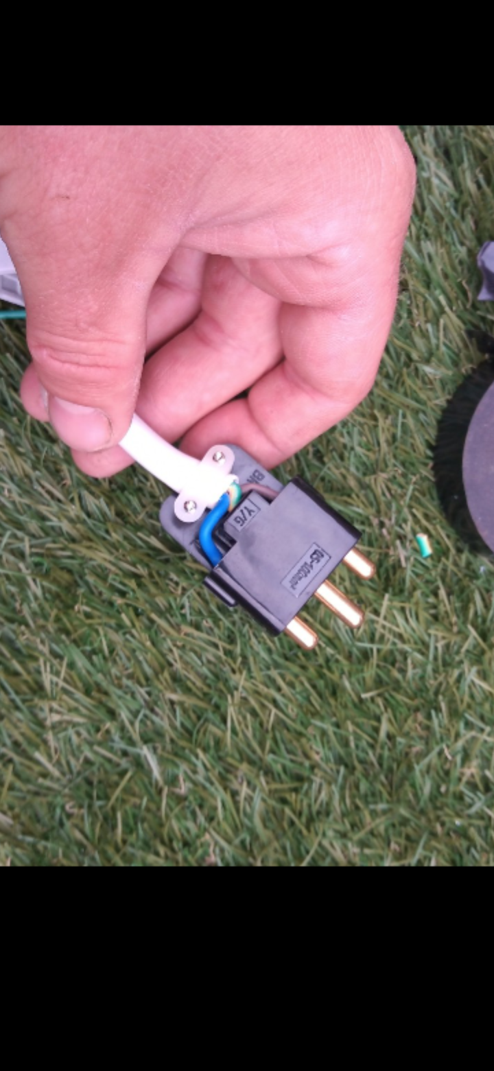

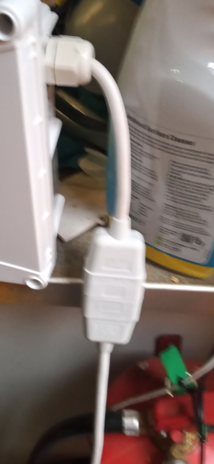

Put a short length of flex on the light and a 3 pin in line plug and socket so I can remove the flex and make it more portable ..
- Posts: 9072
Re: Emergency light modification...
Missed the inline plug
Pins go on the appliance holes go on the mains supply...
